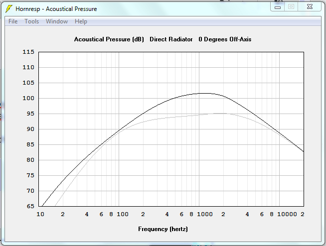

Hmm, if a matching impedance, then the somewhat oversized 8PE21 for the desired BW makes for an excellent ~ ideal size for a ~200-2150 Hz BW which will make the mids a bit more coherent, tonally balanced.
IB response Vs with 8 ohms matching impedance, both including on axis extended HF due to impedance rise:

IB response Vs with 8 ohms matching impedance, both including on axis extended HF due to impedance rise: View attachment 1029886
How is the "impedance matching" implemented?
