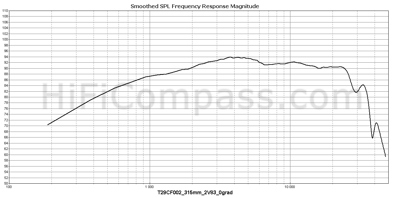

Seas Flagship Crescendo states 92db sens.
I bought a single off ebay and was actually not more than 82db sens, IF THAT.
So you measured it? Is it this one: SEAS Excel T29CF-002 (E0040) Crescendo Fabric Dome Tweeter

Regarding the Seas Crescendo tweeter, it is not a 'NEW flagship'. It was introduced in 2007, and has the Exotic T35, T29B001 beryllium dome and T29D001 / T29D002 diamond dome tweeters above it in their range. The short-lived magnesium dome Magnum was also somewhat above the Crescendo in the Seas range.
As for the 'extreme inefficient nature' -two independent measurements of Crescendo tweeters attached. The first is from Zaph, measured in 2007. The second is from HifiCompass, measured last year. Almost identical, give or take about 1/2 a decibel, and hovering around the claimed 92.5dB 1m/2.83v rating. However, the Crescendo has had, as I understand, some production QC / QA issues, so it is certainly not beyond the bounds of possibility that a bad one was received from the eBay seller. However, a more likely cause for the lack of output can be found fairly easily. Also attached is the FR of the Crescendo (I've not bothered simulating baffle effects as it doesn't matter for this case) with the 2.2uF series capacitor stated above (red line). In effect, 12dB down at 3KHz, 18dB down at 2KHz, and that's just by itself, and ignoring the potential for destructive interference in the HF, improper level matching / system design etc. which on current evidence is highly likely. 😉
Very good research, you have helped solved **The Crescendo low sens mystery ofa single driver**

No, you don't 'know that for a fact' or anything even approaching such. I simply noted that it was a possibility. It might be true. It might not. These things can happen from time to time, since no manufacturing process is flawless and errors do occasionally happen. It is a trifle excessive then to announce, based on pure speculation, that Seas is in 'decay', 'rot[ting', in 'breakdown' or 'meltdown.' Especially since you claim to have purchased a single example from a random eBay seller, not an officially recognised distributor or retailer, so you have zero knowledge of its provenance.
Equally, if you just chucked the thing into the system with a single 2.2uF capacitor, then its output will be rapidly falling off below 10KHz and around 18dB down by 2KHz, so by definition you wouldn't hear a whole lot of output from it. If you then compound that by poor system design causing destructive interference (i.e. losses) above 10KHz, which is quite on the cards, you wouldn't have much usable output up there either.

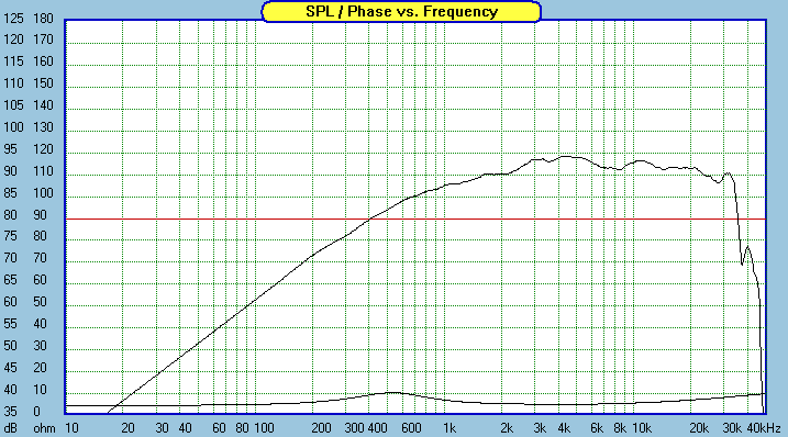

No passive crossover can add output, with the exception of very high Q bandpass circuits which are quite rare and of very limited use. However, if you start rolling the tweeter off at a very high frequency, by definition, you don't have much useful output below that.
As for a crossover design for your DavidLouis / MeloLouis / whatever-they-call-themselves-on-this-day-in-history drivers, as your 'tech' will tell you, you will need to measure the frequency and impedance responses (including phase) of all the drivers in the intended baffle, which can then be used to design the filter.

when using an amplifier with`"~constant voltage" characteristics,
a passive highpass network sometimes can be configured to add "gain"over a limited region by having a dip in input impedance.thus pulling more power
When using a transformer or autoformer *with a network. wideband gain can had the cost of a lower reflected impedance to the amplifier (and more power drawn) (^PWK used an aotoformer in a patent associated with hisLB6 speaker)
