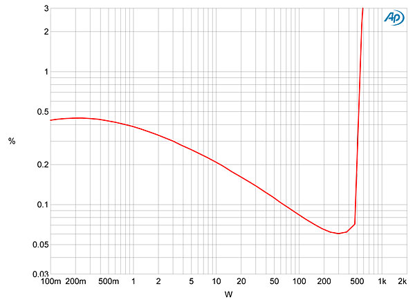

it would have to be at least 500ma to get 0.2% at a watt or less.
Well, it is not a first watt amp 🙂
8ohm 1kHz distortion of the original. Lower impedance behaviour is significantly worse. Still, pretty good for PA 😛
