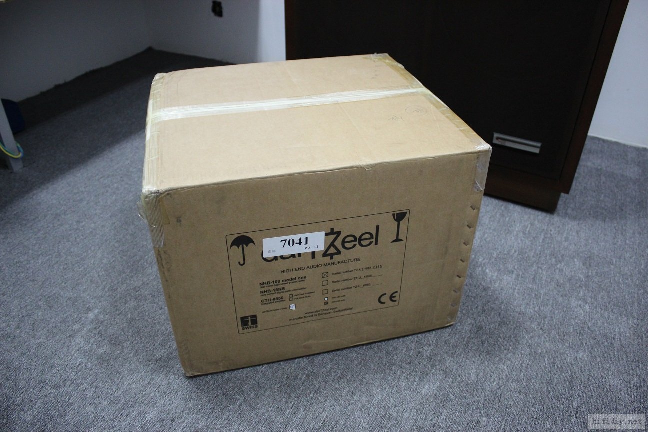

HERE is the original thread where the "prototype" NHB-108 was unboxed, somewhere in China. Below is a photo of the "prototype before the unboxing.
In post #7 on that thread somebody said "Do it as usual, dismantle it completely, then copy the board ~" and they did it. Awesome. That's a real "DIYers spirit", not simulation. 😀
Therefore this "single pair" Dartzeel NHB-108 isn't just a copy but a real 1:1 clone. All we have to do is to get a pair of bare boards, assemble it from good components, add a quality power-supply and make a decent chassis. This clone is not a poor-mans amplifier but has potential to be improoved clone in a decently designed chassis. To my taste, the original chassis is outright uggly. 😱

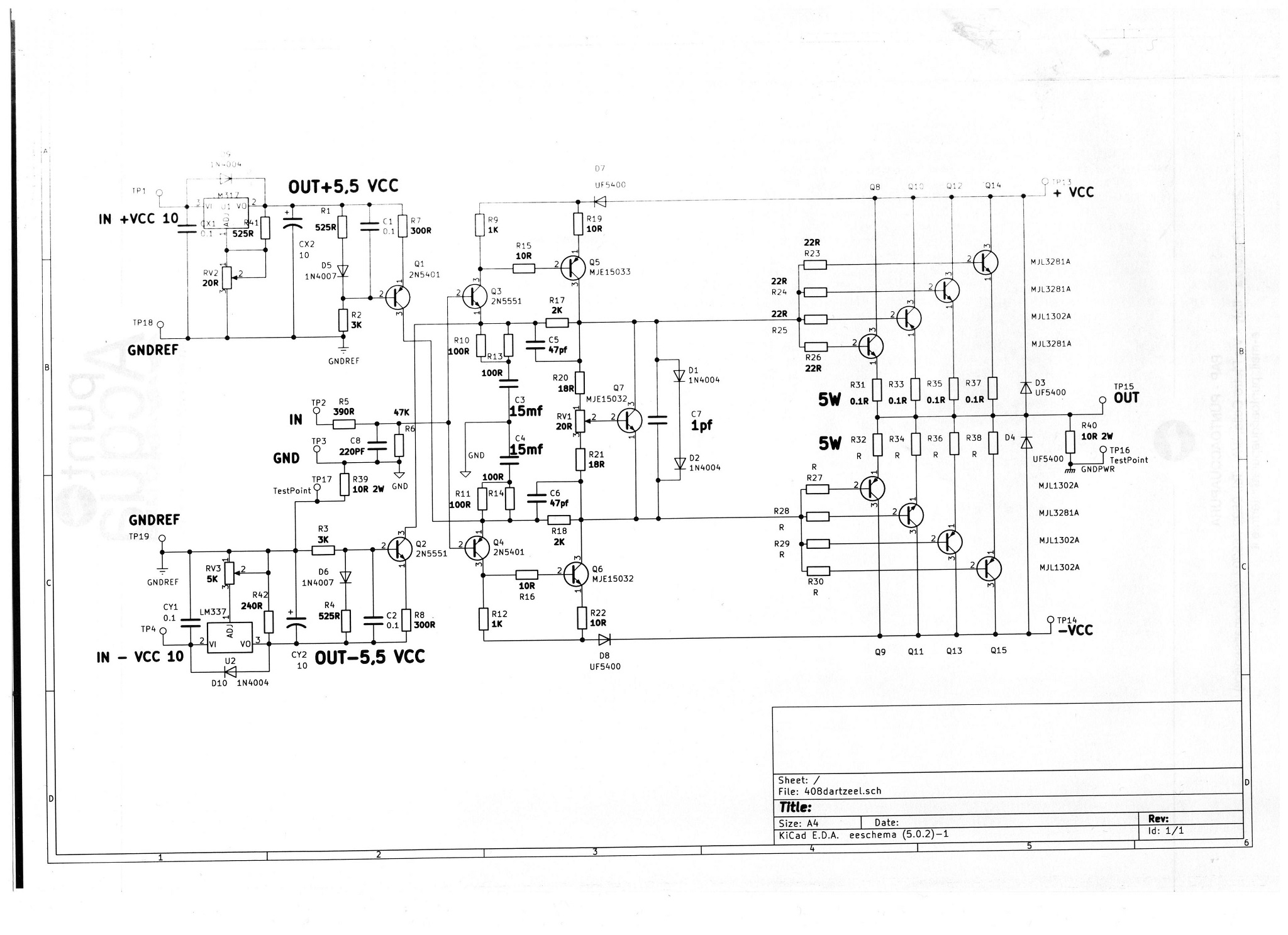

Did y'all see this Hungarian 458 schematic diagram? The last one in the Hungarian thread, but still no comments there.
At least it has got 2x4 output transistors, just like the 458.
Who is to say that this is not the real deal?
