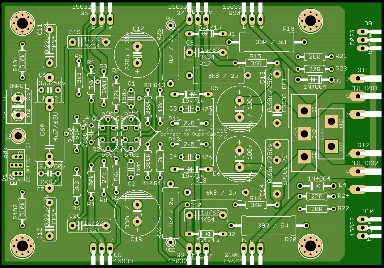

PS: In your post there is a link to the Weiliang NHB-108. There is also a photo of the board which I also have and I know it is good. That board has just one single capacitor between R13 and R14. That board is also good. The only difference from real clone is that extra capacitor.
Think before you buy. And don't t be naive to believe that QUEENSWAY version is a real stuff. They added a crap feature to it.
I must go to sleep now, but tomorrow I will upload a photo of both sides of the PCB so you may compare it to yours and QUENWAYs.

Did a PCB design for a friend a few months back, not that hard.
So did i. Unlike some people complaining about ch crooks but still buying their wares 🙂

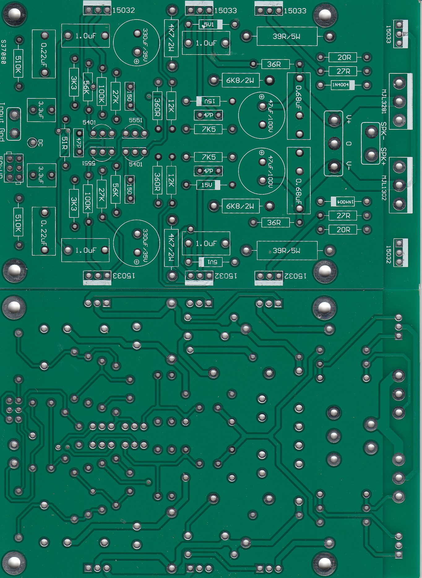

But, what I know for sure is that I have phisycally compared it to the bare board sold on ebay and is exactly the same as that board from Weiliang store, except some slight differences at holes for 2N5401 & 2N5551 transistors. The only "real" difference is that "extra" capacitor on Weiliang board bwtween R13 and R14, but the ebay board is identical to the published schematics. Also, all other boards do not have that "extra" feature.
Below is a photo of the ebay bare board.
As I said, I am not an expert in this field but I have lots of experience and I know how to judge situations and people based on scarse information. I know that the famous "1:1 clone" board is a bluff, an ordinary scam. Ask yourself: "Why the Hell would Chinese market that super board exclusively in Russia?" My answer is: they assume that the Russians are naive and ignorant enough to swallow that crap and afterwards be grateful for that exceptional "privilege". That's what I think.

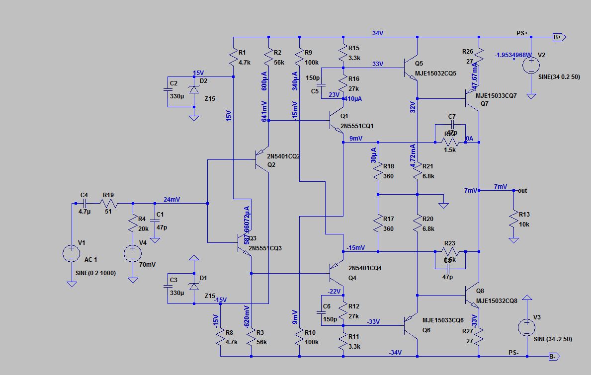

Just for giggles ran some simulations with the input circuit. A 75% mismatch in the model BF (beta) of the input transistors led to a thd change from 0.0005% to 0.0006%. 10v pk into 10k.
Below is the circuit which i incidentally like to use on its own as a preamp.
EDIT. Only now i notice the reduced gain of this circuit as it was meant for a line stage, but this does not change the conclusions
