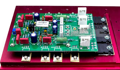

BUT how come this Chinese seller has two versions of the NHB-108, one with SCNP and one without? There is a picture of the SCNP on this version of the NHB 108:
Swiss NHB 108 Post Power Amplifier Copy One Without Negative Feedback Amplifier Circuit Kit 2 Tubes Parallel Output|Amplifier| - AliExpress
"10. SCNP midpoint stabilization module"
And I cannot understand how a regular capacitor can replace a component with three legs?
I am not sure if the ver A were retrofitted with capacitors. If yes, this would explain the use of supercaps: normal electrolytic caps would have been physically impossible to fit.
Yes, there is a version B that has a Supercapacitor, and, I think, two pairs of output transistors. Much like the Jay's Audio version from the Queensway store (on Aliexpress)

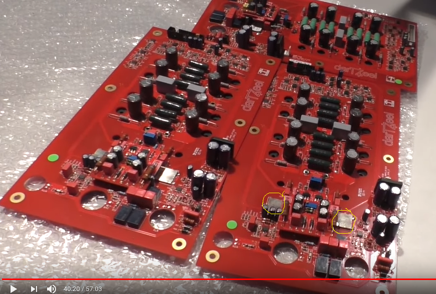

In any event it certainly looks as if the real 458 has two such metal gizmos. Why would they use them if they could be replaced with regular capacitors?
I am just trying to figure out if the schematic diagram is legit..
I have searched over and over again for Service Manuals for the 458 and for the 468, but have come up with nothing.

So how has the 458 circuit diagram surfaced? Reverse engineering? But even if you have high resolution photos of the frond and the back of a MB, how can you be shure it is not a multilayered card? Most computer MBs are multilayered, I believe. If I were Mr D. I certainly would try to hide/obfuscate some component connections on the latest model MBs to prevent reverse engineering considering the story with NHB-108.
Make no mistake, I very much hope shanes diagram is correct, of course!
I bought the Queensway version with two pairs. There is something very wrong with this. I will warn you do not buy it. There is almost no bias.
Which board with two pairs of output devices? All they have now is "finished board" with a single pair. I have purchased bare boards of the same configuration elsewhere and my amplifier works very well indeed. I have used components from reliable source. What went so terribly wrong?
