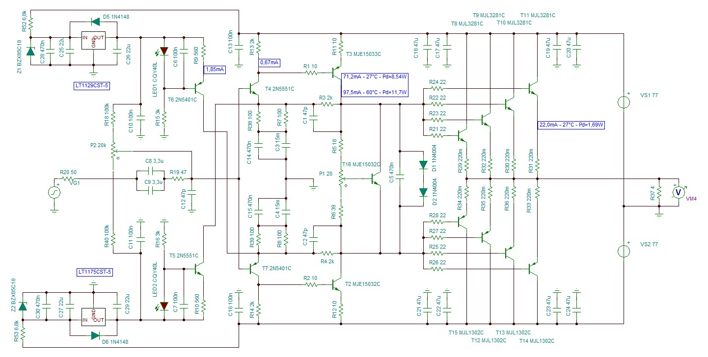

I am still not convinced that Shany’s version is "copied down" from a real 458 unit 😀There are many, lately with a cascode. The version that appears to follow the 458 is in post #584
If you are referring to the Shany's schematic, I do not see how 458 has more nfb and/or more olg compared to 108. I cannot see how it can properly drive four pairs of output transistors and difficult load with its flimsy frontend.The 458 has more power, better ability to drive difficult loads, less distortion due to more nfb. If you have easy speakers some of these might not be important. It is a very different amplifier and a much more demanding build.
But it is just me wondering, based on a LTSpice simulation. I have never tried the alleged 485 schematic in the real world 😎

This circuit is designed to produce mid level distortion. You should look at it from another aspect. E.g. it is a tube amplifier which has high output power and speaker driving capability.... I cannot see how it can properly drive four pairs of output transistors and difficult load with its flimsy frontend.

In my opinion this is the key development of this thread: now, we have the scheme.

In my humble opinion, the present scheme is based on a serious, in-depth analysis. This is a great opportunity for the »wizards« among us.😉
This situation resembles a simmilar event on another thread where a member "bra" from Poland came along with a scheme and that was the starting point of probably the most fruitful thread here: "Krell KSA 50 pcb"
Can we build this? 😕

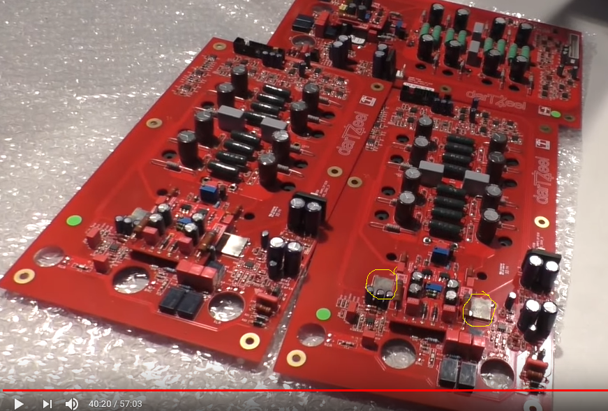

Hello,
I have followed you on the Hungarian forum, thanks to Google translate. I am very impressed by your knowledge and I cannot wait for more information on the project.
I just have one question regarding the circuit diagram:
In the YouTube factory tour by M. Fremmer at YouTube Mr D. shows off old 458 MBs at around 39.09 and onwards. There you can see two metal components sticking out from underneath the daughter card at the bottom of the MB (circled in yellow).
What could those be?
Ehm, someone known for dramatic statements followed by protracted absences confirmed this earlier on in this thread. He had a look inside his buddies 458 and everything was exactly the same. Allegedly 🙂 But i choose to believe it.
And you are quite right, my bad with the sims, did not load them equally. Now the 108 has an olg of 85000 and the 458 only 20000. Do you get figures in the same range?
As for maximum power I get 2.28% thd at 1kW/2ohm whereas the Stereophile test measured 1%.
Overall, not too shabby for Shany's circuit 🙂

Very tempted to replace the input stage CCS with a single IXTU01N100D. Why? Because it is the best sounding simple CCS solution i know of and because it is even objectively better than the bipolar CCS in the 458. Besides, together with a pot it can be used to adjust the offset. Yes, it will no longer be a "genuine" copy 😀
Thoughts?
