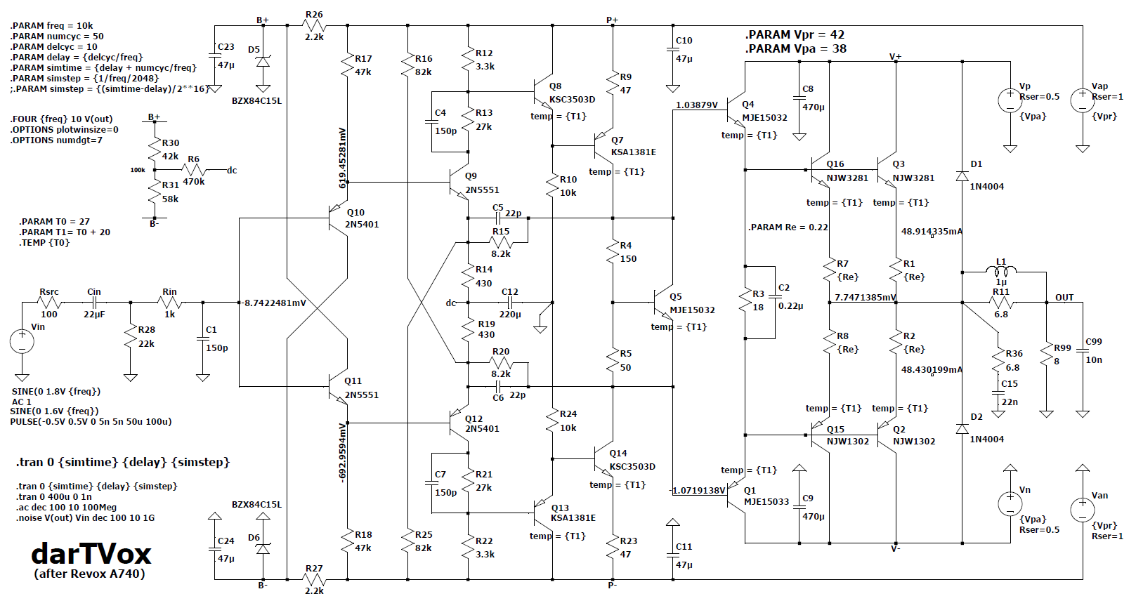

Dartzeel amp schematic - build this?
NHB-108 clone board is 1:1 and it sounds just fine for me. With original components this could be an amplifier to have. 😎:hphones:
Yes, the original is well documented and easy to reproduce. The original components are nothing to write home about and can very easily be improved upon. Whether it is "an amplifier to have" depends on your speakers. It fails dismally into lower loads, which explains why the second series of the 108 has parallel transistors.
Some time ago analog_sa tipped me off that, in fact, darTZeel's "patented" voltage amplification stage is almost an exact copy of Revox A740 🙄
It turned out old Revox amp had three pairs of output transistors and the pre-amplification part was powered by separate stabilized power supply. Guess what? The A740's service manual even shows a SCR crowbar protection circuit 😀
So, instead of chasing ghosts in the "Hungarian schematic" I am more inclined to try the "source", but using Hervé's idea to take the feedback from the VAS instead of the output.
This is what I got (copied) so far in the simulator. I do not need more than 50W at 8ohms, hence the lower power supply voltages. Some resistor values can be easily tweaked to keep the circuit operating point the same.

One thing is certain - one can see a lot more transistors than there are in the "Hungarian" version.

It depends on which version you are looking at. Shany's physical implementation appears to be using 8 transistors per rail.
I have no need for a kilowatt as well but do need 2ohm operation. Will see what the simulator thinks of 4 transistors per rail of 60v.
And yes, it will definitely be the based on the early, pre-cascoded Hungarian version with huge thanks to Shany for making it public. The open loop gain of the VAS is about 1.5 times higher than the Dartz 108 with a correspondingly lower THD and a much prettier spectrum.
I am not counting the power transistors. By “Hungarian” version I mean the one that could be seen at the screen in one of the previous videos from Dartzeel’s factory visit. I have my doubts it is genuine. Which one is the Shany’s version?
