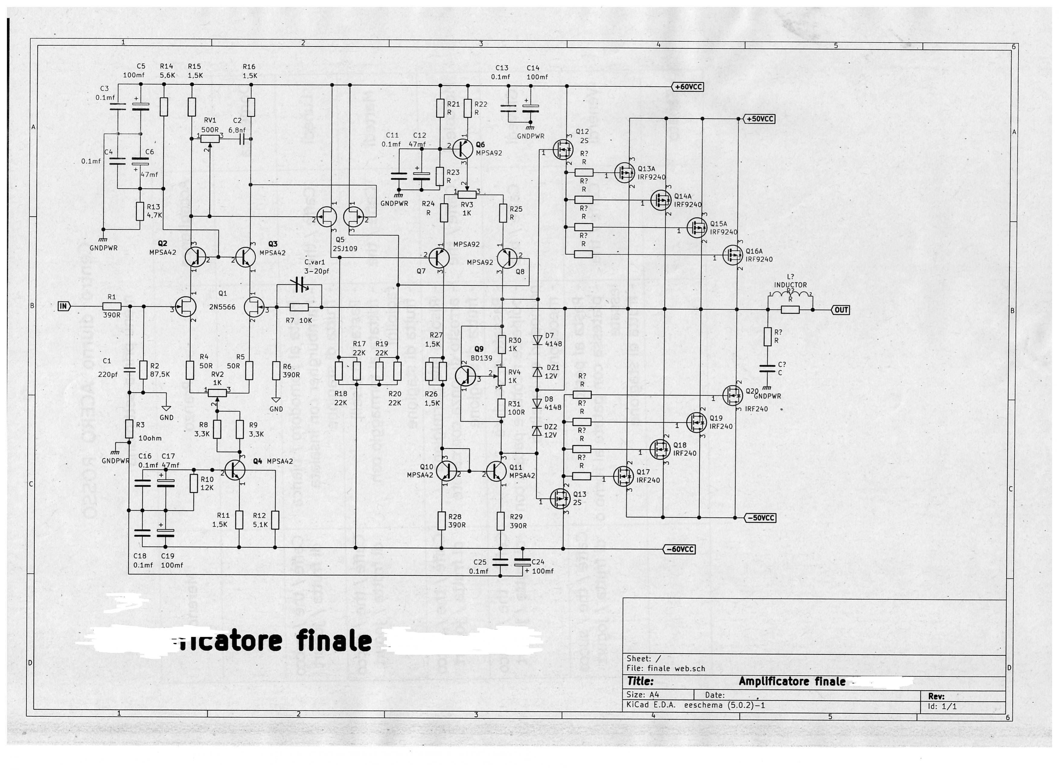

I think that a scheme, speaking not of elementary and closed NAIM-like schemes, already says a lot:
- an open loop scheme already lets you think how it can sound, with its pros and cons, I mean, not in detail.
The scheme of 108, I repeat, but in my humble opinion, has many limits, perhaps too many.
The scheme of the 458 that I posted, however, gives hope that some limits of 108 can be overcome.
The supercap remains, which is on the signal, but something you can do, I think, with an excellent bypass.
I add :
if I stabilize EVERYTHING, we still improve and save those expensive cans that are often unhealthy
This scheme offers excellent results, but these results can vary greatly depending on how the PCB is made, on the power supply and its positioning and also on some resistances (not complete scheme!!)
Hardly this scheme, although not in a definitive form, but I could also post it, few details change, but ............., nothing secret! , will never have the fascinating performances of medium and mid high of 108, for clear reasons, it can be more precise and concise, but it lacks charm.
However low, medium low, speed, dynamics and articulation of the low and medium low are of great level

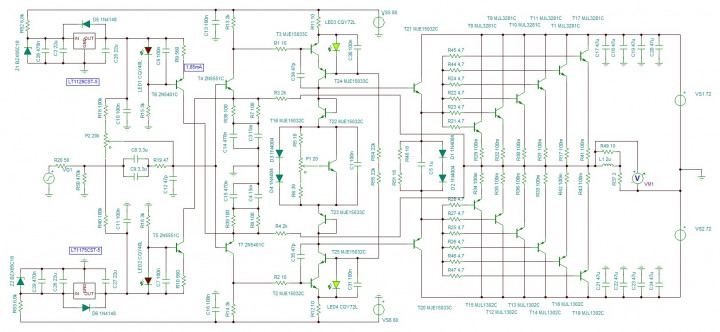

domenico, apparently this schematic has nothing to do with darTZeel: different topology (no cfb), input is FET diff pair, NFB from the output...
INDEED.
One with a high feedback, the second (108/458) with an open ring.
This is to say that, in my opinion, the typology of a scheme already says many things about how it can sound, not everything, but a lot.
THEN the refinement work on certain technical parameters that I consider fundamental.
Clear that to insist, EXAMPLE, with a NAIM type scheme, well, you can't do much, quite the contrary.
The high feedback scheme, PLEASE NOTE, has no compensation and no capacitor on the signal and no limitations, therefore, it should be limited and fairly faithful

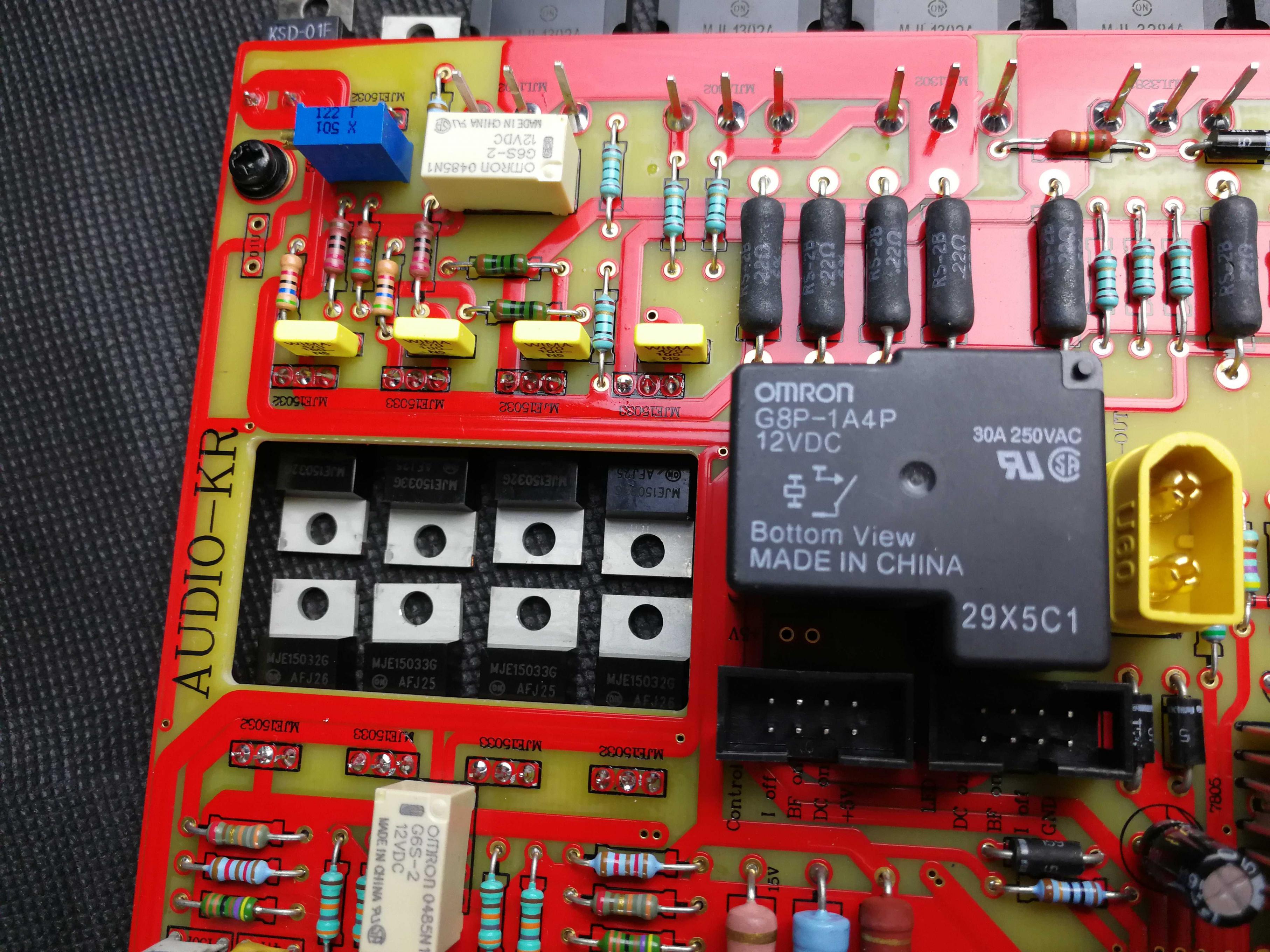

It would be really, really nice if you can share a couple of the multiple pictures you have no doubt taken 🙂 Or at least one of the component side.
Read the above post of our friend analog_sa again.
I am reposting this because this is the essence: reliable, first hand data as the basis for the future work. In KSA-50 thread there was a member "bra" who contributed the schematic, then everything went well. So please, as much photos, schematics, reverse engineering as possible.

The two circuits are identical despite our friend's Domenico insistence they are not 😀
Whether there is an input coupling cap or an offset nulling circuit is immaterial, as these require just a couple of extra pads.
Domenico's interpretation assumes there is second lower voltage PS with the only function to feed the CCS, which even to me appears wasteful beyond belief. If that particular part of the circuit requires improving, a cascoded ccs would be a much more sensible solution. Perhaps Domenico can throw some light on his reasoning here. Highly unlikely the genuine article has any such niceties.
Domenico's other suggestion - to power the entire front end (VAS) from an independent, regulated supply makes a lot more sense. Again, i find it unlikely the original provides for this but it is only a question of two jumpers on the board to allow for an additional front end PS.
So, it appears the Hungarian fantasy is more than a fantasy and someone has already peeked under the bonnet 🙂
I am certainly surprised that this circuit is simpler than the 108 and may well represent the simplest amp of such power ever.

The volume discount is a killer. You buy 15 and you save $1.80. That's one tough seller.
This appears to be a bridge amp, so no matter where it started it got extensively redesigned.
I have noticed this trend in China: they add "features" to clones: power supplies on the same board, speaker protection etc. Who knows why, perhaps to prevent legal issues. But, as far as I understand, NHB-108 clone board is 1:1 and it sounds just fine for me. With original components this could be an amplifier to have. 😎:hphones:
