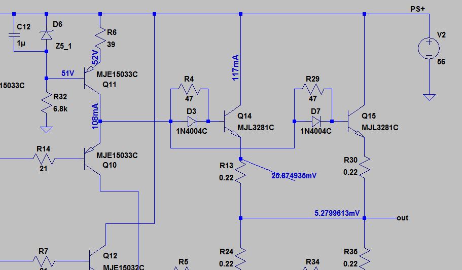

5.7 v IT came with 0.05 ohm resistors and seemed to oscillate ( multimeter only)
This is beginning to look very mysterious. So you have 5.7v/39R = 146mA through the drivers but only 9mA through the outputs? Impossible with the original resistor values. Please confirm the values of the base resistors for both drivers and outputs.
This is not the reason for the low bias but you should replace the output emitter resistors with the original 0.05ohm. These cannot be causing oscillations.
Is it possible to take a picture of the component side with sufficient resolution to read the resistor values?
Drivers base 21 ohm. Output base 47 ohm. Just measured them. I thought I had oscillating because of very running DC. So maybe no oscillating. Only confusing because of very very unstable DC.
There is some kind of issue with your board. Here is a sim with your current resistor values. The change from 27 to 47ohm does indeed reduce the current but not to the severe extent you observe. The voltage drop across the emitter resistors should be around 26mV
Very strange I got some support from another guy on this forum, to change some resistors and it did not work at all. I will be back later. Now it is 2.22 AM I Copenhagen. Maybe I will change to 0.05 resistors later this day.
