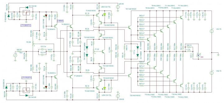

Dartzeel amp schematic - build this?

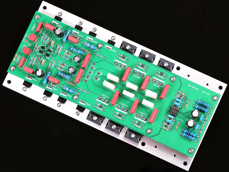

Someone here asked if it is possible to purchase a board with 3 output pairs. Here it is, with additional feature: a circuit for midpoint automatic adjustment is added too. A single channel bare board costs about €15.
Dartzeel board at China Voice Store

that servo circuit for controlling the offset is a real hit.
I having greatly modified the original scheme bringing the final power section from 1 to 4 pairs, now, I think that the least worst of that scheme, except distorting it, is to go back to one pair, work on the input cap, on the supercap and on the power supplies
if you really want that pattern

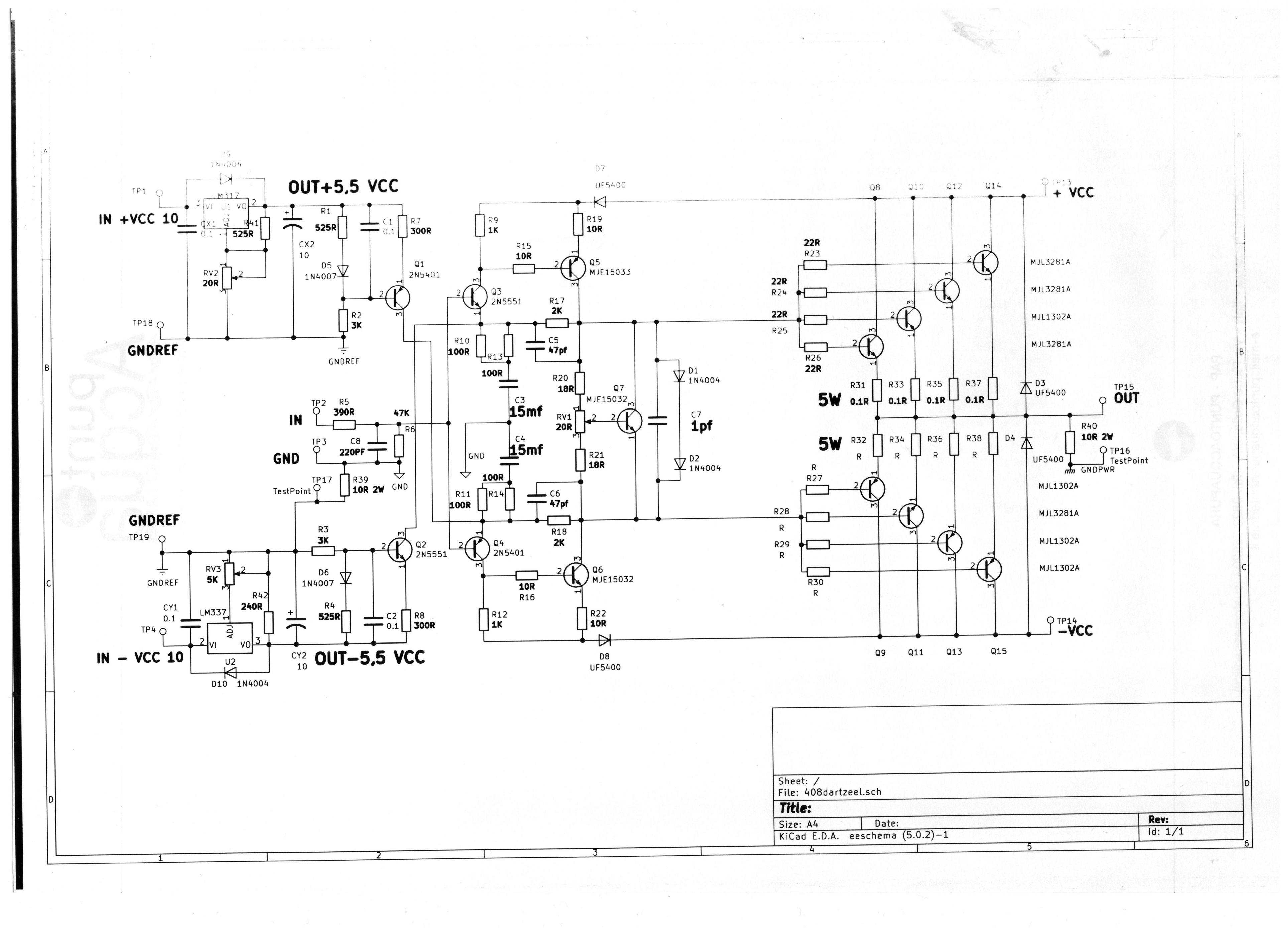

otherwise we work much better with the diagram of the 458 with which they eliminated some problems of the electrical diagram 108

I think the 108 is a scheme with some technical problems, input cap, adjustment, super cap that was added later and with a little bit of pressure. I do not understand all that power and those super transformers if it does not go down and if even with 2 caps per dog instead of 6 changes nothing.
It has some good prerogatives, good sound of high, medium high and medium, poor on low and medium low and dynamic in general: but it is clear, even without listening to it, it is an open ring
If you want to work with the scheme 108 I think it is better to buy the Chinese card with a single pair, better disassembled and carefully select the input transistors and put them in close contact, which Chinese cards do not do.
I think the two 3.3 micro input caps are bad.
I think the super cap should be bypassed.
All those filter caps are not needed, they only serve to try to justify the crazy price of 108.
We have done this or these interventions.
I do not recommend the 4 couples due to careful selection of the finals.
I recommend a completely stabilized power supply, it costs less than the filter caps and works much better.
If you want, I can give you a schematic and gerber of the printout
