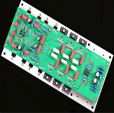

Building a clone of an expensive amplifier isn’t cheap at all, but it isn’t really expensive either. It just costs. Board and electronic components are just an initial cost, if you want to do it properly, otherwise you can end-up with an useless result and that’s what we don’t want.
I run a NHB-108 clone on about 56,5 V, using 500 VAC 40-0-40 thoroids and use 0,3 C/W heat sinks with external dimensions 200mmX300mmX40mm.
There is a certain amount of money you will have to spend on building of the chassis, and this will cost you a lot of time. Doing this should be pleasure, not the money or savings, otherwise it isn’t worth it. Life itself costs but it can be pleasure.
I have tested my clone at different voltages: 24V, 42V and 56,5V. The higher the voltage, the better sound quality. At 56,5 V heat sink was very warm, should I say about 50°C, I was able to touch the output transistors for a couple of seconds, not longer, but there was no sensation of burning. I was able to comfortably run the amplifier for hours, at constant, steady state I didn’t bother measuring temperature but intend to buy an IR thermometer to be sure my amplifier is running safely.
Heat sinks cost 43 EUR each, thoroids cost 60 EUR each, prices without VAT. Ad to this 10 or 20 for packaging and transportation. All together, this cocts 226 EUR +VAT.

I already purchased three! 500VA 2x42V toroidal transformers from a guy on ebay thinking I made a good deal.. I cannot return those. Are you saying I cannot use those?
I Think I read somewhere you can lower the current at higher voltages for less heat? What exactly happens when you lower the current? Will it run in class A to a lower output power and after that point run in class A/B, or what will happen?

I was looking for the smallest possible design that will do the work of transferring the heat for many reasons, not just cost. The smaller the cooler 🙂
You mentioned a figure, 0.3, thanks!
The problem is that few, if any, suppliers give a number on the heat transfer efficiency of different chassis designs, that is why I am asking

No problem with your transformers provided you have ample heatsinking. The two output pairs should also resolve worries about 4ohm operation.
Where did you get your heatsinks?
I purchase from Reichelt, Germany. This the the link to the heat sink.

Don't forget, you will have to fix your transistors to the heat sink with M3X10 screws and you have to make threaded boreholes on that heat sink. To do that you will need a 3mm drill bit and a set of screw taps (Ger.: Gewindebohrer) in accordance to the DIN 352. Making threads into aluminium can be a bit tricky because ordinarry screw taps easily get stuck in aluminium and then breaks. With DIN 352 taps you do that in three consecutive steps. Look here: YouTube.I am planning to get 80V capacitors and also a Soft Start circuit with a 75 Centigrade cutoff:

You can find a set of DIN 352 taps anywhere, in a store like Wallmart.
Also, you will need mica tags and thermal paste to do this task properly. And do this carefully because thermal characteristics of your amplifier will depend on this.

Heatsink/amplifier subassembly
I was thinking of using 8 or 10mm thick aluminium bars, approx. 150 by 80 mm to do the 3 mm threads and then attach the amplifier/power transistors to the aluminium bar using the 3 mm screws and then attach the whole aluminum bars/amplifier subassembly with screws/nuts going through the large heatsinks of the chassis, using heatsink paste . That way I will not risk "ruining" the large heatsink and I can reuse the heatsinks/case should I not like this particular amp.
Use a large aluminium bar in a fashion similar to the one this card is attached to:
If you need to tap for 3mm you should drill with 2.5mm.
