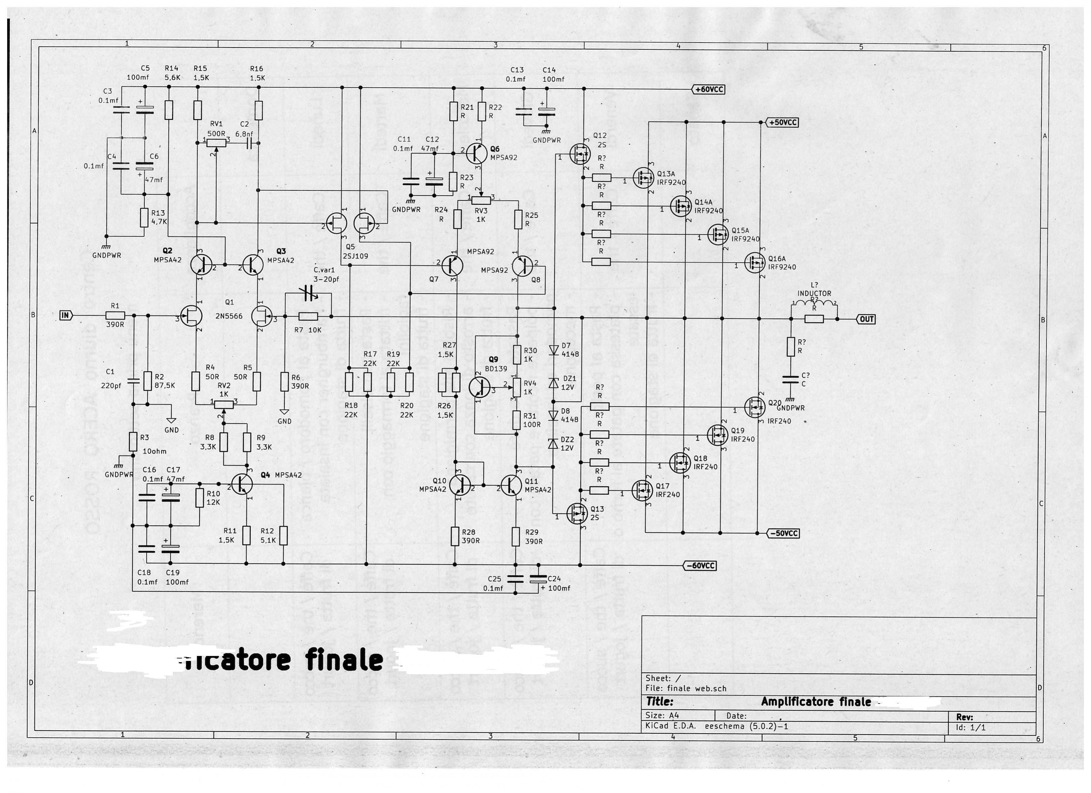

Dartzeel amp schematic - build this?

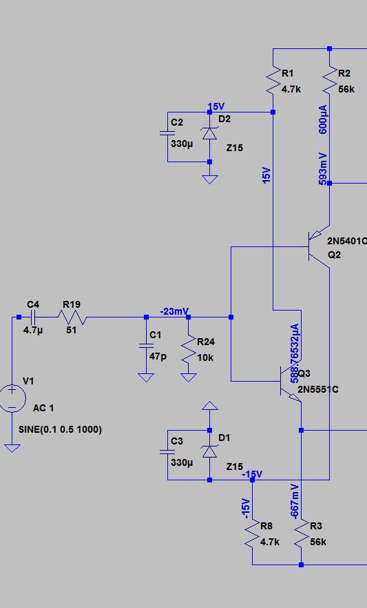

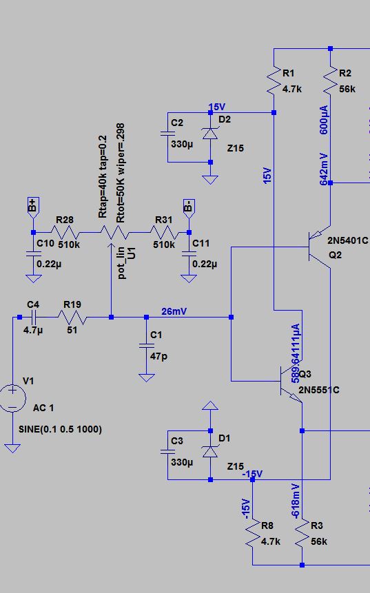

For those who dislike servos or caps in the nfb decoupling, there is a less painful option to constantly adjusting the offset. It reduces the input impedance which may be an issue with anemic valve preamps. 10k works for me and without a lot of transistor matching i get a rock solid 30mV offset. Significantly better is possible with proper matching.

the circuit is undoubtedly critical and its criticality may impose important compromises.
It is difficult to understand today to use a circuit with offset problems if not using condensers and extreme adjustments
in the end you hear the capacitors equalizing by brand and model
For those who dislike servos or caps in the nfb decoupling, there is a less painful option [...]
Well, we have to pick our poison, don't we. Servos, coupling caps, NFB caps, low input impedance... Today I finally tried some Mundorf Supremes as coupling caps. Before that I was with DC connection to a 50K DACT and the output offset was terribly floating. Soundwise - not bad at all after allowing for some burn-in time for the Supremes.
To me a 10k input impedance and moderately priced coupling caps start to seem like a viable option.

If instead we want to talk about something different place a basic scheme .........
this is an extreme scheme, tout DC, no servo circuit, no high pass capacitors, no compensations, IN a dualfet, Emitter etc etc.
The scheme is old and is now even more extreme, if anyone wants to go deeper and it is the usual Hitachi book revised and corrected, such as Spectral Goldmund and Norma.
With floating power supply it has 116 db noise.
If I do a stabilizer EVEN of the power amplifiers I arrive at 123 db.
If I put the external transformers in a faraday cage I will reach 129 db.
If I try to listen to what I first heard, I speak of volume, a silly example, but to understand each other, before I went to 12 o'clock, if I stabilize everything I can go quietly at 14 o'clock without any sign of annoyance or compression or distortion.
The bass appears less present, but it is only a sensation: it is very deep, but very controlled.
The scene seems to go beyond the side walls of the room and the dynamic of low and medium low is better.
The grain is very fine
the pattern, I repeat, has still been revised and extreme, if anyone is interested and interested in my impressions of the various changes, I can post them, like the dualfet emitter
