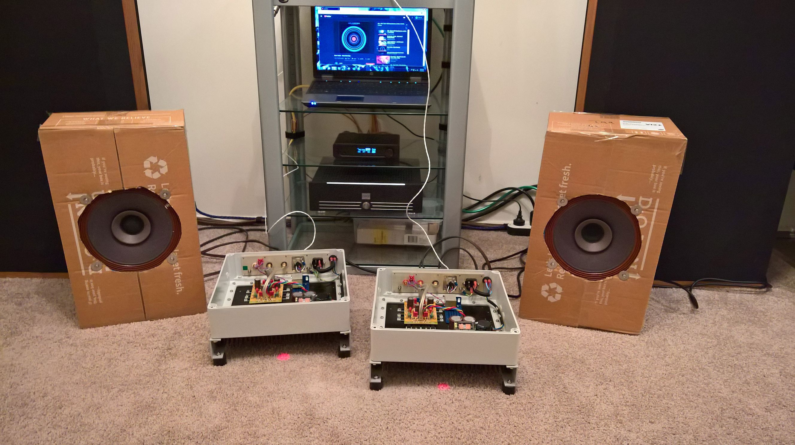

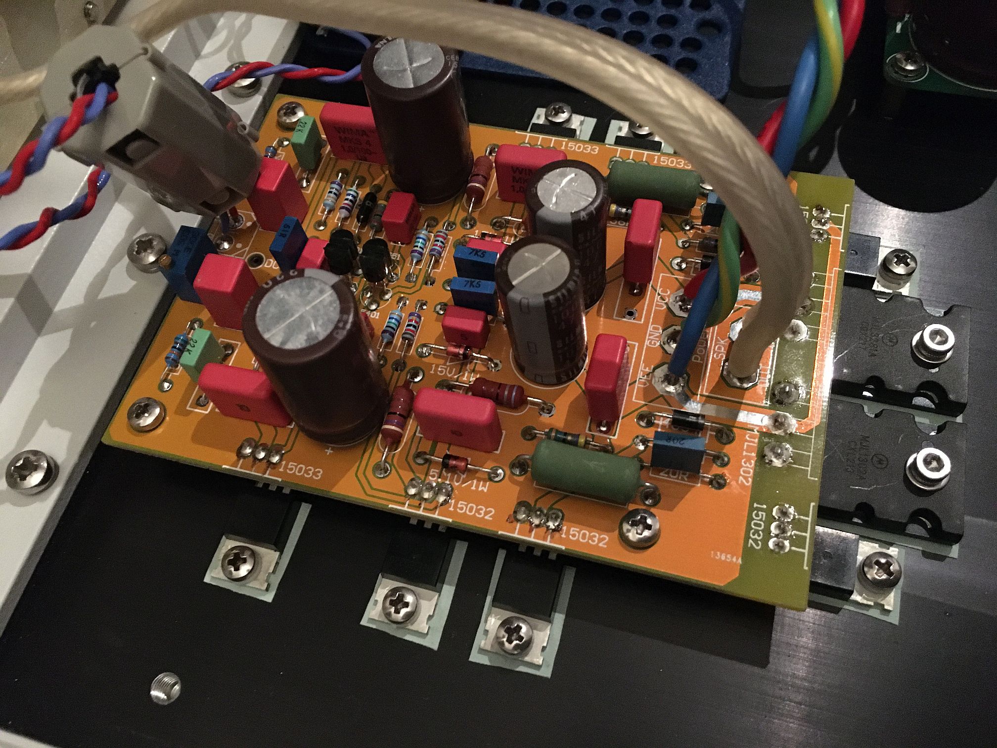

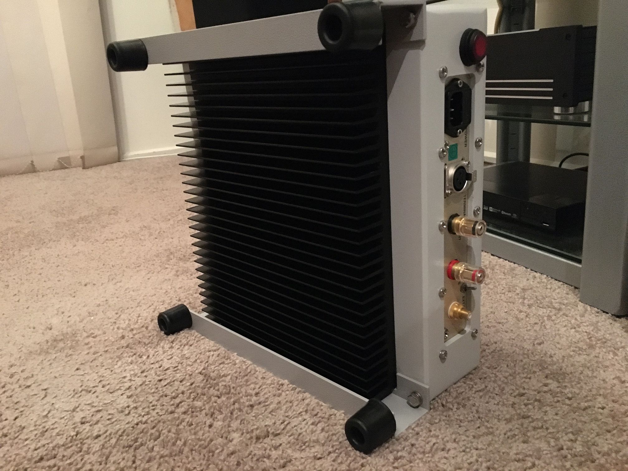

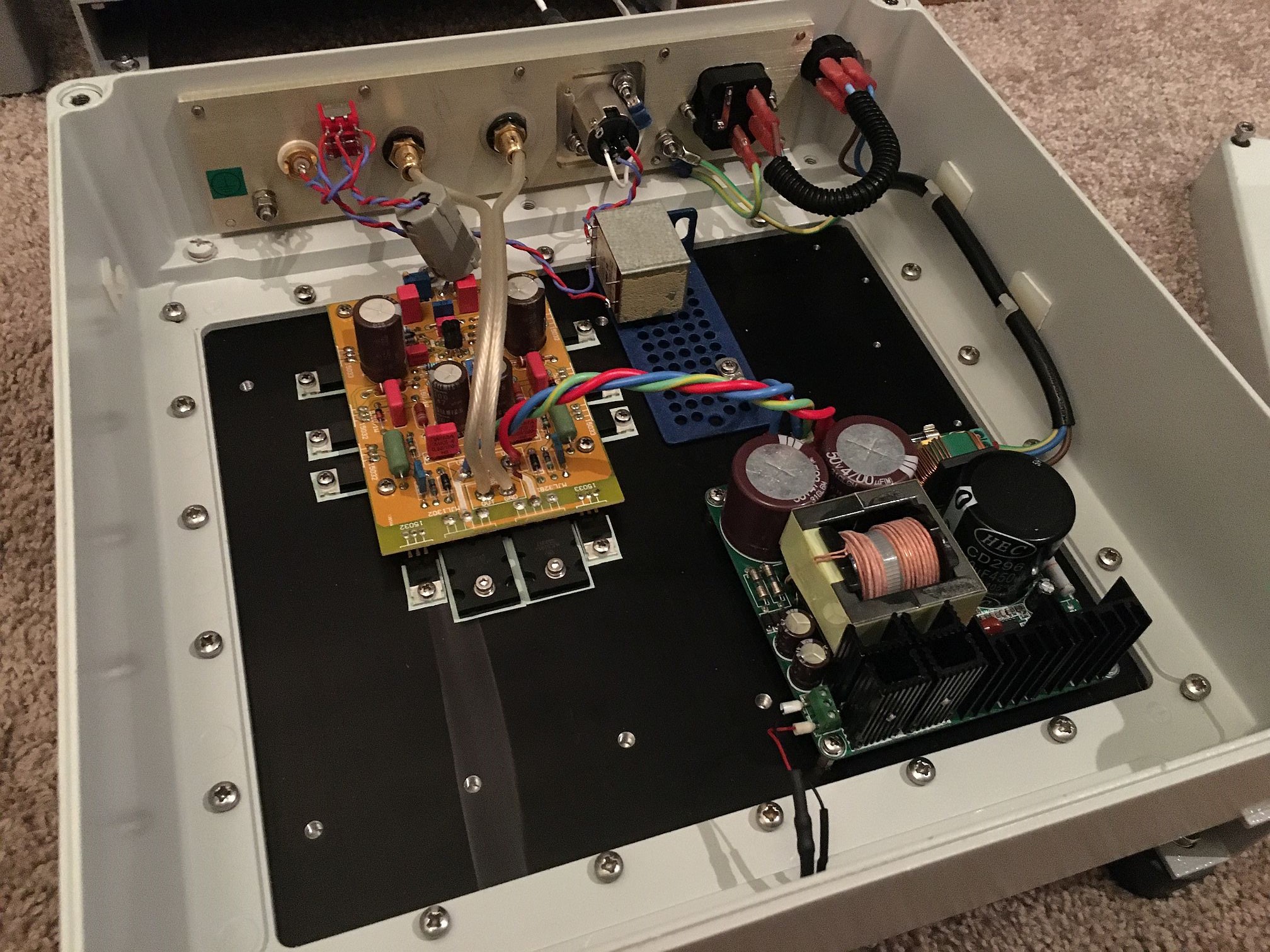

Completed my clones a while ago.
Using connexelectronic smps without any problems. Used high tolerance, low temp coefficient resistors throughout and gain matched relevant transistors.
Offset stable around 10mV (25mV after 1 hr) on both units. big heatsinks needed.

is swirching your job or did you buy it?
Put so close to the entrance does not cause problems?
Can you write any data on that power supply?

Some people seem ok with smps, even with the original crappy caps. Others insist on upgrading at least the caps. And of course the more hard core members of the hobby will never seriously consider an smps in a high end design 🙂
the conventional, ie floating, filter cell is based on the quality of the capacitors: the electrolytic quality capacitors find them expensive, occupy space and must be wired WELL.
We have modified the 108 modified even in the final stages of power and, if you want to believe me, it is a good step forward compared to floating filtering; in addition, it costs much less, is much better and takes up less space, but it has a cost and requires a certain degree of design.
SE switching provides stabilized voltages is a must, always if it does not radiate or impose other problems; but in this regard it is possible, if it radiates, to resort to the Faraday cage (which I would do anyway).
The fear of audiophiles for switching power supplies is like the fear of children for the dark: they are VOLTAGES
