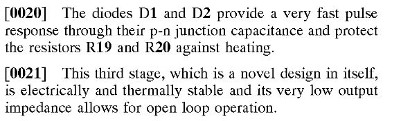

Just wonder how Herve defended its patent
As patents are defended: by paying the requisite fees. The circuit is patented in its entirety and there is also a claim the diamond topology itself is a "novel design".

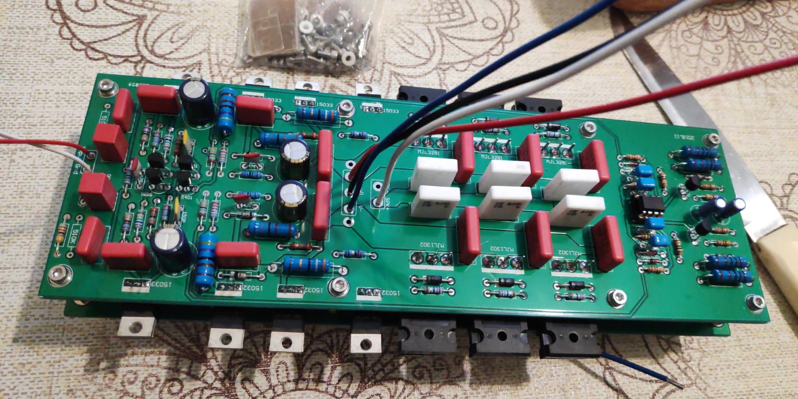

After more than a 100 days of waiting, I've finally got the amplifier I have ordered from AliExpress. I was wondering if I should make some changes to it to get best possible performance. If yes, what would you suggest?

I see 3 pairs of endings per channel:
- check the zener value for polarization and relative resistances, the Chinese are always - optimistic -.
I see the servo circuit to limit the offset:

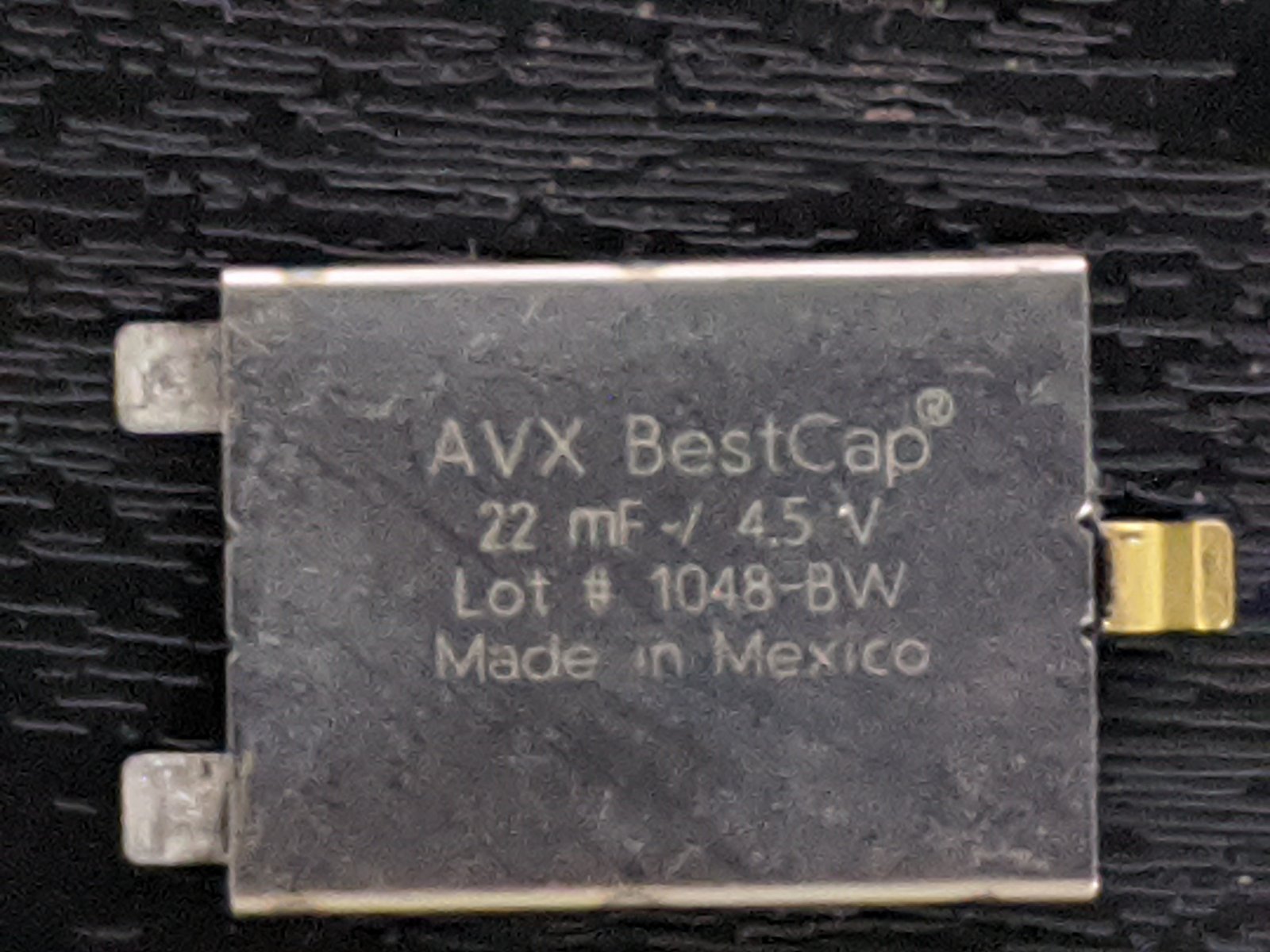

it is a circuit that makes the ending sound bad and is not needed if you use the 22millifarad super cap which is even better and even better if bypassed with a good model.

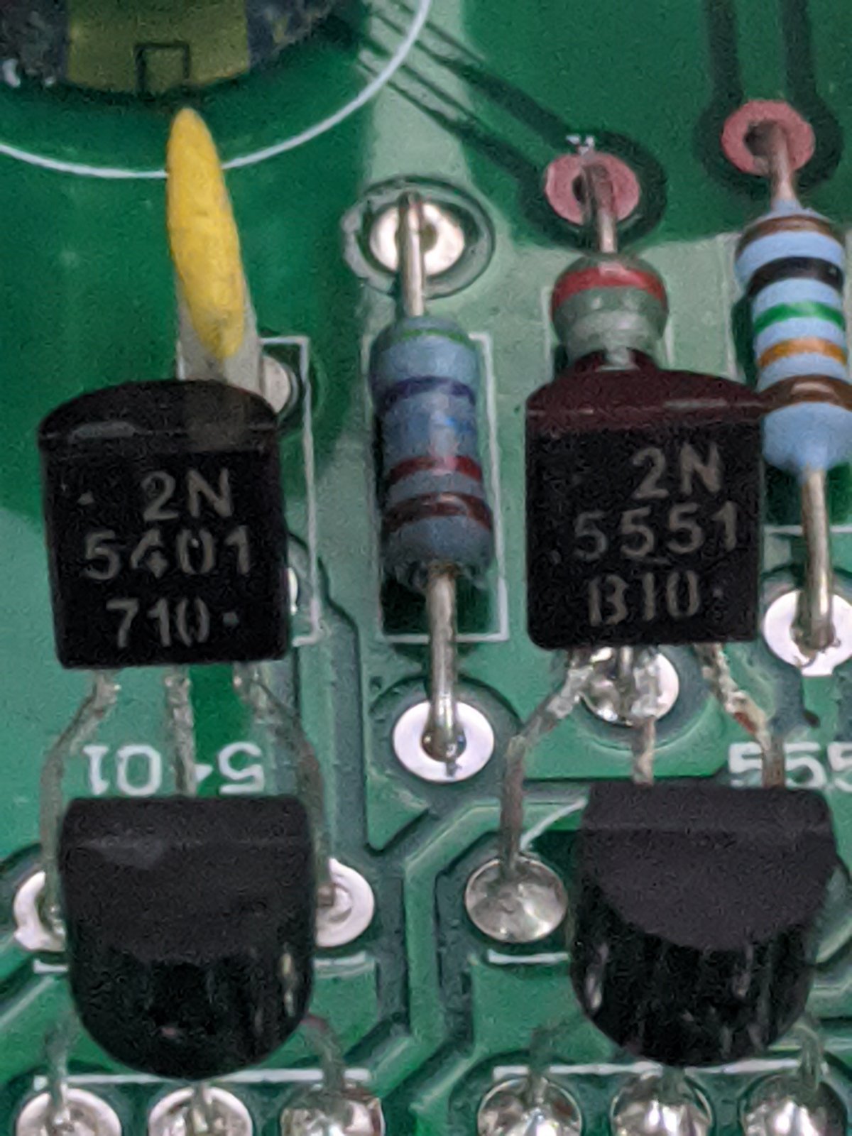

Better to attack the 4 transistors input to TO92 and check their selection: the Chinese do not do it and this circuit requires an accurate selection of all the active ingredients.
The 2 x 3.3 micro input caps play from Wima MKP, closed and dark
