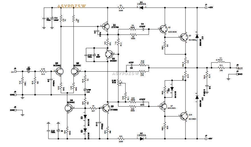

The standard edition works at just over 200mA per device. No idea if the same current per device is maintained on the boards with parallel devices, that's why i asked for a circuit.

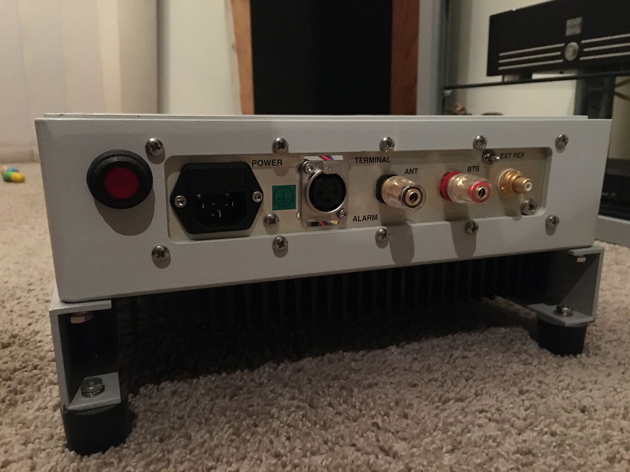

The case is recovered from a 800MHz RF link and is meant to be wall mounted.
I could've flipped the U channel brackets over so that the heatsink fins were vertical but couldn't be bothered in the end due to the size of the heatsink, and also focusing on other tasks.
I had a ferrite clamp on the rca input due to unshielded wires, and I was playing with a SDR (software defined radio) nearby. ferrites that size do nothing for audio.
