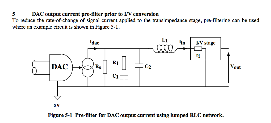

Gentlemans some time I go I read this document but never tested. Proposal inside is somehow similar.
https://www.google.ro/url?sa=t&sour...F2BPVyTOUnbQiHkqQ&sig2=gZ7RRNAwS7rpsUt4I6MQwQ

Now for the schematic in that paper, let me point out why there is a significant difference.
Yes, indeed looks similar, except it isn't - that filter is too high in impedance to work on what is a "voltage" DAC.
Note the 10K? That should be reduced to 47-100R and then the cap (which will be hugely larger in value) needs to be tuned to get the desired response at 20KHz.
That 10K is effectively a buffer from the added cap in red, and indeed the two smaller caps to ground from the same point. The DAC "sees" the 10K, whereas the Rasmussen Effect it must "see" a low enough value that affects the output of the DAC directly. In that schematic below, the response change only occurs after the resistor, what we are inducing is a change on that DAC's output.
In effect a load in put on the DAC's output.

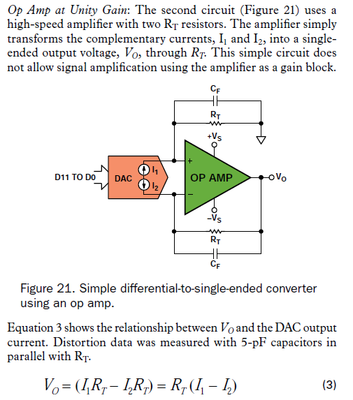

1."Current" DAC into standard Virtual Earth, with ALL values supplied.

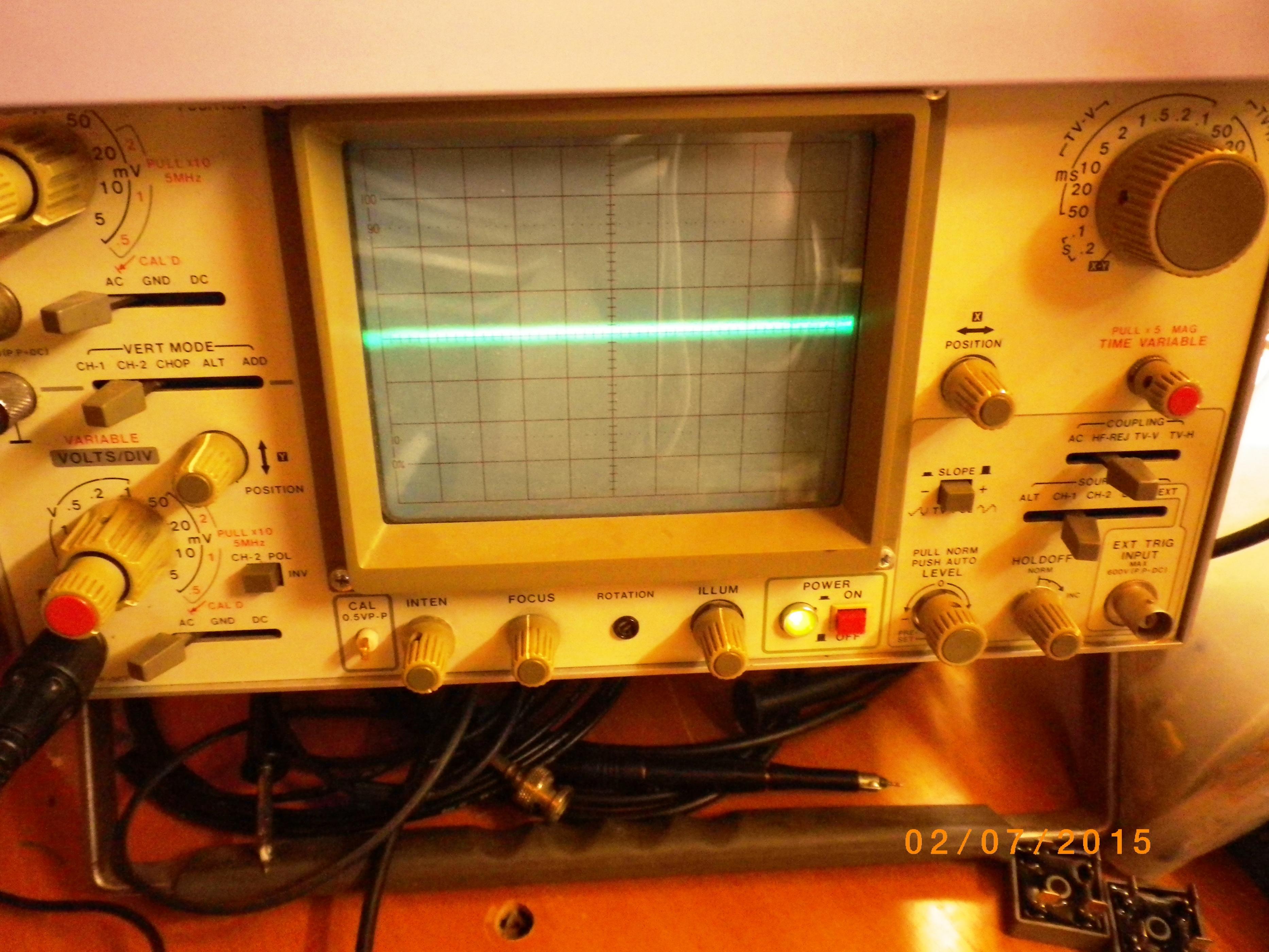

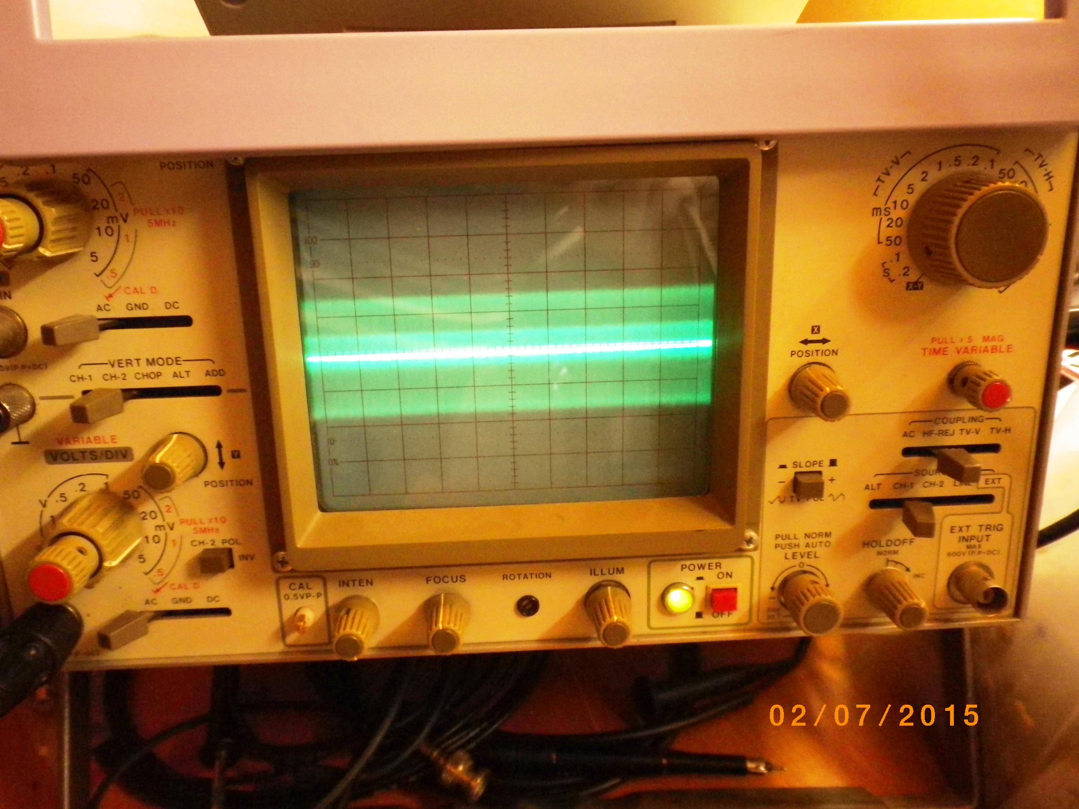

Hi Mr Joe Rasmussen
here is my output wave about 30-50mv ripple before put LPF filter on output of my DAC ESS9018K2M Diyhnk
and after 1-2mv with filter .
Which is your suggestion for this dac with one opamp?

Thanks for your cordial approach, but I am just plain ol' Joe.
I will be addressing your situ as Scenario 1 shortly. This is arguably the typical implementation and in this instance the ES9018 is used in current mode into a Virtual Earth. It can of course also be used in "voltage" mode and we shall get to that in Scenario 4. So we shall revisit ES9018 twice.
A filter is always a filter, all things being equal, and that is what we see on your scope, but later in Scenario 5 we end up not using a filter, but a Zobel Network, where a 1:1 transformer does the job of filtering HF>100KHz. The reason for pointing this out is to consider that we are not really talking about a filter perse' because the "Rasmussen Effect" can be triggered by something that is not a filter as such, but, as we shall see, an over-cooked Zobel that does nothing above 100KHz. Sometimes we may use a proper filter, but in other cases it will be a Zobel.
So all this will unfold. Scenario 1 coming up first.

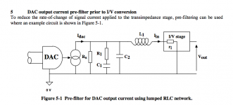

Malcolm Hawksford in article
C111 Current steering transimpedance amplifier.pdf
Malcolm John Hawksford - Publications
presentss an idea of, he said, pre-filter for Iout Dacs
(but without values of the elements only like a concept sketch)
