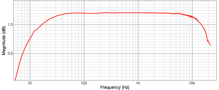

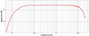

Some datas showing that older r2r types have alreadu roll-off of 1db cca to 20K
BUT only with no oversampling? * jpeg

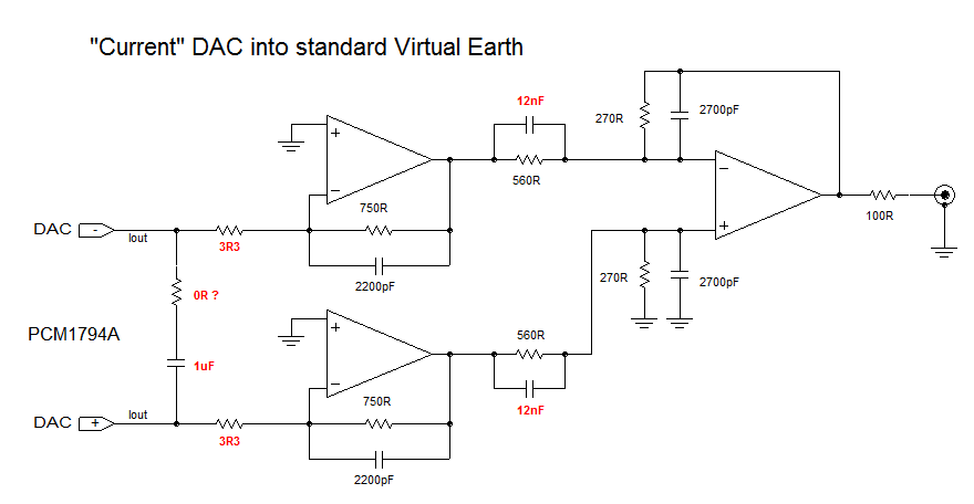

OK, here goes. I admit to a slight nervousness...
1."Current" DAC into standard Virtual Earth, with ALL values supplied.
I gave some thought as to what Iout DAC to use, was thinking of ES9018 and their recommended post-DAC schematic (and I did model/plot it), but decided to go with Burr-Brown PCM1794A as it is a pure "current" DAC and the Sabre is not.
Added components. The values in Red are not part of the original recommended post-DAC circuit.
We are adding three components between the output(s) of the DAC and the input/virtual earth (ignore 0R ? as it was used for experimental purposes).
The output of the I/V converter is low Z and hence the compensation/EQ is suitably buffered. The two capacitors 12nF needs to be tweaked just right and will restore flat response at 20KHz, fully isolated from our post-DAC passive network.

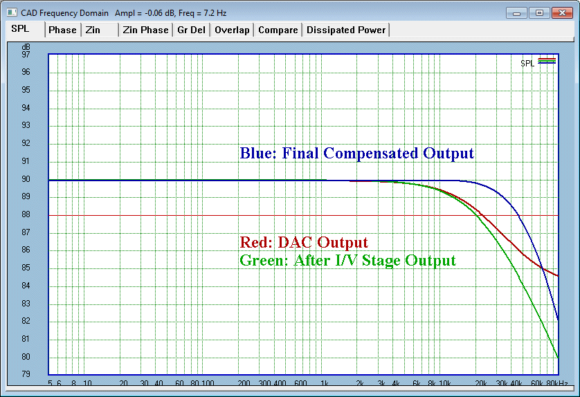

Now we get to something interesting, that 1uF cap directly across the phases is in fact not quite a low-pass filter.
This was confirmed by plotting:
1. The final fully comepensated (what you end up listening to) response.
2. The inter-stage output of the I/V converter (no compensation yet applied).
3. And the actual residual voltage on the DAC output (compensated +49.6B to match the other two).
That last one looks like what?
It looks like a Zobel.
It also confirms that the filtering is gradually petering out above 100KHz and flatlining.
Our 'filter' cap is before the pair of 3R3 and as they are in series returning to ground, it becomes a Zobel. At some point the reactance of the cap becomes less than 3R3 and that happens below 100KHz. Above that we will get a plateau - no actual low-pass.
Same goes for what I did to that RAW DSD DAC in Queensland, it was a Zobel network of 15nF and 1K5, put some resistance in front of it and I get virtually the same slope. Guess what, by 100KHz that 1nF cap, relative to 1K5, gets out of the way.
I think we can definitely say we are not dealing with the effects of a low-pass filter and the 'effect' is actually, relatively speaking, low in frequency.

3. "Current DAC into Step-Up Transformers - with projected and approximate values supplied (have to be calculated individually).
Cheers, Joe

Hi this is the graph of the 10Riv (with JFET 2mA current injetion) + C=100nF
in parallel. Simple passive IV prior to the JFET amplifier and buffer stage.
No Riv+C only.
It is about -1 to -1.1 db @ 20KHz from 1KHz. So it should be little bit larger value to meet the -1.4db. The phase @ 20KHz is -3.6 to -4 deg from 1KHz.
Group delay is 4.86 mS 1k, 4.96mS 20k.
But I measured also significant distortion starting rapidly at 5K cca to 10Kcca...
No Riv+C only.
