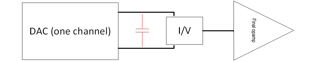

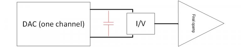

5. "Voltage" DAC into 1:1 Transformer - with projected and approximate values supplied (have to be calculated individually).
Again I can only give you an idea of the values of R and C, which of course (again) forms a Zobel.
Again, based on the transformer you choose, the one I use for the most part give me 15nF and somewhere around 1K2 to 1K5. Tweak resistor value to give you -2dB at 20KHz. You may of course test the transformer by driving it from a Sig Gen with low output Z, say 50 Ohm - and plot response up to 100KHz. You will not see any leveling off as per earlier Scenarios, as by 100KHz the transformer should be filtering enough to prevent you seeing it.
Many "voltage" DACs will give you near the full desired 2V RMS out -but the example above being PCM1793 will give you 1.15V RMS.
I would not recommend using this with the Sabre DAC. These transformers works best when driven from a low source Z and the Sabre is just too high, even with paralleled phases.
Again, it is not the Zobel that ultimately does the filtering, it is of course the transformer (band-pass), once we get high enough in frequency, the Zobel has little or no consequential effect.

I saw the example with Riv and Transformer at the output of the dac.
Because I have an experiance with such topologies, I can kindly point
that solution should be reconsidered.
The Thermogen resistance of primary layer act like another, parallel Riv with
basic Riv resistor. So the amount of current is "doing" to voltage trough this DC resistance. Base on this the value of this primary windings resistance is of main importance.
Another thing is that in that case dca chip loaded with Riv acts like driver of reactive load. That deserves very low internal impedance. Because it is highly reactive load.
From primary side, stronger value of primary inductance is needed to acheive low end
without phase shift. That means higher number of turns.
If it is step up, like in example shown, another thing is that we will have much more capacitance at the secondary. this capacitances are transferring with square to primary and directly to dac output pin load.
So in that case we load the dac chip with a significant Inductances, and maybe more with capacitances. All in all huge reactive load among basic Riv, which is in that case far from pure resistive nature.
I think that In case of using Riv, after I to V conversion, should be used a buffer with low internal impedance to properly drive interstage transformer.
After this, applying correct RC anti-ringing network like You suggest is next thing.

Can't answer all your questions, but that actual schematic, I have modified it and uploaded it and should be visible below.
You can add correction caps across R1, R2, R3 and R4, but I would suggest you don't bother unless you know what you are doing, wrong value and you could end up with an excessive rising response. So add the components shown and take a listen.
