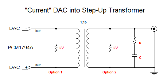

3. "Current DAC into Step-Up Transformers
We are not going to dwell on the pros and cons of using Step-Up Transformer for I/V. Instead just simply explain the Zobel that is used here is in effect 'over-cooked' in a way that you would not normally do on an audio transformer.
Usually the I/V resistor is on the Secondary, I am not going into any endless discussion here what the I/V value should be (only that it will be lower on the Primary than if used on the Secondary and calculated by the turns ratio etc, the value 15:1 is only typical).
What we need to concentrate on is the R & C that forms a Zobel. Usually you would come to some kind of decision of the I/V resistance and then under normal circumstances, depending on the characteristics of the transformer, to get the response flat, particularly at 20KHz.
But we need to over-cook the Zobel so that it is not flat, but gives a final response similar to the Red plot is Scenario 1.
Let's say we use Secondary I/V resistor and use Sowter's calculation on their website, used here:

HOW TO CALCULATE THE I/V RESISTOR: First calculate the secondary current (Is). This is given by the primary current ( Ip) multiplied by the inverse of the voltage ratio. If the output current pf the DAC is 4 mA p-p, Is = 4/12.8 = 0.27 mA p-p which is 0.27 / 2.83 = 0.094 mA rms. If we want to get 0 dBu (0.775V) at the grid (Vg) we need:
Rsec = Vg/Is = 775/0.094 = 8.2 kOhms (I would prefer lower than that).

Of course this also affects output at 0dBFS and in theory the lower the Z, the better, but also lower output. No free lunch I am afraid.
This use of step-up device is not my favoured option. But we do come down to calculate the Zobel, and I would first engineer a Zobel that maintain flat response at 20KHz. The whatever C was, increase by 50% or so, then adjust R to pull the response down by near -2dB at 20KHz. If that resistance ends up to low, then vary C until you manage to get the end target.

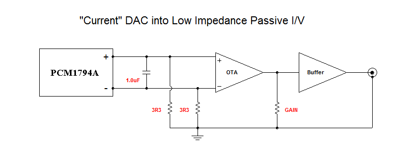

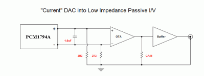

2. "Current" DAC into Low Impedance Passive I/V
Passive I/V into twin 3R3 resistors and using 1uF. Same values as before. The OTA is a "Operational Transconductance Amplifier" with no feedback. There are a number of those, OPA660 and OPA860/861 come to mind. As slew rate free as you can get.
With tube circuits I have seen 33R resistors, this will generate +20dB and be suitable for tube input with gain. The cap would then need to be scaled to 0.1uF - again the Zobel shape will be the same.

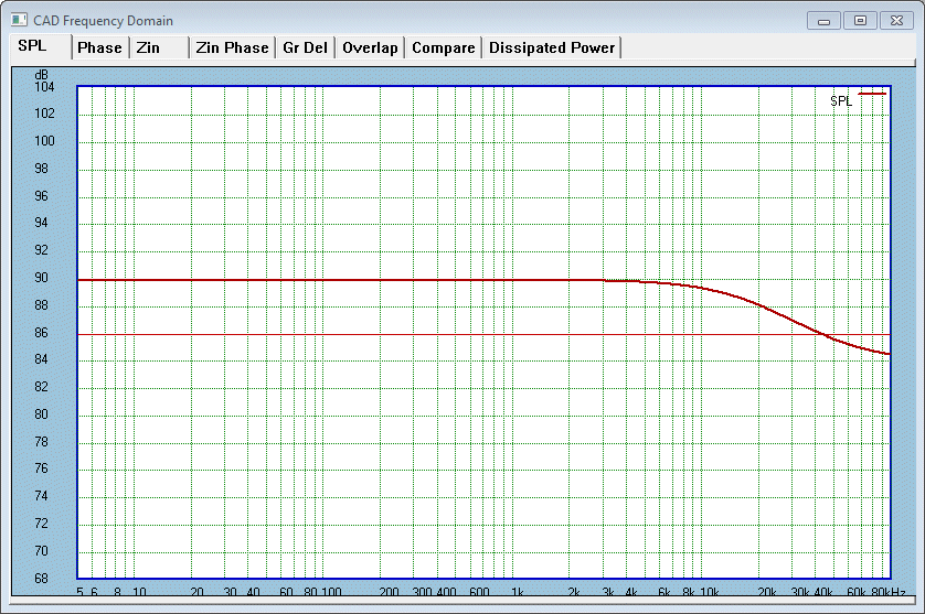

Now the question arises, can we correct this to flat response at 20KHz? Again, some may say "don't bother" and if this is a USB DAC, use JRiver again to EQ the response flat.

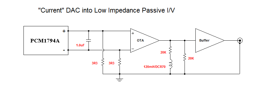

Another possible way: I did some modeling of the OTA and this worked - I have not physically built this, but all indication is that carefully tweaked/adjusted, this can return a flat repose:
I was able to see that I could source 120mH encapsulated choke rated at 8mA and DCR of 70 Ohm, these are available. Modeling show those values above do work, but may be needed to scaled it to get the desired gain or output level relative to 0dBFS.
Once again, we see evidence that this is also a Zobel rather than a filter. This should be expected since we have the twin 3R3 terminated into virtual earth in Scenario 1. (theoretical zero Z) and here again similarly, they are physically grounded, so the response, being about -2dB at 20KHz and about half a dB down at 10KHz, with the same values as before. Here is the plot:
There is that shaped curve/plot. Definitely a Zobel. Of course, in real life there is likely to be added filtering at a point further down the chain, so the final filter cumulatively is a proper low-pass, but the 'effect' directly on the DAC pins/output is not really low-pass, but a Zobel.
