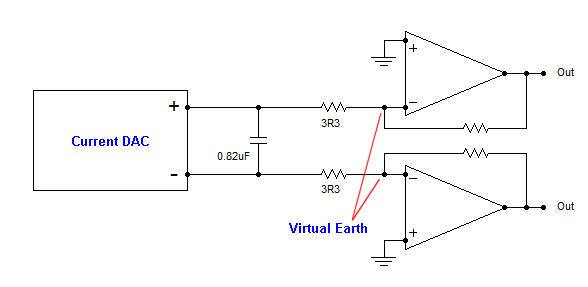

We established early on in this thread that the "Rasmussen Effect" is basically a first order LPF with a 1.3 dB drop at 20 kHz. It appears that some people find that that drop-off creates a pleasing effect.
Would it perhaps be more helpful for us to talk about it in those terms, instead of terms like pre- and post-emphasis that some people find possibly misleading?
Let's me phrase it in another way. This LPF at -1.3db @20KHz is the main thing of this thread.No response... start again.
On top of this issue, there are (apparently successful) attempts to correct that 1.3db drop by using digital EQ, as described in post #461. It's a bit secondary but seems to point out that the "effect" isn't related simply to frequency response (which would be surprising at 20Khz anyway).

I appreciate the time you took to answer and restate your position in clear terms. My current unease with this whole thread is how we have a single "effect" in extremely different setups. I'm no engineer but as part of my studies in both social sciences and philosophy, I've had my fair share of methodology classes. When it comes to research, a good principle is to always try to isolate the problem, to reduce as much as possible the possible causes at work and their interactions. Anything looking like a blanket solution makes me skeptical.
I'm no fan of the damping explanation because how can it apply to both current out DACs and voltage out DACs ? Their analog output stages are very different.
It would be also nice to clarify where does this effect happen or not:
- does it happen if we use digital EQ to emulate it ?
- does it happen if we add a further stage with a simple LPF opamp filter?
- or does it happen only if we use analog (R)C filtering right at the output pins of the DAC?
As it is, I'm under the impression that you're saying that there is an optimal analog filter for DACs, a filter which should be more aggressive than usually advised. If that's so, it would be better investigated by using a voltage out DAC with single ended outputs, followed by a as simple as possible parametric LPF made of opamps in cascade.
No.
No.
YES.

I have a DIY dac with ESS 9018K2M the poor cousin of Sabre 32 and i use a clasic opamp datasheet I/V conversion. Is my circuit usable to obtain this Rasmussen effect ?

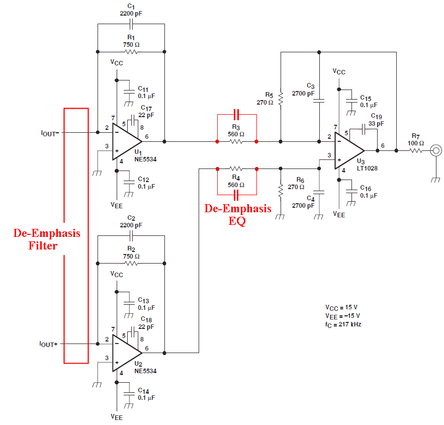

Indeed yes, and also the option of putting the EQ before the DAC.
In fact this is easy for many to try even now, if you use a USB DAC with JRiver Media Center. Apply the roll-off to the point you desire @ 20KHz and apply the data from post #461 into the 64 bit parametric EQ. This is in effect a digital pre-emphasis.
This points the way to other techniques that can be used, which I also suggested, if the correction is before the d-s DAC, then it is in the digital domain, if the correction is after the DAC, then the correction is analog - and this is easy to do in most commercial designs with opamp I/V - again sample as per post #461 repeated here:
Yes indeed.
This will work with Sabre DAC too, just three components per channel. Note that this is a current DAC with no DC offset and hence "+" is grounded., so it is referenced to DC ground. Your DAC is likely +1.65V, but the above still works even when you have +1.65V on "+" pins.
Another complimentary thing to do, get some 0.1F supercaps, make sure they are rated +5.5V - and put these are the two (?) power supply rails to the DAC. This cleans up the d-s modulator clipping to rail a lot and works well in tandem.

Pre-emphasis and de-emphasis was part of digital in the beginning. A number of early recordings had it and some DAC's had a passive low pass filter to correct for it. The first gen Crystal DAC for example worked that way.
The hazard of re-emphasis is overloading the digital and that can happen with either Analog before the input or a digital filter in the chain. Some DAC chips handle that overload really badly. It also can happen without the digital pre-emphasis as part of the internal machinations in the DAC. Most DAC's have some form of low pass filter. They are essential for correct operation (part of the reconstruction filter) and are usually set way beyond the audio band.
One challenge of evaluating a system like this is separating the the desired effect from the known effects of HF rolloff. As noted sometimes the HF rolloff sounds more like an extended response than the actual flat response. An interesting way to attemt to untagle this would be to swap the pre-emphasis and de-emphasis. Add the de-emphasis to the digital side and use an active pre-emphasis on the analog side. Adjust to get the same flat target response and see if the unpleasantness is increased significantly. If its an intrinsic effect of Delta Sigma it should get more pronounced.
