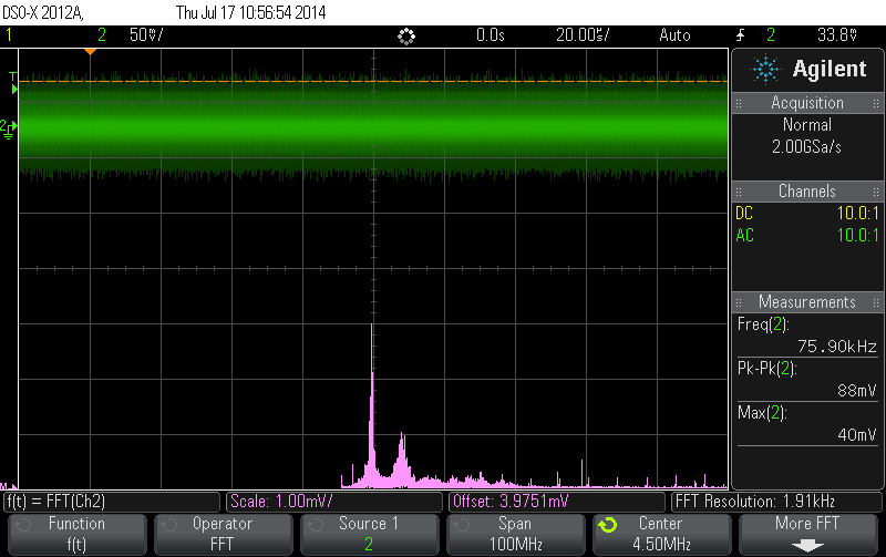

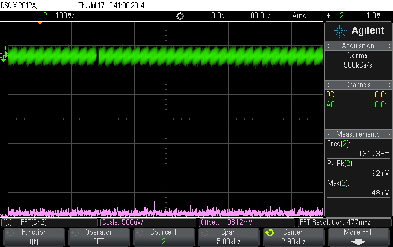

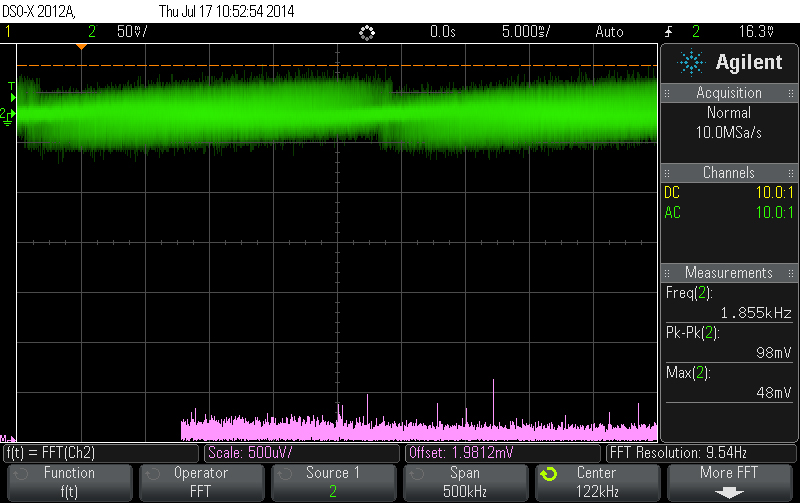

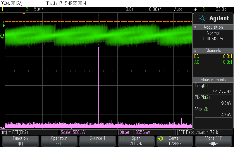

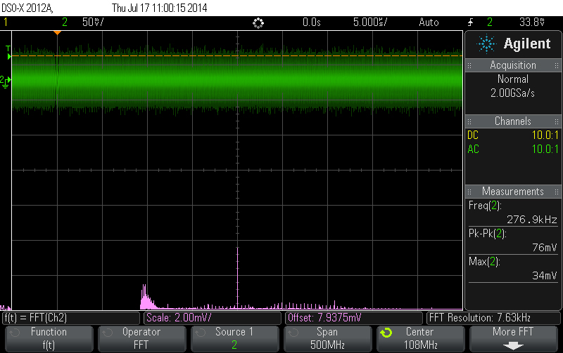

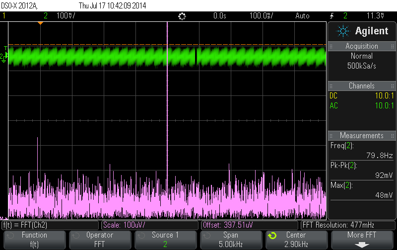

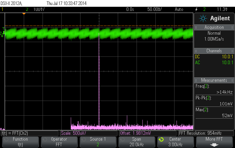

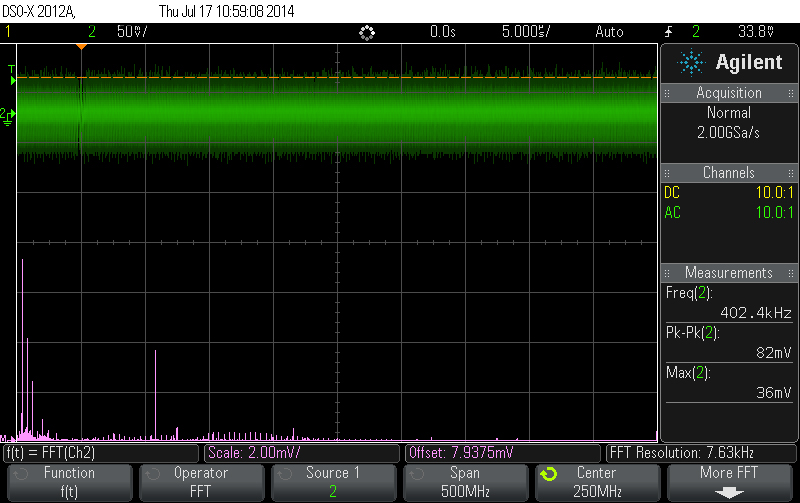

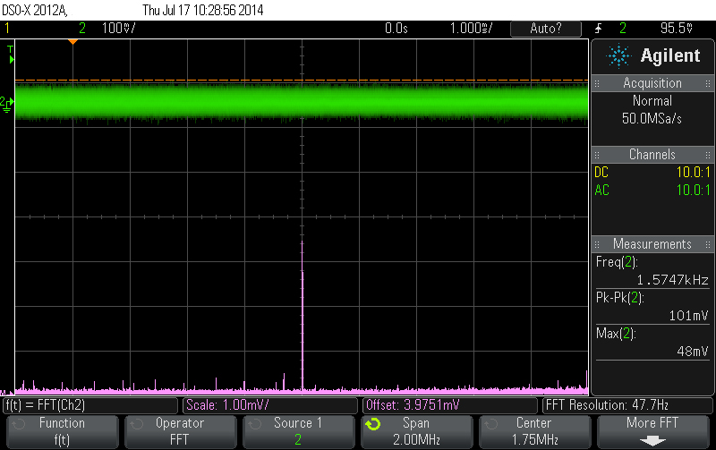

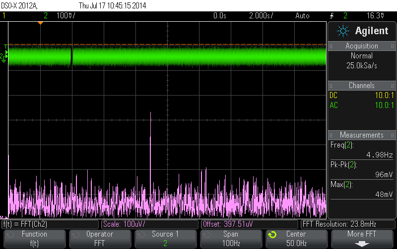

I took today some FFTs of this noise.
There are here the most representative of these snapshots. It can be seen on pic 10 a very stable pick, which is in fact some "residuals" of the clocking signal (108Mhz) for ES9018 in my system... BTW, the clock frequency have nothing to do with the shape of the noise. There is exactly the same shape and the other of the noise particularities at lower clock frequency for the Sabre chip...
Please note that the measured noise amplitude level (Vpp) is around 100mV, while the FFT calculations are for 1mV/div range and under.

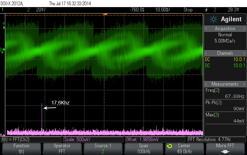

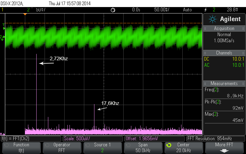

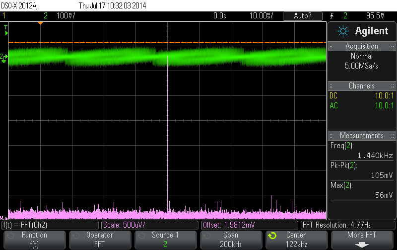

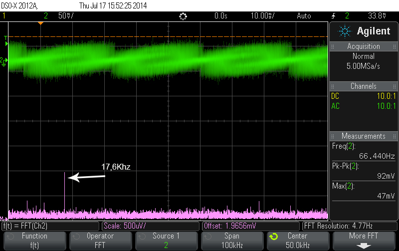

I have chosen to divide the spectre in small parts, because my scope have a particularity to show FFT calculations. It does not exactly as a spectrum analyser...
There are some more pics here...
In pic A there is shown a 200Khz bandwidth, and the only frequency to be seen here is 121 - 122 Khz one from the analysed signal. So, I should go down in bandwidth (span) to view some another more details/picks...
In pic B the centre of the spectre is 50Khz, and we can well see the 17,6Khz pick of 1mV of the 92 mVpp of the whole noise signal. Please note that it is not outputted any audio signal while we see these noises. The speakers are dead silent (when they are connected at the output). The outputted audio signal in the presence of this 1mV 17,6Khz (of that 90mV whole HF noise spectre), it is up to/ into 16Vpp... The sound of a trumpet at this full level (approx 10W power) of 16Vpp on output is just painful. The silence of a recording is as silent as no any audio signal on the output... Well, no just old recordings.😉🙂 There is not ever possible to hear this 1mV even with the ear right over the piezo tweeter..
Well, further to pic C... Lowering more the bandwidth of the spectre to 50Khz, I have the centre on 20Khz. So we have 0Hz to 2o Khz (centre), and 20Khz to 50 Khz (visible to 40Khz) the rest of the spectre in the right side of the display centre.
We can see here some more details. 17,6Khz and a quite high pick of 2,72Khz. I have measured these picks previously to save this picture. Therefore I marked it with quite precise figures.
And to conclude, a very interesting picture (D). I have lowered the intesity of the display. So we can see some more details of how the noise is shaped... There is in picture the same pick of 17,6Khz.
What you may mean/think?

Hi Coris,
... pls. allow me to jump back into this thread.
Your measurements look quite similar to the ones I made when developing the DAB - maybe you remember. The real thing is, that all these pics show modulated noise. I have a ES9018 evaluation kit too but did not yet work on it due to its unpleasant output configuration (I wanted to use tubes for the output driver).
Well, when developing the DAB, I found such modulated noise too from a PCM1798. At first - no idea where it came from, but I suspected artifacts from the internal clock as well as modulation from the time-slicing. Then I used better probes (250MHz) - and - the noise-band looked other. Anyway, the noise was still present!
I suspected now my 100MHz DSO to be responsible for the modulation and again I was right. Simply using another scope (an older 50MHz analog) showed no modulation at all. So I was sure, that there was noise present but all the modulation as well as the adjacent FFT figures my DSO showed were "digital fiction" only.
If you had a look at the article about the DAB, you will see that I used a ferrite pearl in the common GND-wire, which separates digGND from aGND. This approach cured the analog input from the inherent noise-band. I could not hear the noise from my truly efficient 102dB_SPL horn-speakers but on some occasions I suspected the noise to modulate again the treble (like the sound of cymbals). Anyway - inserting the ferrite pearl and these effects were gone.
Do you have an (maybe older) analog scope too? If yes, try it out!
Ciao, Barbara

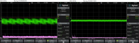

In my post 448 is to be seen a quite strange signal shape in the scope snapshots presented. I found out why it looks like this. There is my Agilent (now Keysight) scope which alter the original signal, and show it modulated in intensity.
Well, one should trust a measurement device, but not an Agilent one... At least not 100%...
There is the FFT function which alter the signal, and introduce such spurious...
Yes, you had right.
Actually this kind of noise the ES9018 output is not chaotic signal at all It is a well modulated "something"...

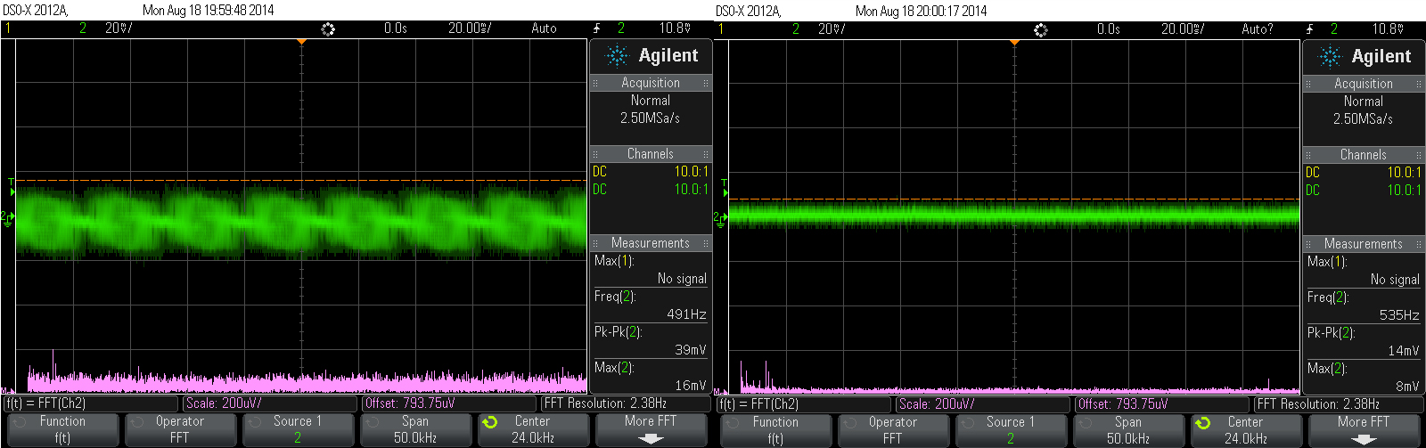

Please take a look at this snapshots here (sorry, I have to use further my digital Agilent...).
There is in pictures the outputted noise from the ES9018, and the same channel noise when the DAC is not active, but the system is powered. The FFT calculations shows no any specific frequency, even though is to be seen a clear modulated noise signal. Why is not reflected that modulation in FFT? Is something wrong with the scope and its FFT function? Or is really no any specific frequency there in that modulation? There is obviously that is a frequency which modulate the noise. But where is that (out of the FFT plot)?
The shape of the noise is similar in FFT, when ES9018 is active, to the noise in the system, when the DAC is not active (only the overall level is lower).
I think is quite interesting this similarity, but I do not know if it come from the scope or is in fact nothing there...
Please ignore the alteration of the intensity of the displayed signal, which it looks very well as a $ shape... This is for sure Agilent to be blamed for...

Hi again Coris,
well I had to say one more time, you should not blame the Agilent DSO, since any other DSO will show such "digital fiction" too. The failure was to apply noise - a chaotic signal (better say statistically distributed signal across a given bandwidth) to digital equipment. All you can detect is dependent on its sampling frequency and the functioning of digitally controlled filters (-> FFT). Using better or even less top frequency probes will change your screenshot. So all you can see is a result by chance ...
Using an analog white noise generator (f.e. zener-noise-generator) as the source will give similar results.
Did you ever think about the sampling theory? Well, try this out -> simply digitally synthesize a sine wave of 20kHz using 44,1kHz sampling (like CD), burn to a disk and watch by any scope what's coming out of the player. No oversampling or time-slicing will help to recover this poorly noodling wave! You can see it drastically from app. 5kHz (two octaves below) on ...
Now imagine what happens if you sample a statistically distributed noise band!
You should not blame YOUR DSO, as this is an inherent fault of any digitally sampling device by itself. A system fault so to say ...
Ciao, Barbara
Once more,
sorry I forgot to comment to your screenshots:
The first one simply shows more amplitude than the second one. That could be due to some muting facility in your player (don't really know, as I do not know the exact schematic).
But there is something interesting at the FFT-traces too: It shows maximum content of harmonics at the start of the trace (the lowest frequency). That has to do with the transient effect of any digitally controlled filter. Therefore techs always set the low frequency corner at least for one octave lower than was to be tested. A well-known effect!
When testing 20Hz to 20kHz you had to set the corners at least to 10Hz and to 100kHz as there are strange artifacts at the upper corner too.
You should never trust any digitally created FFT for the lowest and the highest octave. But normally it is worse at the top of the range ...

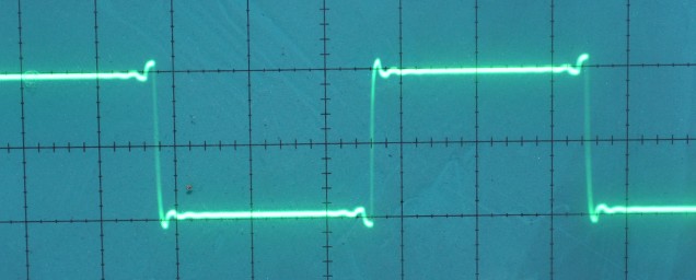

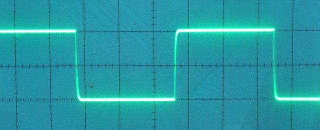

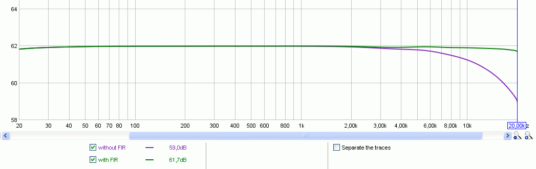

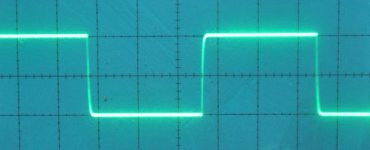

I'm reviving this discussion because of a few experiments I've recently run, providing perhaps some small insight into the "Rasmussen Effect" filtering.
I built a DAC using the Buffalo IIIse board and Lundahl LL1676 transformers on the output feeding the grid of a 26 DHT tube output stage - the LL1676s convert the balanced output of the DAC into SE, remove the DC offset from the DAC, flip the absolute phase of the signal to reverse the effect of the single DHT tube, and allow the -9V grid bias to be applied to the grid of the 26, which is directly connected to the LL1676. There is no ground connection on the primary of the LL1676, it is simply taking the voltage outputs of the DAC +/- and summing them.
I configured the snubber and primary resistance of the LL1676 to achieve exactly a 1.3dB rolloff at 20kHz vs 1kHz, and indeed this sounds very, very good, with great clarity and soundstage while not sounding rolled off. FYI, this means using a 3nF/1k snubber on the secondary and an addition 3k3 resistance on the LL1676 primary; the LL1676 is series connected on both primary and secondary in a 2:1 arrangement.
So, employing the Buffalo IIIse oversampling and FIR filter (OSF) with S/PDIF input from my CD/HD player, this sounds great! The interesting part came when I connected a Sonore USB/I2S board to the DAC...
The Sonore board has an optional OSF of its own which they claim uses a "sophisticated partial minimum phase filter that significantly reduces pre-ringing". I spent the better part of yesterday listening to HD computer files played through the Sonore USB board, with the Sonore OSF ON and the Buffalo OSF OFF and vice versa many times over. I found that using the more sophisticated Sonore filter with my DAC produced a very smooth sound, but it was too rolled off in the highs compared to the Buffalo OSF (with its FIR filter), which sounded better in the highs.
In an attempt to explain these very noticeable results to myself, I did a little digging on FIR filters and their effect and found the following on the TotalDAC website, which I thought was interesting. Picture #1 shows the response of a DAC without correction for HF rolloff versus corrected for HF rolloff using an FIR. Without the FIR, the response is rolled off by about 3dB at 20kHz, and with the FIR the response is flat up to 20kHz. In the time domain, scope shot #1 (picture #2) shows the slightly rounded edge at the front of the square wave when no FIR is used, and scope shot #2 (picture #3) shows the response using an FIR filter (for illustration purposes the amount of ringing is not important, just the fact that the FIR induces ringing is the point). It is clear that picture #3 shows significant ringing of the square wave, so the price to pay for restoring the frequency response to flat using an FIR filter is ringing on the leading edge of square waves (this may be obvious to the digital gurus here, but it was new knowledge to me); I expect that in some FIR implementations the ringing may be substantially more than in picture #3. In my experience with building and testing analog audio gear, excessive square wave ringing leads to the familiar HF glare sometimes heard with digital - the fact that the simple Rasmussen filter reduces glare while not excessively rolling off the highs seems to point to the mechanism being a reduction of the FIR-induced ringing effects while not excessively removing the positive effect of FIR filters on the frequency response. This is supported by my good experience using the 1.3dB rolloff on the output of the Buffalo employing FIR filtering.
Now, what gets interesting is what happened when I used the same 1.3dB rolloff output circuit with the Sonore "sophisticated OSF which significantly reduces pre-ringing"...although smooth sounding the HF was definitely too rolled off sounding. It seems that reducing the ringing using both the partial minimum phase filter and the Rasmussen Effect filter results in too much HF loss...in my opinion this points to the Rasmussen effect as being one of reduction of ringing effects due to FIR without losing too much of the positive effects of FIR in frequency response; in other words a tradeoff between the time-domain and frequency domain responses.
Now perhaps I could just go with the Sonore filter and remove the Rassmussen Effect filter to get a technically "better" result, but I use my DAC with both the USB input and the S/PDIF input, and the Sonore filter only functions on the USB input (because it's on the separate USB board), so my S/PDIF listening would then not have the benefits of the Rasmussen Filter, so my choice is to leave the Rasmussen filter as-is and only use the FIR filter on the Buffalo board to process both USB and S/PDIF inputs. Perhaps if I someday move completely away from S/PDIF I can revisit the Sonore OSF/Rasmussen Effect removal.
The above is not a technical treatise by any means, but anecdotal evidence that I hope may shed some light on this discussion. Constructive comment/discussion is the goal.
PS: the FR plot and scope shots were taken as illustrations from this website:
TOTALDAC, principles

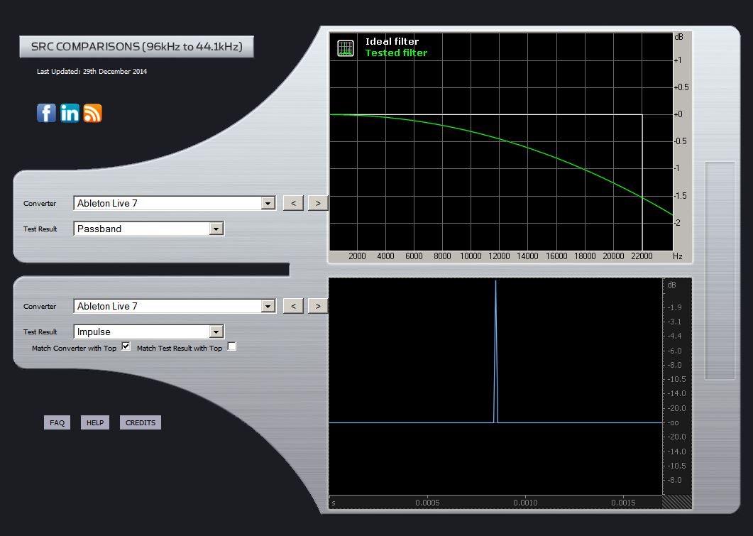

Hi Magz
Thanks for sharing about your Sabre output using a transformer and filter. Nice work. I think your pragmatic approach trying different filter set ups empirically and noting the sound is the best but theory can guide you where to experiment.
The filtering theory is complex. The total DAC is using a FIR as a high band equaliser to be able to correct the R2R NOS topology -3dB roll off. It could be dangerous extrapolating that example to your Sabre that intrinsically must upsample to do the sigma-delta noise shaping . However you can get similar pragmatic results using a computer audio player like Foobar etc with equaliser capability to boost the high bands while still using and enjoying the Sonore minimal ringing filter and leaving your analogue filter in place for the CD as source.
The Sonore filter may well look like other filters that favour impulse response to the detriment of passband meaning high f roll-off:
