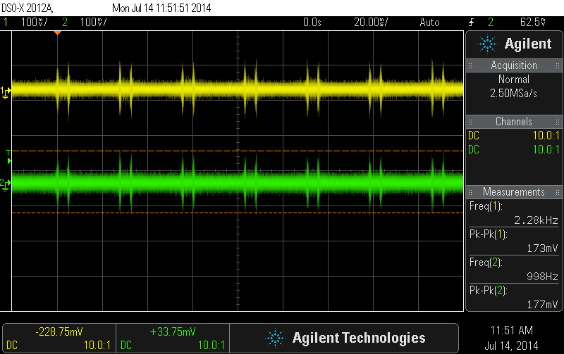

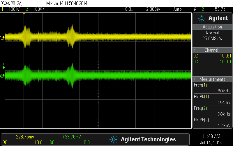

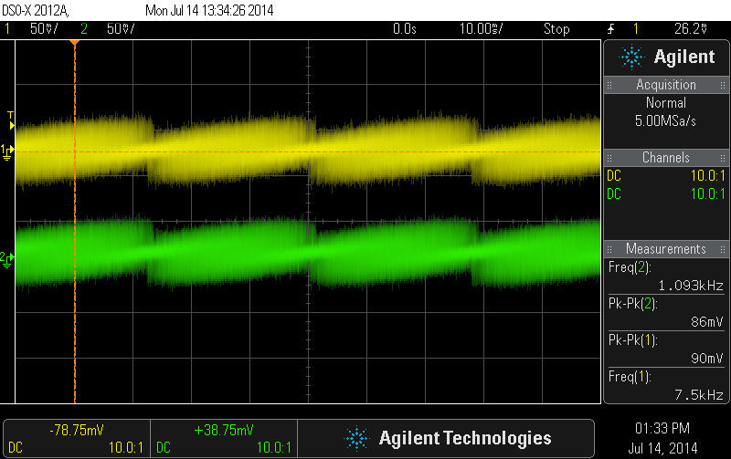

Well, I had in the last time the opportunity to take a closer look at this filtering trick, this time for ES9018 chip. BTW, it worked and it still work just fine for me on PCM1792.
In my system with ES9018, I use a post DAC signal processing without any filtering of the residual DAC HF noises. I have reduced their levels at under 100mV, for a useful audio signal of 12-16 Vpp, so is fine for me. My output on the L/R channels looks like in the pic 1
The probes are connected directly to the L/R channels output (no any audio signal). BTW, this residual HF noise is present only when the clock signal is active at the DAC clock pin.
I have connected 2x1n between the ES9018 differential output phases on its channels configured for stereo. So, 2n film caps on each side/channel. I got the results shown in pic 2. The increaseing of the residual noise level is obvious. A close up of this noise shape is in pic 4.
I have removed one of 1n caps on each channel, and then I got the noises shown in pic 3. The same shape, but not just in phase as before. Quite strange...
I have used for audio test a recording which it have a very good definition of the sound stage, with instruments and voice well and easy to locate in the sound stage. Playing this recording in normal conditions, it give me the voice not just in centre, but a little bit off centre, on the left hand side (between speaker and centre). Listening this recording with the caps (2n) over the DAC phases (differential output), I got the voice just in opposite side (right) but almost the same distance off centre. The rest of the instruments were in the same places... Even more strange...
The sound stage, paying back that recording with the caps in place, was not very special well (defined), but acceptable.
Removing the caps, everything was back to normal, with a very good definition of the sound stage.
My conclusions so far: There is enough obvious that in case of ES9018 chip, these caps increase the residual noises level on output, when one do not filter out these.
I can not expect something good, after heaving this experience, even with filters between I/V and final...
I could see a decrease of the noise amplitude after I have mounted 2n, than in the configuration with 1n. It may mean this that increasing even more the capacity over phases it may have positive impact? I did not proceeded yet to this experiment...
For me, the best result so far is not to have these caps over the DAC phases, when about ES9018...
I just start to think if the resulting effect (larger sound stage) when using these caps in that places is not a kind of psycho acoustic effect, due to some modifications/alterations in signal phases, or an effect due to the AC coupling in between of the DAC differential outputs (phases), when these caps are in that place...
It could be nice to have some more peoples involved in finding out more about this case, but it looks to me that the interest for the subject is quite low...

You need to look a the output in the frequency domain to get an idea of the ultrasonic component. It will be proportional to the signal level making it harder to see on a scope.
I think you are saying that the output low pass caps increase the ultrasonic noise? if you are seeing that I would suspect an error in the application somewhere. My concern is that anything that demands a lot of transient current on a system (which this does) will stress the inner circuits a lot. I would rather see inductive filters in series to reduce the transient current demand.
