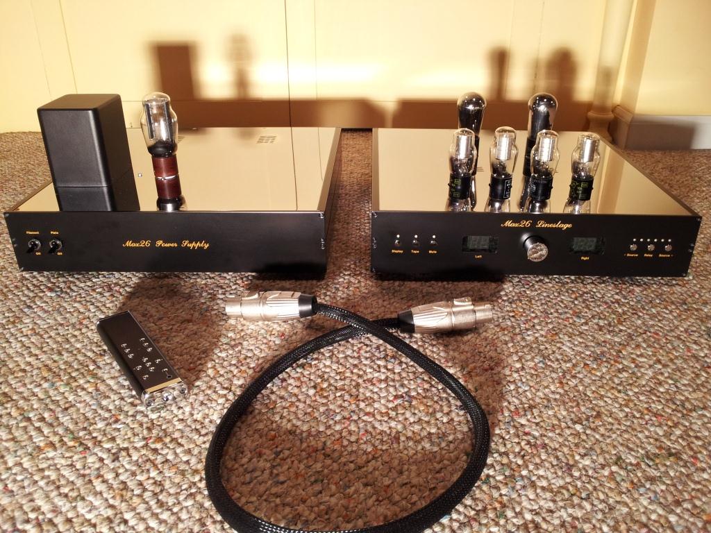

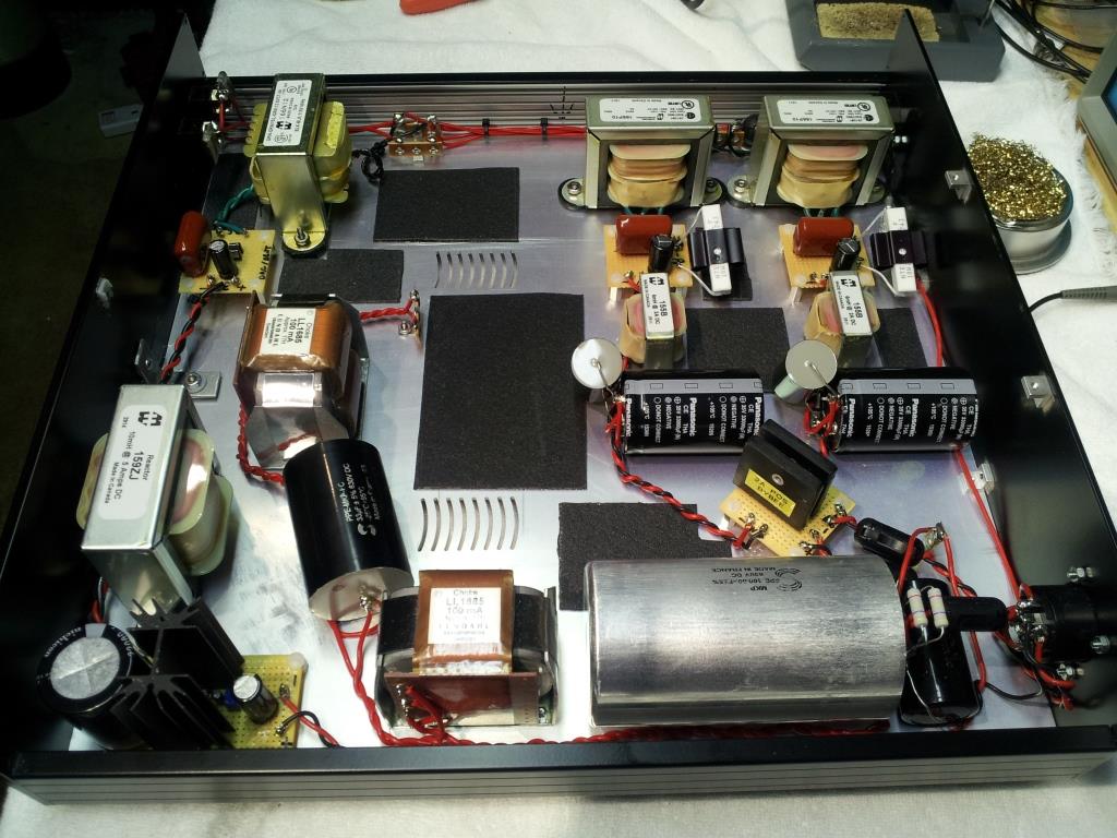

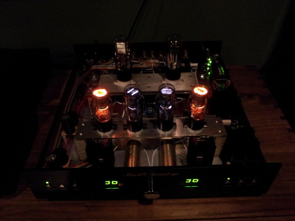

PS. Here are a couple pics of the DAC/Preamp. They are, in order, the completed unit, the DAC/preamp chassis open for testing, and the power supply chassis.
Output tubes are late '20s vintage balloon 26 DHTs. The tubes in front are gas voltage regulator tubes (0D3 and 0A3, one pair per channel to supply 225V to the 26 plate). All PS are choke input with a 5Y3G tube rectifier for the 26 and Schottky diodes for the others. Tube mounting uses vibration-absorbing bushings, mass and dissimilar materials such as wood, aluminum and sorbothane to tame the 26's noted microphonics.
Kind of neat to combine a very modern DAC (with the hot news "Rasmussen Effect") with 1920's-era tube technology. They go very well together!
