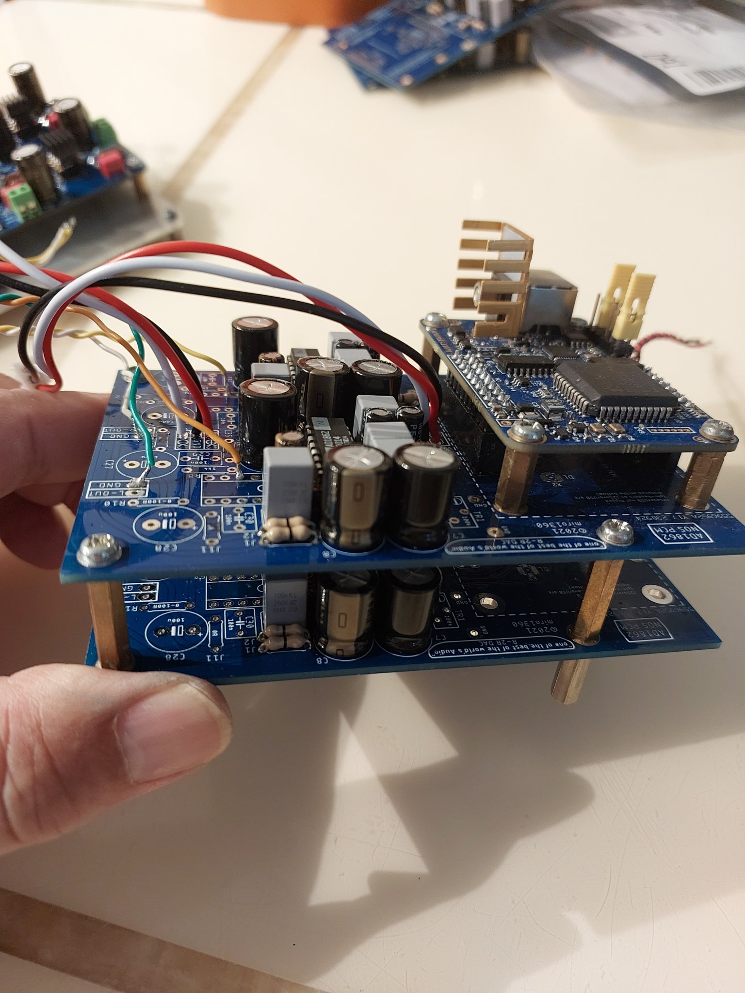

More output current? and on paper , improvement in the THD since bit weight errors is reduced. Not sure if this means I can hear better sound. If i do not like it, i unstack and i try to sell them again. I am trying because i have the chips in my hands now and as you know, MOQ 5 for the boards....

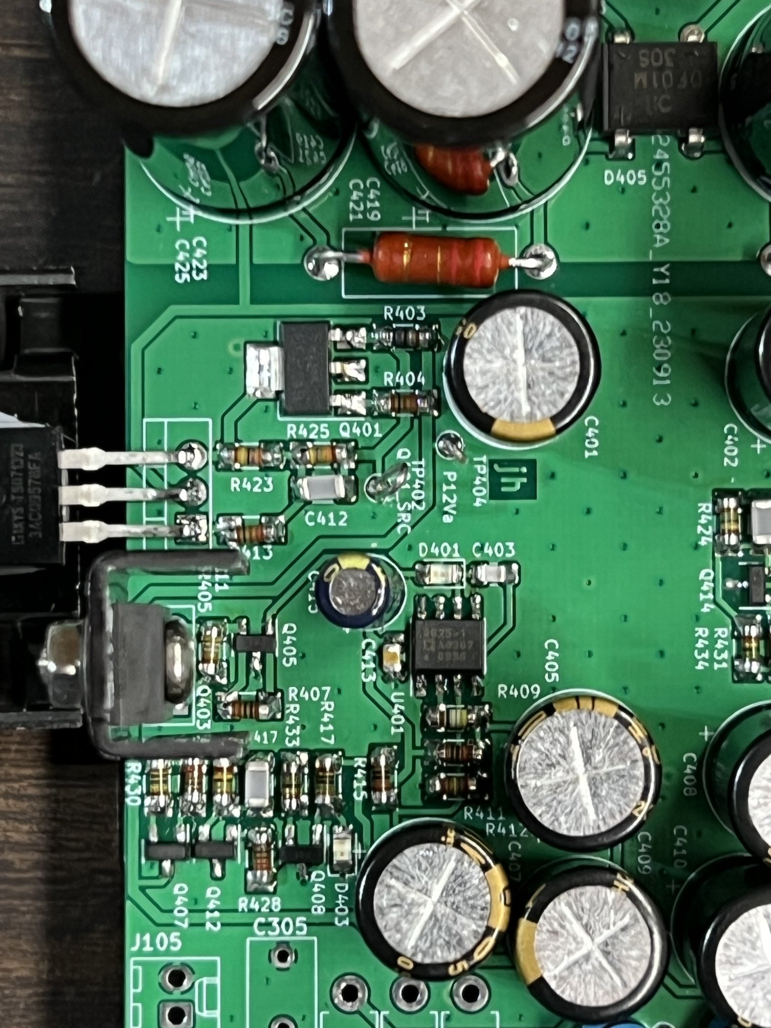

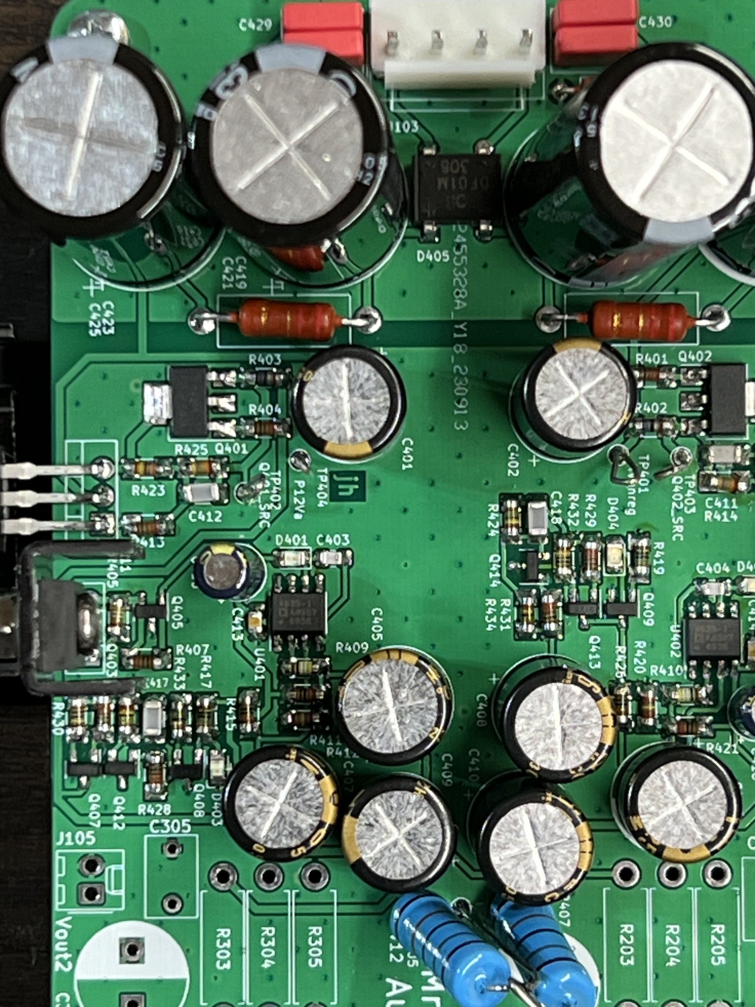

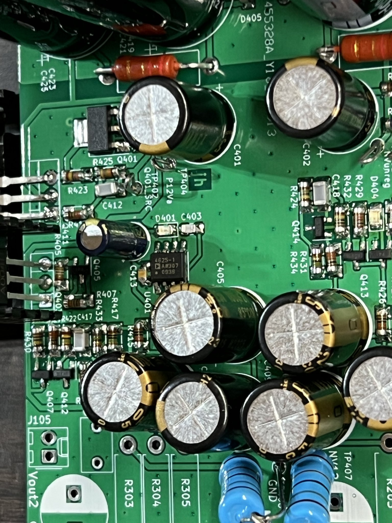

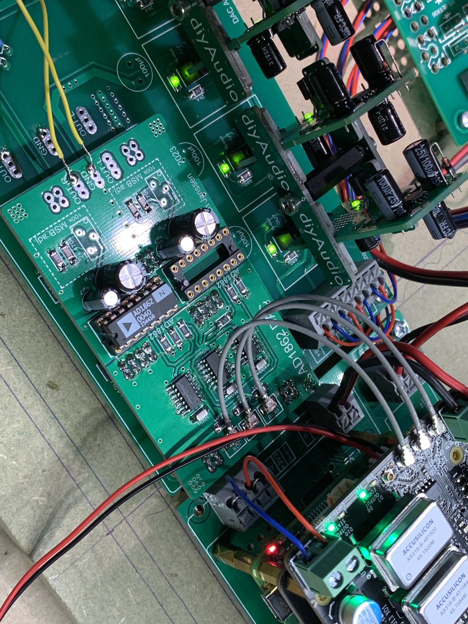

Nice. It inspired me to troubleshoot the power supply on my board.
I was able to get the negative side operational. I'm getting about 9.7mV from the negative and positive of the shunt, but the voltages on are not.
The negative is good at 11.75v, but the positive is 17.5v. What should be my first step to troubleshoot my voltage issue.
I did installed a couple of 180ohm 3w resistors. One from TP405 to ground and the other from TP407 to ground. Also the Q403 and Q411 get real hot.

you must have a short circuit somewhere, do the LEDs light up?zoom,

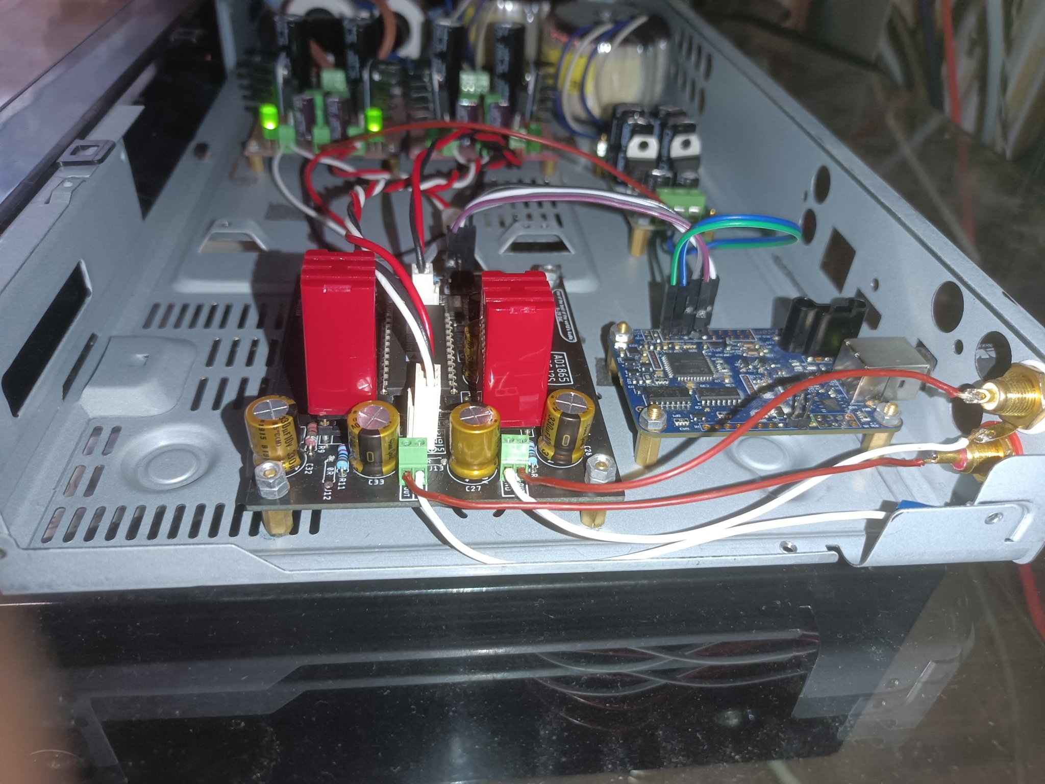

*Pardon the messy set-up. It is for a test run and will eventually case the Dac.

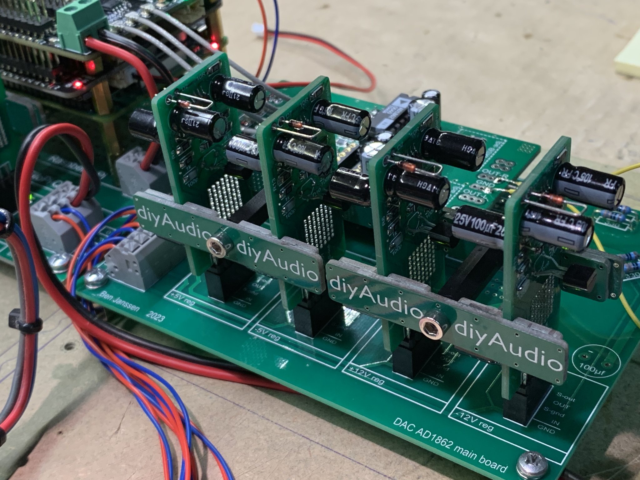

This is such a beautiful instrument. It looks too serious to be just for music!💪Listening to my AD1862 Quick Mock up build. With Pedja Rogic’s discrete IV stage 👌

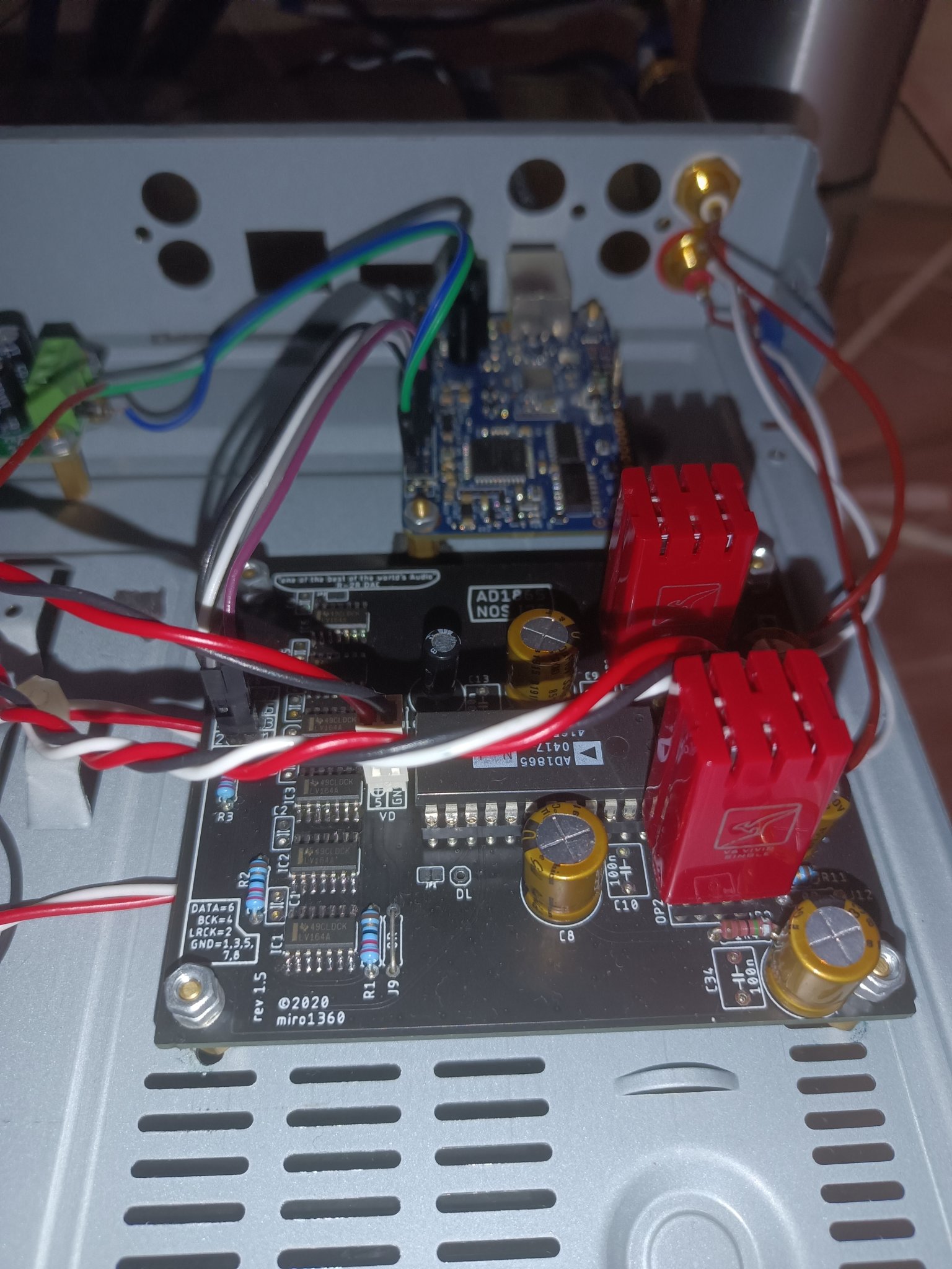

Hi, guys. A few month ago @John Burson wrote to me with offer totake on test his opamps. Of course I said yes, because it's a great opportunity to listen a new discrete opamps from Burson Audio! And the other days I got two new one-channel opamps (V6 Vivid). I was thinking to change in AD1862 but there is a no place for them (they are big) and I changed Opa604 on AD 1865. I was wondering how they'd do the new discretes. after a little work I've started to listening the music. Of course I compared them to 604.
V6 Vivid have more details, separation and wide stage on full display. Sound is warm with a good texture and rich vocal. Very impressive microdynamics and attention to details. Also bass is more extended and rounder. I like acoustic guitar and vocal. There's a lot of different artists for example Allan Taylor and Ian Bruce. Their guitars have become more transparent, natural and fuller.
I didn't realize there could be such a difference between opamps! I'd like to hear in conjunction with the AD1862 but I need to think how to install them.

Thank you for the response. I have not had a chance to check. I will get to it later today. I did not populate the I/V stage yet. I wanted to make sure the power supply was working properly.what are the voltages at PVref, op amp output, current through Q411 (voltage drop at R403)?
