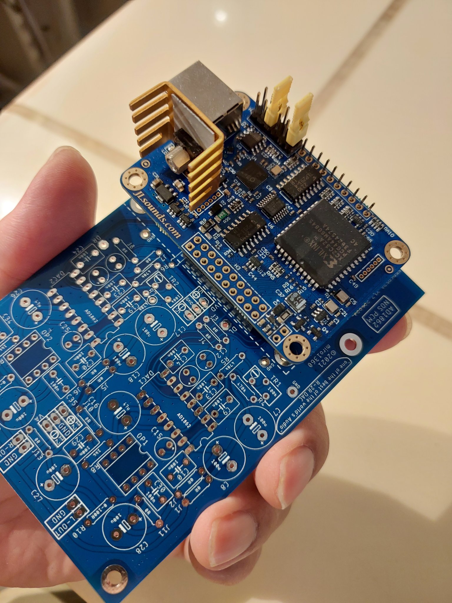

I wish to update that the new JLsounds board will physically fit the AD1862 board designed for it to sit on, just like the older JLsounds board. Inserted with ease, matched. @Sorenm , @Vunce ,@BrijacIs the physical fit onto the DAC board without shift registers preserved with the newest JLsounds version?
Any chance you compared 'PCM1704' direct without registers with I2S and shift registers?

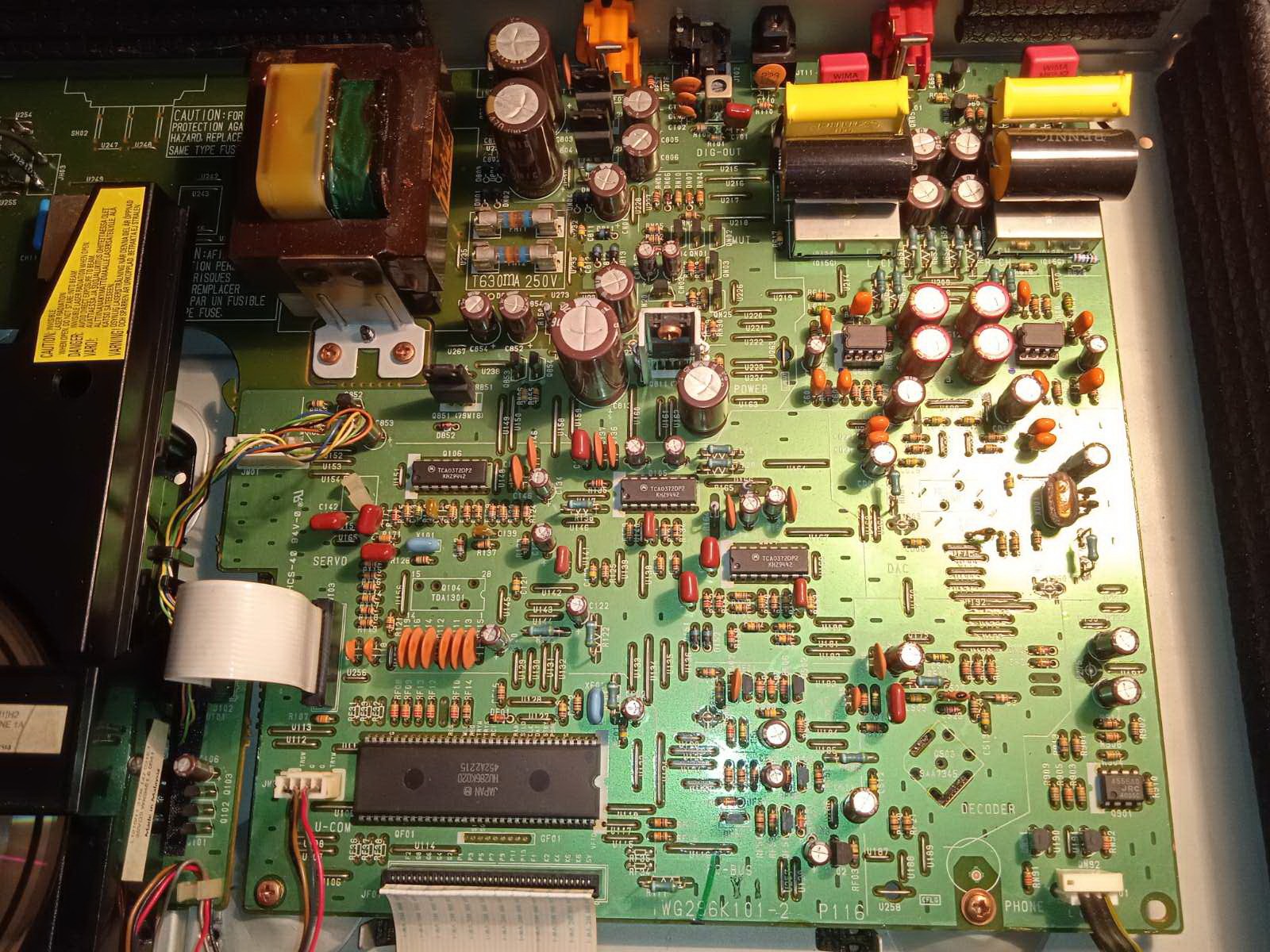

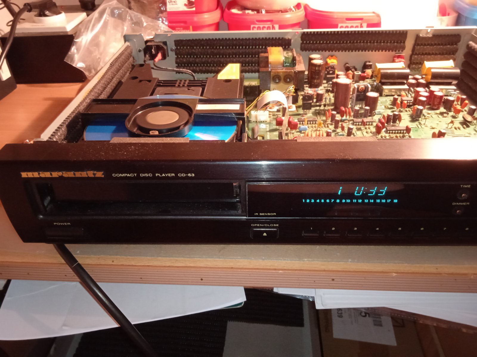

I replaced that Elna caps first in a Marantz CD63 as soon as the warranty ran out. By the way, I also kicked the HDAM module out of the game. That is heavy nonsense. Instead of the original JRC OPAs, OPA2604AQ came here. I put different plastic caps in parallel, replacing Elna Silmic (2pcs back to back) at the output. Just yesterday I replaced that Laser mechanism again, these Chinese VAM1201/2 usually works well, but for a short time. 🤣
It is now an outdated device, but I listened to music quite a bit with it. Then came DDDAC1794 and Pioneer DV300 (modified) as CD transport. The Marantz is listened to occasionally, mostly as a CD transport.
