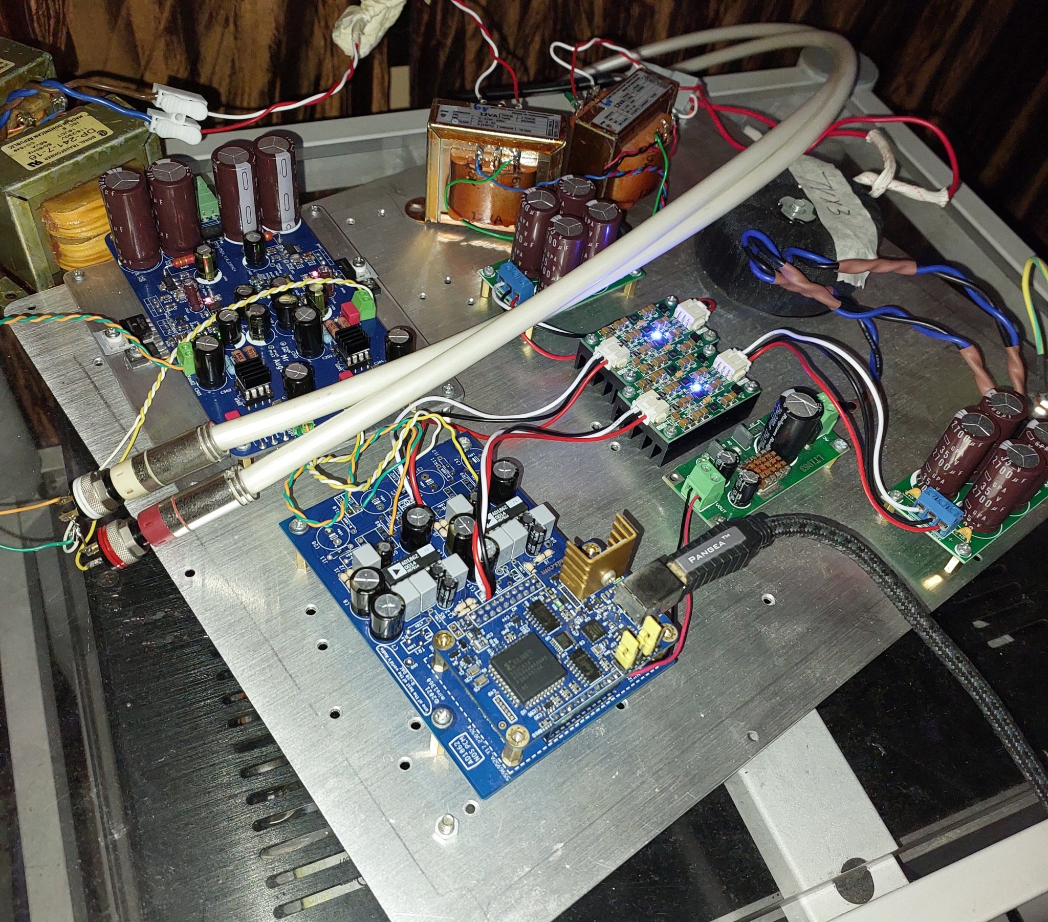

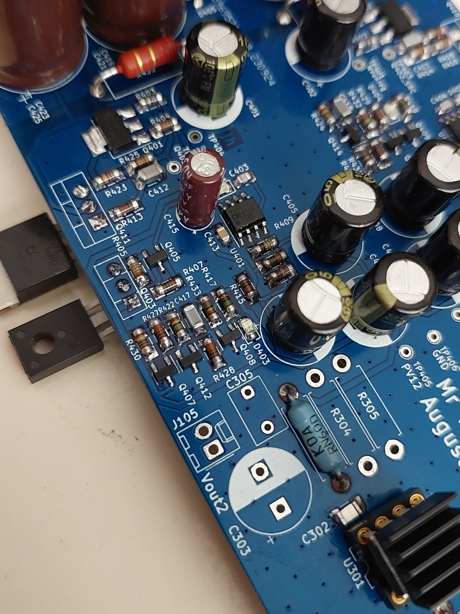

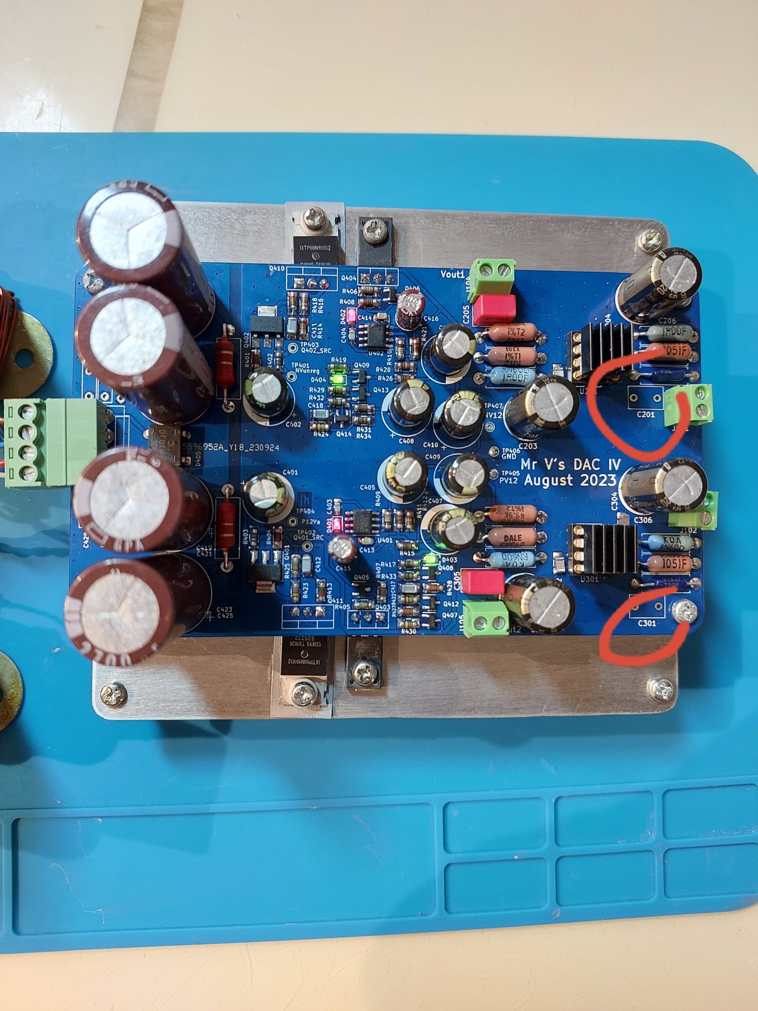

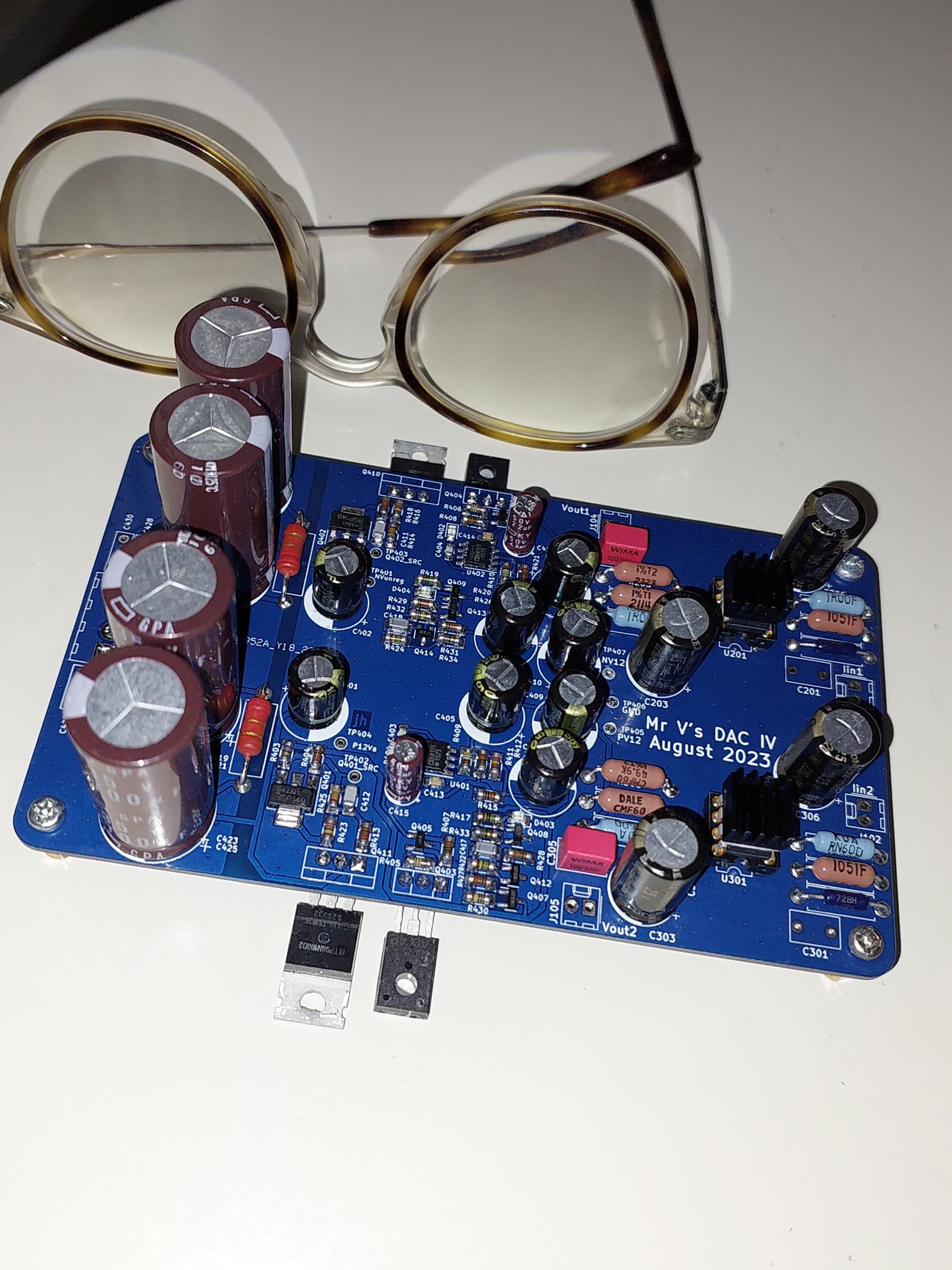

Thanks to Vunce for the beautiful board and support. Powered up and tested all the test points and all measure within expectations. And then a sudden realisation after mounting the board nicely on a piece of aluminium as heatsink - I have forgotten to key into the Mouser BOM list for two caps.... damn. ,😂. Waiting to place my next order and include the two small caps before I would connect to my Dac for music playing.
Note: Although the supply voltage for the AD811 is just below +/-12v, please be reminded that heatsinks are required. These little buggers can get quite warm.

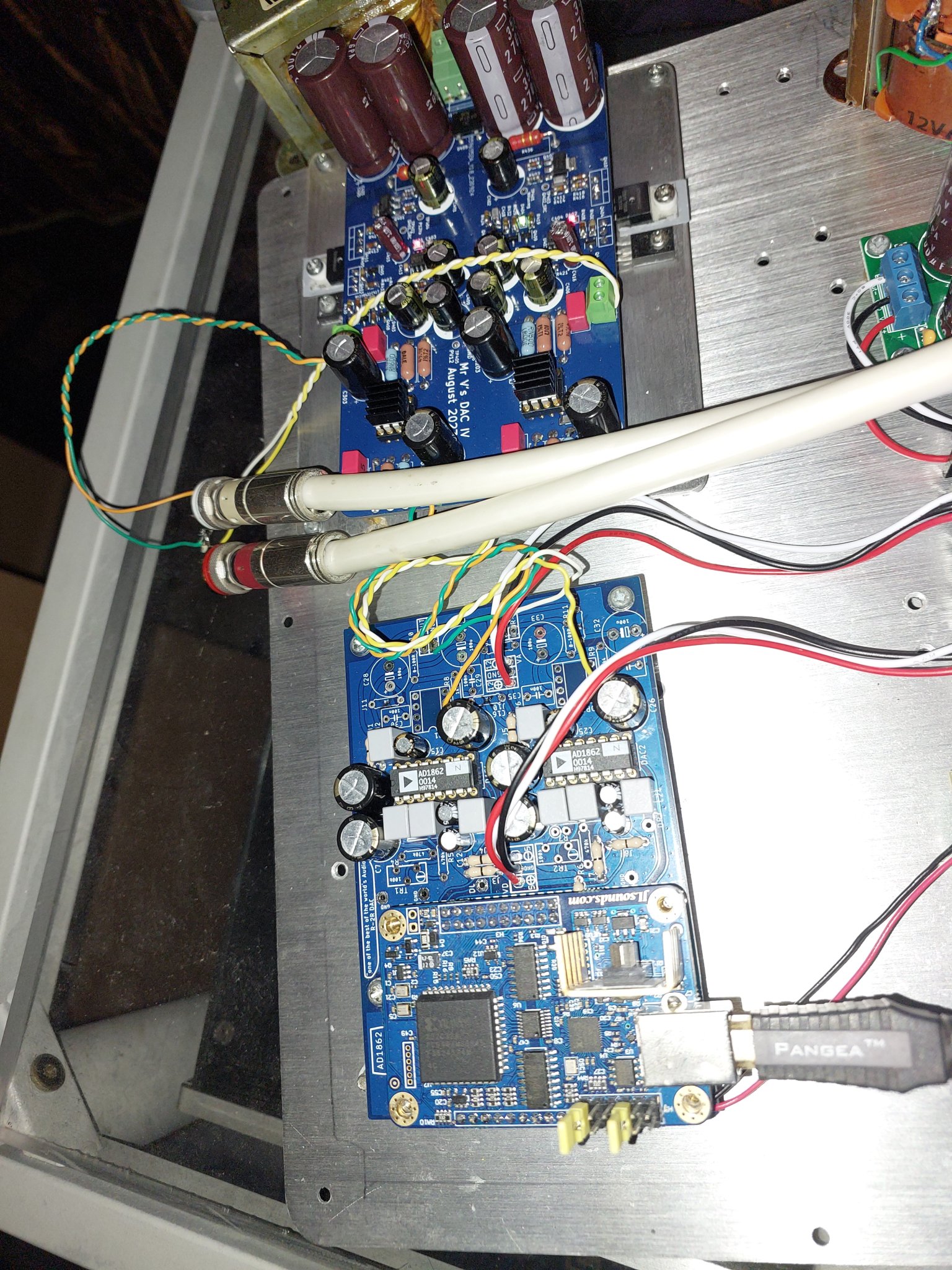

I would think this is the last op amp IC IV stage I would try on my AD1862. I tried Opa1655 , Lme49680, opa2604 using dual to single adaptor board and single op amp like opa604, Ad844 dual stacked, Ad797, ada4267, and lately Opa627. Vunce's IV using AD811 is staying with the Dac. In terms of resolution, may not be as good as Opa627 but the AD811 sounds warm, full bodied especially in the mids and the bass is tight and goes deep. Thanks @Vunce
*Pardon the messy set-up. It is for a test run and will eventually case the Dac.
