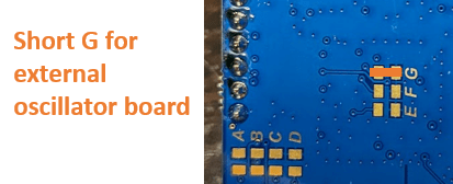

In case someone else will be looking for the answer. I got a note from Lyuben and "G" must be shorted to use the external oscillator board.I wonder if someone here might know the answer... I got an I2SoverUSB v.III board and the matching external oscillator board from Lyuben. In the oscillator manual/PDF, it says "Don’t forget to cut the external clock jumper on I2SoverUSB board", but I can't seem to locate this jumper on the board or any reference to it in the I2SoverUSB manual. Perhaps, this refers to an older version of the USB board? I wrote Lyuben but thought I would also ask here as I am itching to try this out.

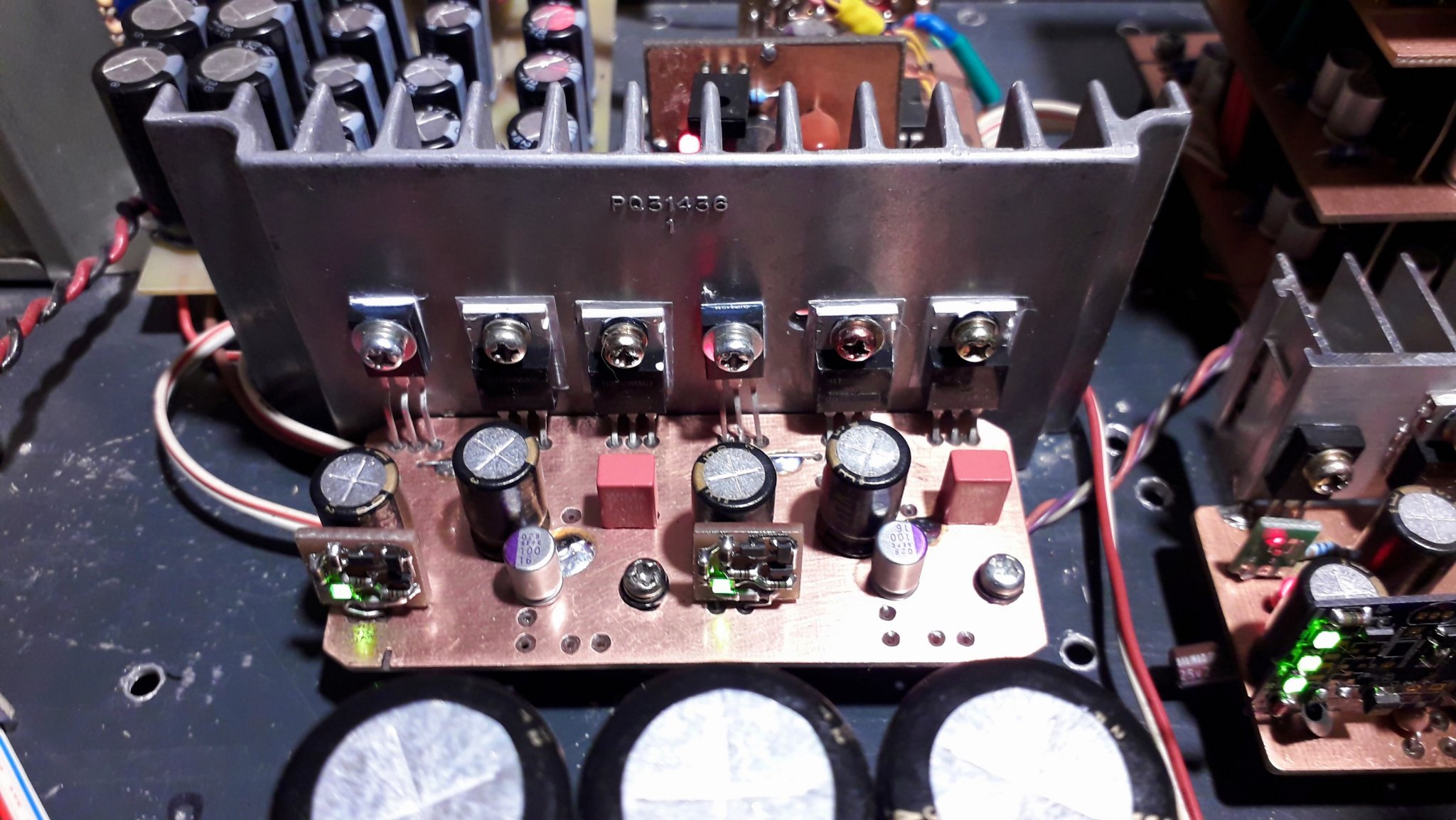

I have finalized what supplies will be used for the analog side of AD1862 and IV stage. (Jung/Grunf shunt regulator)
What is your choice for the AD1862 bipolar digital supply?
Since I’m not using the shift registers and I2SoverUSB will have it’s own supplies, I could use a duplicate analog supply for the digital side.

PSU 2, LT1963/3015.What is your choice for the AD1862 bipolar digital supply?
Vunce, why not simply copy the aya 5 5V supply? It is using ones of the most quietest discrete parts.
If you can reproduce it with the good caps spacing 2 to 2.5 mm gap for inductance, pan FR works fine here for the digital reg. At least for me with thz same shematic layout but classic discrete parts. Those zenet are quiet at these voltages. Try final decoupling with 1 uf 0805 acrylic only at the dac chip pin pan FC for the bigger capacitance us an option over the Fr but different rendering. Up to your hifi chain abd own tastes.
Why complicate it? You completed a quick course on making a shunt regulator so I don't see why you wouldn't make a shunt for +/-5V. This one is a little simpler and cheaper😉.My home warehouse happens to have the Sparkos in stock.
