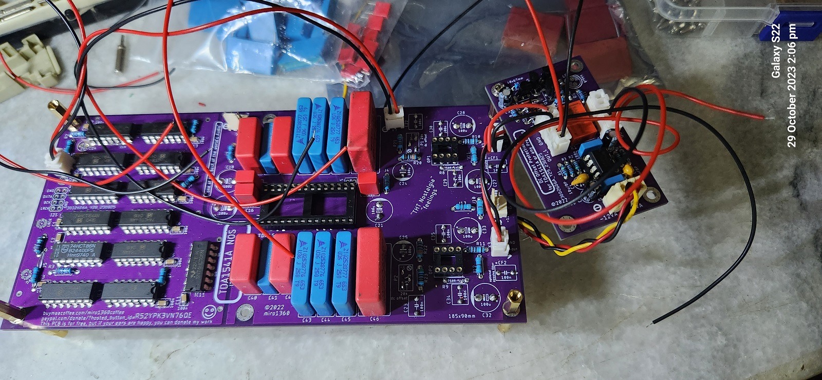

Ahhh... so many ways to arrive at Rome. A single board AD1862 DAC with subsystems (A'la AYA DAC) will have some compromises (circuit topology, size, complexity, parts availability, price, etc...). The thorn in my side is all the different boards connected by wiring running throughout the chassis. For me, a single board will make up for some minor compromises along the way. After playing with MANY MiroDac configurations, its time for a completed project in proper chassis
