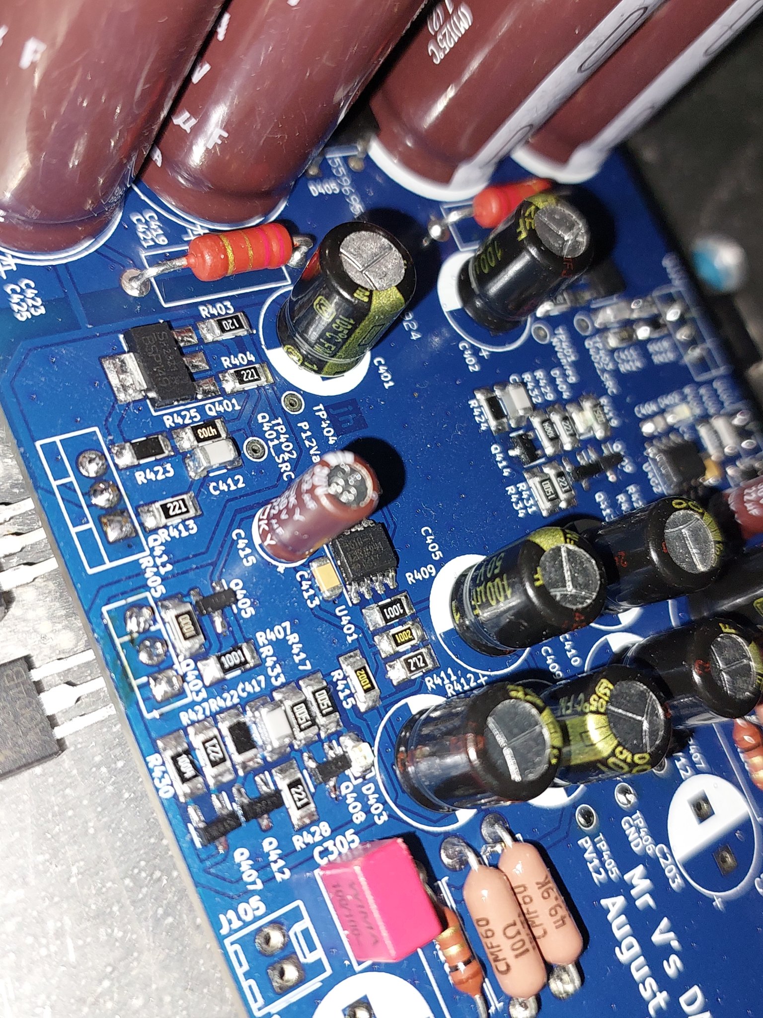

Hi @diyiggy, if I understand correctly, the OPA1655 is the mono single channel of the 1656. Can you tellme why you opted for the 1656 instead of the 1655? I also ordered the 1656 for my build (not yet started) and then realized it may not be needed. Many thanks.
the choice is ruled by the pcb op area layout. If the op areas are made for single channel, choose the op1655. If the pcb is made for dual channel op areas, pick the 1656. Read the BOMs if choosing a ready made diy project.

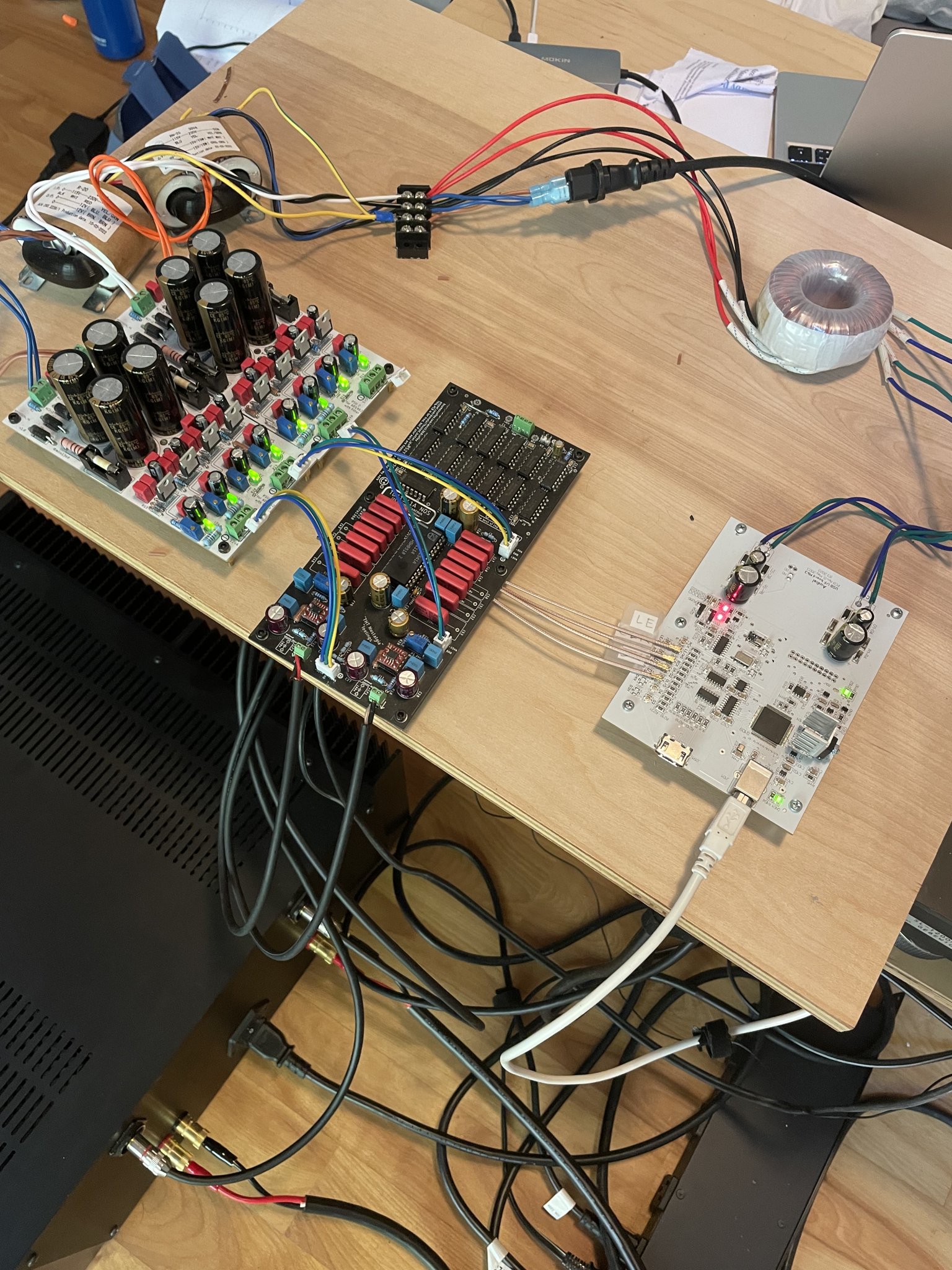

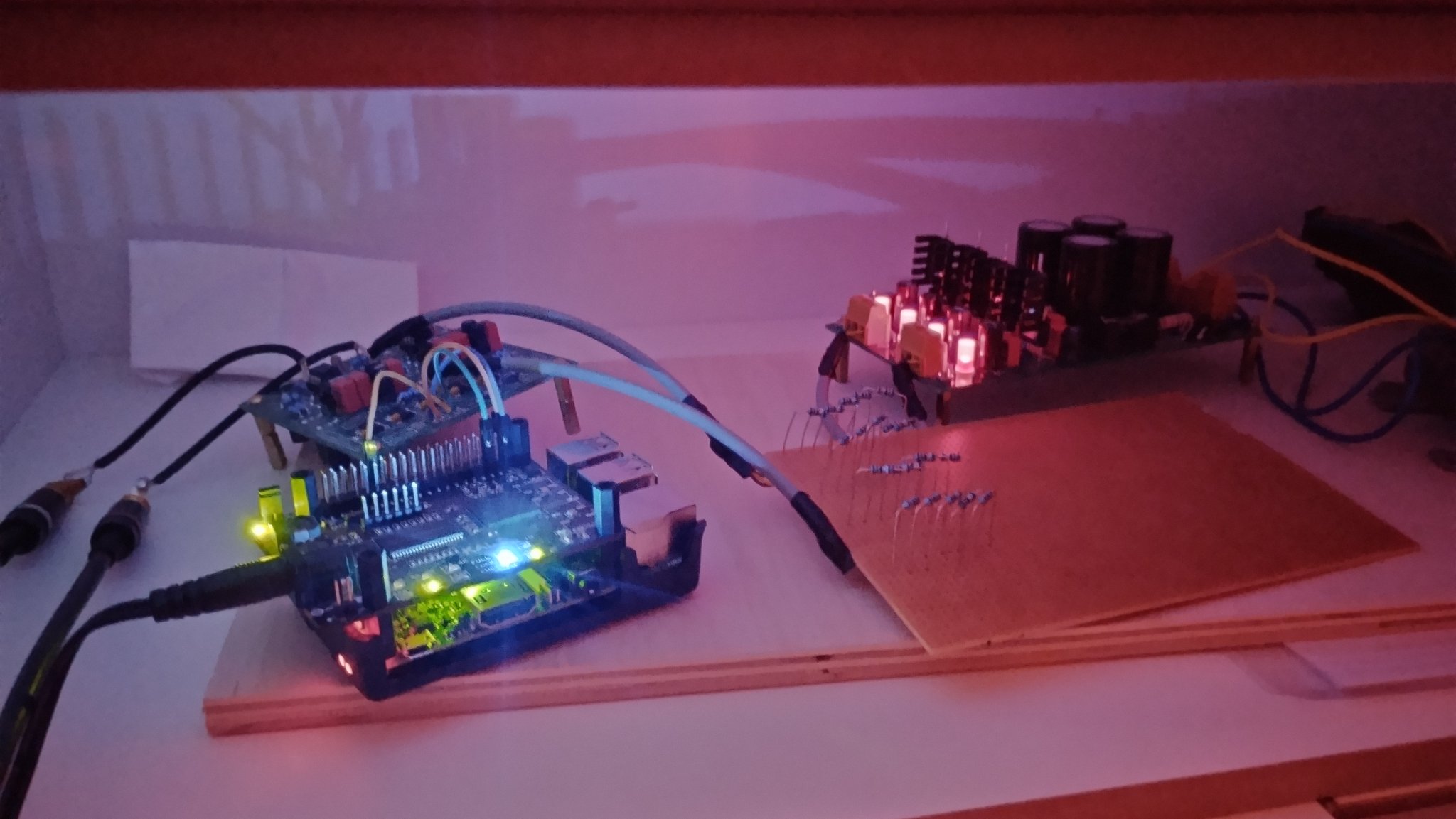

Current plank setup! Waiting on parts for vunces 861, 811, and pass d1. New audial usb to simultaneous sounds really good, especially with asio.
I’ll try it with a c-core. And I haven’t heard an aya. There’s one that I’ve been eyeing though.

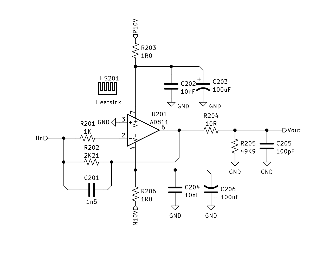

Do you have any recommendation for if I should change the values of 811 IV for TDA1541a?
I plan to use dc offset from miro's board, which should yield +-2ma, along with the values that Vunce is using for AD1862 (+-1ma).
Do you think this will work well or should I make a change?

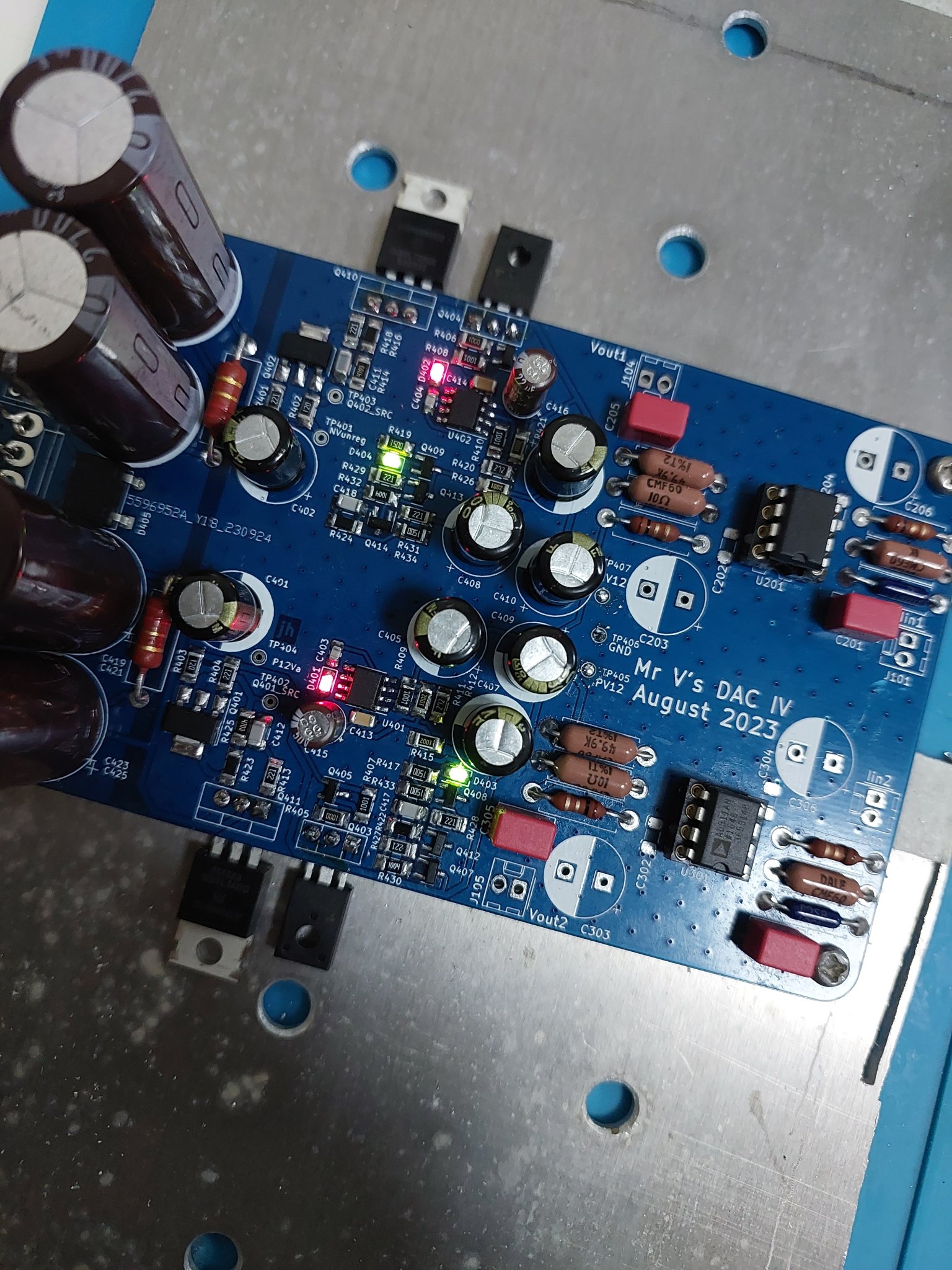

@cibo I'm going to us an OPA1655 for the first pass build but will change to the above AD811 as soon as I get a good power supply built. I'm laying out a Jung/Didden SuperRegulator supply in KiCad right now.
NOW for the big question: In every op-amp based IV stage I see, the DAC current always goes to the '-' input of the op-amp. Does that mean that we are istening to an inverted signal? Or is it inverted coming out of the DAC so the inversion with that IV scheme cancels?

@cibo In the original Walt article for TDA1541 the value of R202 is 1.82K and C201 is 2nF.
Good luck with the build 😉
Although I know that it will be difficult to beat the AD811 in my DAC, I will try to do this at the weekend. It doesn't look bad in LTspice, the only question is how it sounds🙂

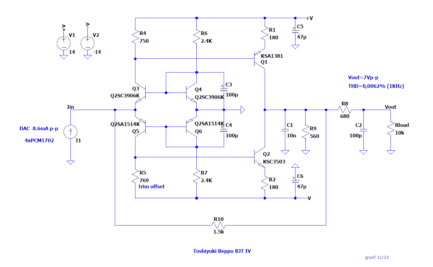

Reactions: zoom777 and cibo
Yes, that's exactly like that because those chips are designed to work with active I/V with OPA.
And when we do a passive I/V with a resistor and add a tube gain stage, or some other gain stage, that stage should also reverse the phase.
I think it can be checked with an oscilloscope, a PC, an online generator and a sawtooth signal that the output is in phase.
