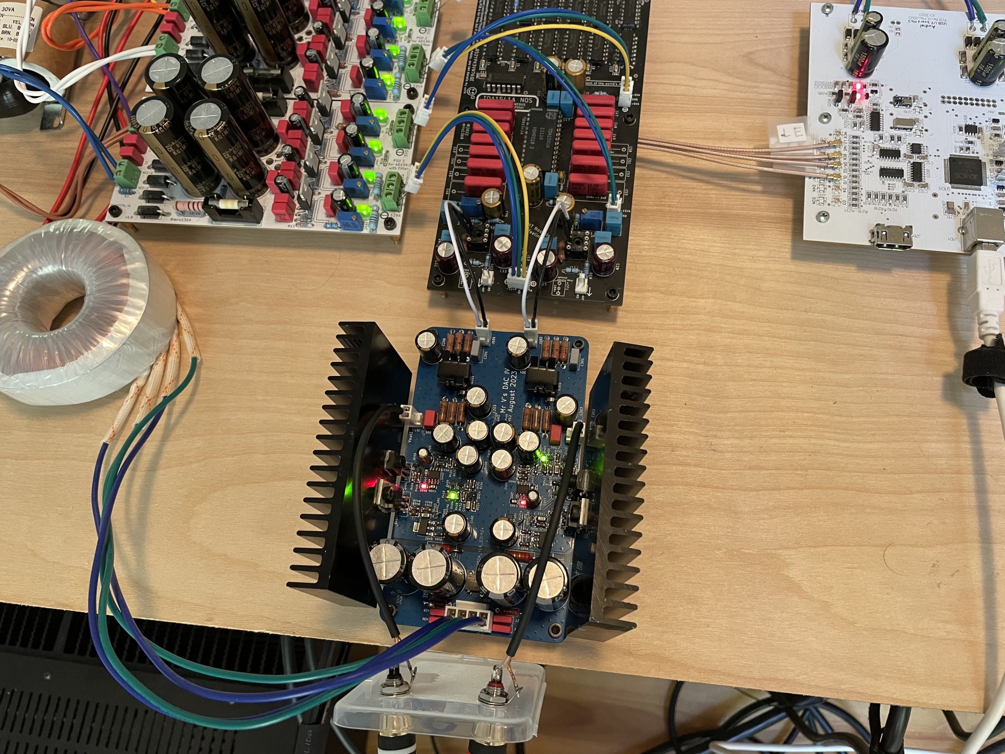

Another 811 build complete!
For anyone nervous about smd soldering I highly recommend the solder paste and hot plate route over hand soldering.
Ive found that the 1862 and 1541 sound better with different opamps/iv’s to me, and the The 627 & 1541 combo has been the reigning champ, but this might replace it. Now I’m curious about sticking superregs more places lol.

The AD811 is pricey for an opamp, but the results are worth it
You could go Chinese for the AD811 and ask yourself "Do you feel lucky?" The ones I purchased seem okay, drawing just under 20mA quiescent. A rare thing for most operational amplifiers and behaves similar to the AD844 in my application. Has anyone compared the two in the same application?

Two quick questions:
Soren
- I am planning to use Sparkos opamps. Those of you that have tried these, or other discrete opamps, did you have C31/36 populated?
- If feeding into a shunt attenuator (for volume control), would it be reasonable to leave off R10/11?
Soren
I prefer Burson V6 (Classic) from Sparkos, tried with PCM63 and PCM1702. For AD1865, SS3601 is better for me because it compensates for the slightly darker sound of the AD1865. C31 and C36 must be inserted, 33-47pF. R10/11 can be replaced with jumpers. I would still put something minimal, say 10 ohms.
Thanks Guys! I guess I can try with and without 🙂

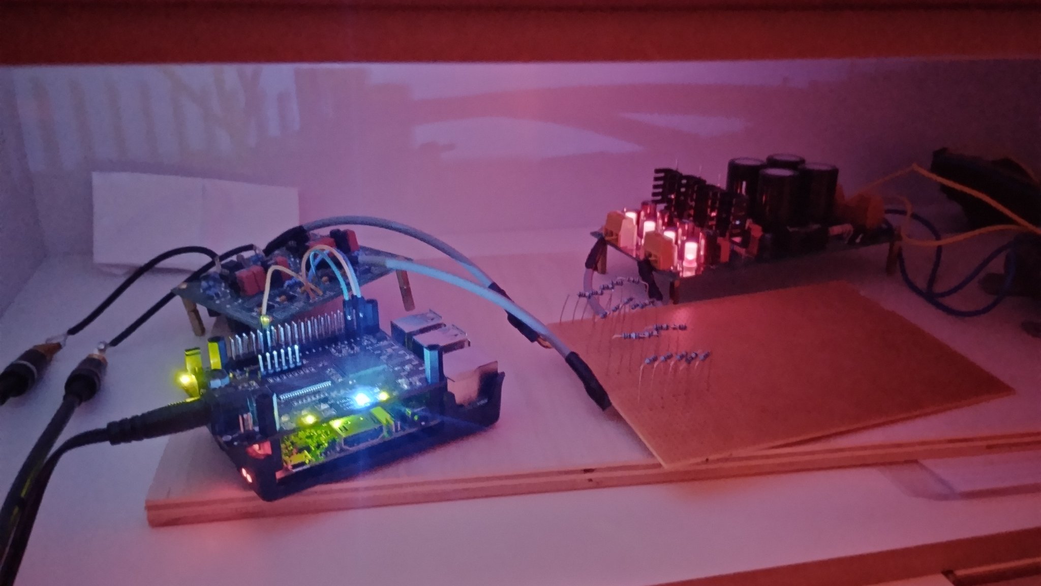

HIAnother one ist alive!
Fed by RPi and Allo Kali. PSU2. Parts are pretty basic.
Unfortunately I forgot to order 2R2 for the PSU, so I had to parallel 5*12Ohms...

What type of Kali do you use? 22/24MHz or 44/48MHz?
Zoltan
Hi!
Thanks!
Actually I am not sure which version this is. I bought it several years ago together with a PianoDac.
If the LEDs are a indicator for the version, it should be the 22/24MHz-version, because the highest value is 192k, but I am not sure about it.
Nevertheless, it works like a charm!
