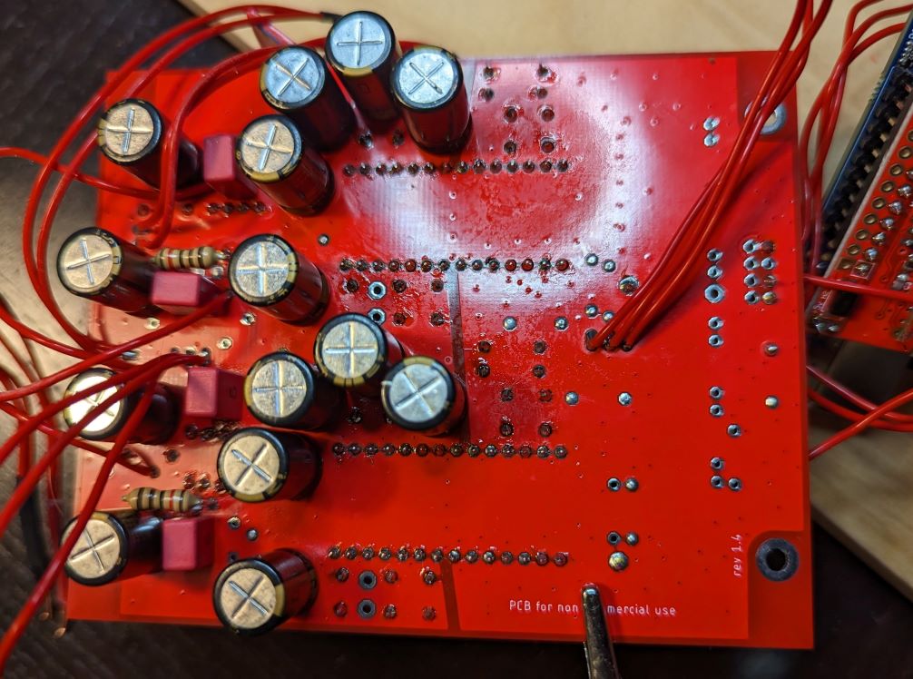

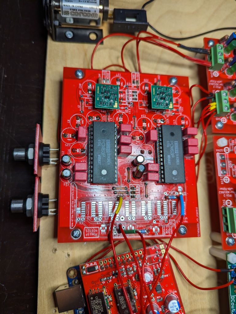

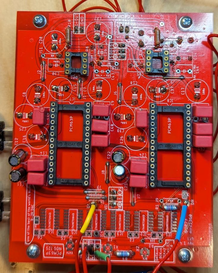

I ordered some new sockets for the chips but wonder if something else is off. Even if a squeeze on the chip made the DC offset disappear and music appear, the offset returned after restarting the DAC. I reflowed the sockets and am uploading a few photos in the hope someone spots something wrong.

Did you merge these two "GND" pins together? #6563 🤔 ... also connect the +-12VA ground to the power supply ...
Did you test the output with a simple opamp? (Like NE5534)
Disconnect power supplies and measure with multimeter short mode each pin of PCM63 (make only slight touch on the pin) with another pin/pad on correspondent component or on the PCB. (do the same for opamps).
Do you have a digital analyzer or scope for directly checking the input pins of PCM63, if data are flowing from the jlsounds? ... if not, you can let the music play and test it with multimeter (voltage - DC or AC) - play music, stop music and see difference.
