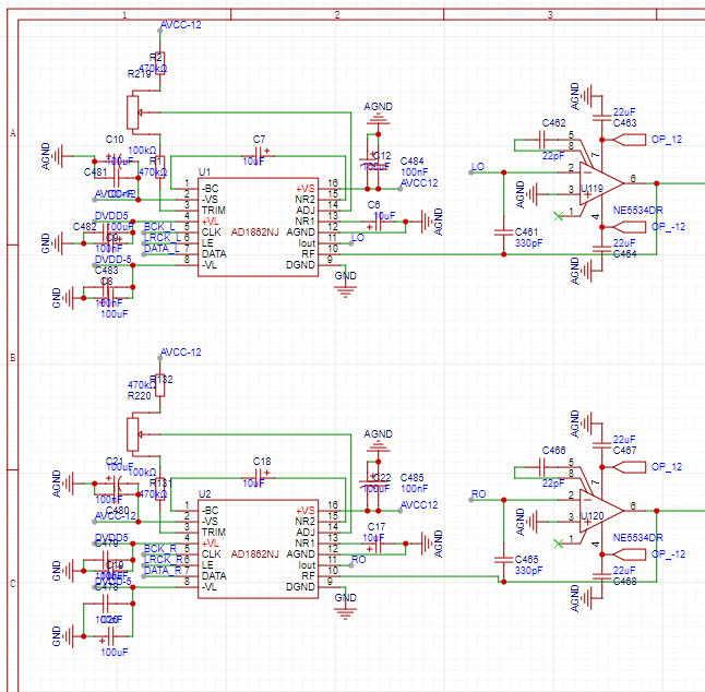

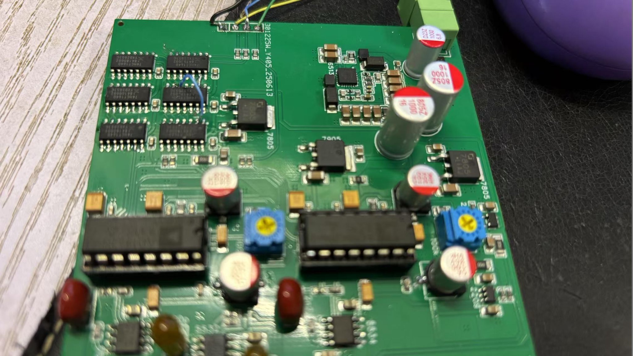

I built a NOS AD1862 according to the circuit diagram in this thread.
But somehow, when I connect it to an amplifier, I can hear obvious "digital noise" at low volume.
It is very quiet when there is no I2S signal input 。。。
Has anyone encountered the same problem as me?

You can post images of your layers/layout. And rest of the circuit diagram. One thing i notice right off the bat is that your c7 and c18 need to be 1uf instead of 10uf, since your c8 and c17 are 10uf. They are to keep ration of 1:10. And they are noise reduction capacitors, could explain what you're hearing.
Thanks for the reply. But I don't think it's C8 and C17 that cause this "digital noise"
I also tried changing them to 1uF capacitors. This "digital noise" still exists

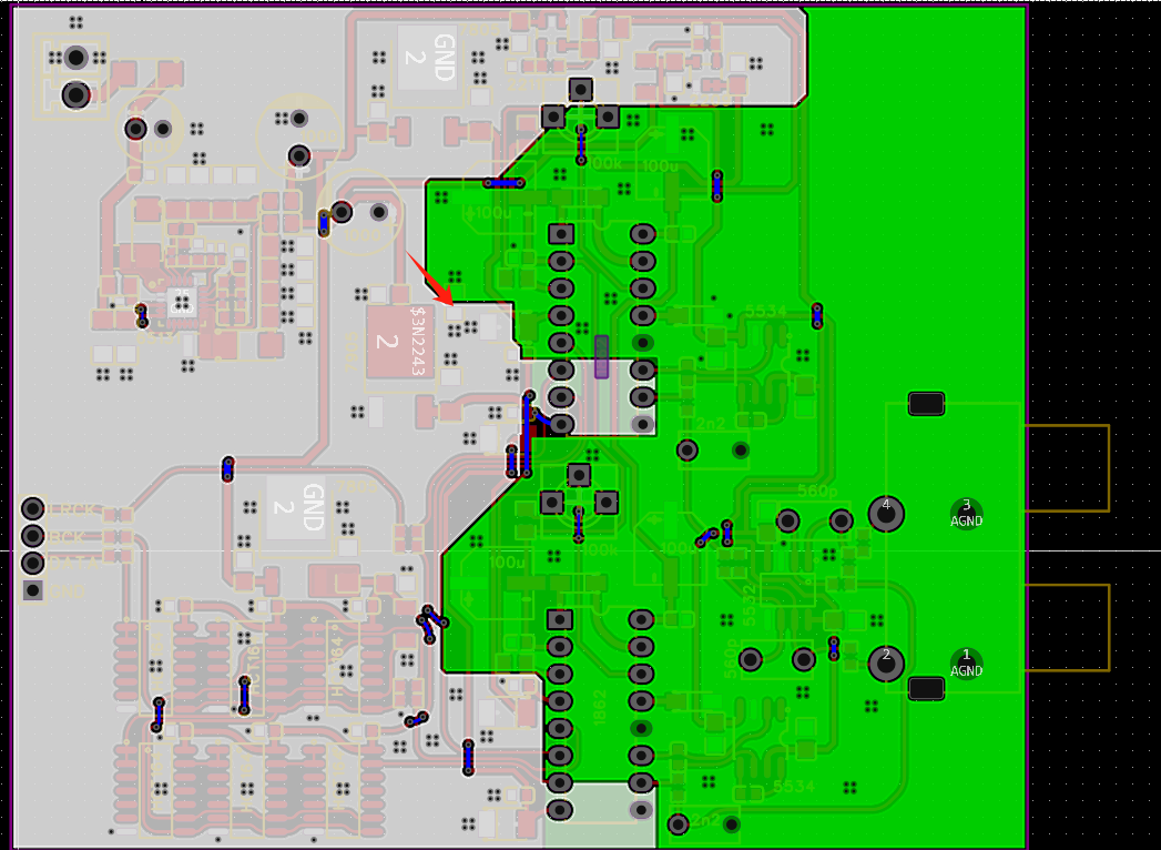

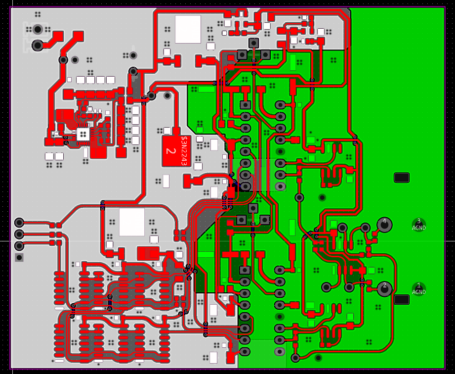

Here is my PCBLAYOUT, thanks!

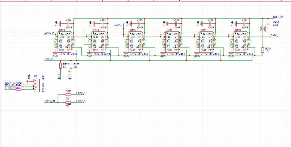

I use xmos to convert USB audio to I2S signal, connect this AD1862NOS test board, and connect it to my desktop speakers through the amplifier.

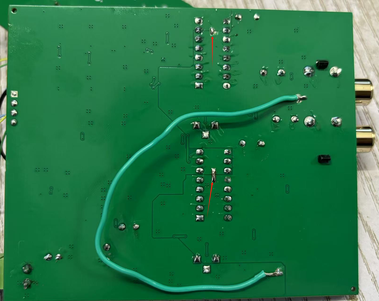

@CNOracle Where did you connect AGND together with GND? You should connect it together under DAC chip. If it is not connected, bridge DAC pin 9 with pin 12 using a thicker wire (under both DAC chips) 🙂
Also remove trimmers from DAC chips because without a proper equipment you can not adjust bits better than factory 😉
Thanks for your reply.
I connected GND and AGND together at the red arrow position through a 0Ω resistor.
If this "digital noise" is caused by GND problems, it should always exist, but in my case, it only appears when there is music.
I will try the grounding solution you suggested.
