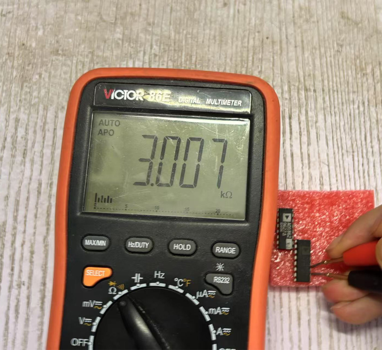

Thanks, It appears that mine are fake, and I have revised my Swap Meet ad accordingly.I took a pair to measure ~ 3.2K on both.

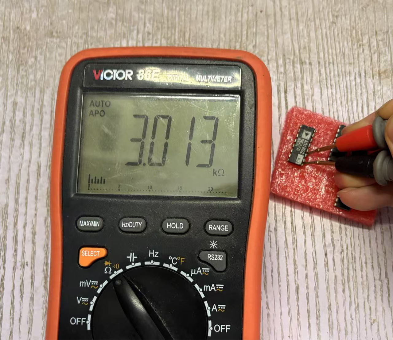

Another pair of different production lot ~ 2.99k on both

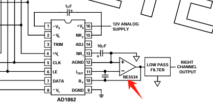

hi,Hey can someone who has a known authentic AD1862 check something for me. I have 2 pairs of chips for sale, but am not sure of their authenticity. Nopants suggested that the feedback resistor (on pin 10 as per the AD1862 Data sheet ) should measure 3K, which is also mentioned in the datasheet. If I am reading the block diagram correctly, I should get 3K between pins 10 and 11, but I am not getting that (one measures 22K, others just measure open). Can someone confirm what they get if they measure a real AD1862?
I can tell you clearly that the resistance value between 9pin and 10pin of the genuine AD1862N or NJ is 3K
I have two different versions of AD1862NJ. For reference
Go to post #1042. Miro posted the resistances across pins.
here are resistances between pins on a working AD1862:
