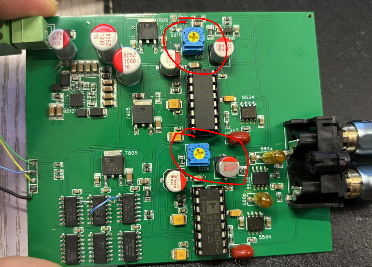

I have a brief look at the picture you gave and I see many crosstalks and coupling everywhere and "isolation of AGND DGND a little odd w/o the "moat" to be so effective everywhere and even usefull sometimes.
But whatever a 2 or more layers, you should not hear with your ears "noises". The layout of the shift registers can be tricky too.

I tried changing the GND connection in many ways, but nothing improved the problem I asked.
If it was a GND crosstalk problem, at least when I tried some of the connection methods, this "digital noise" should have improved. But it didn't!
Sorry for my poor English.
This "digital noise" is a bit like distortion in the high frequency part. At lower volumes, it makes the high frequencies very sharp and very obvious.

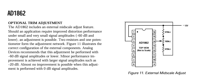

Friends. Sorry, I'm not sure if I made a stupid mistake.
Just now, I improved the "digital noise" problem I mentioned by adjusting the AD1862 "OPTIONAL TRIM ADJUSTMENT"! !
I always thought that this adjuster would not bring such obvious "low volume distortion", but the facts tell me that it does! It can significantly improve the "low volume digital noise" I mentioned, at least it is completely gone now. The sound of NOS AD1862 is very real, I like it!
I am very curious, how do you adjust this potentiometer? Use a distortion meter or an oscilloscope?
Yes, even w/o you should have no noise you can check with ears. A carefull read of the thread aka RTFM philosophy is a must...
