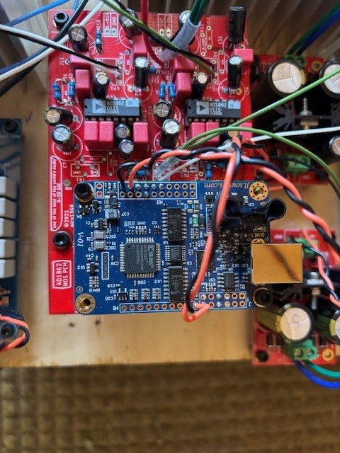

@eclipsevl You know how they quaranteed this specification on AD1865. They made testing on slower BCLK, only 18-bit FS LRCK (768 kHz * 18 = 13.8 MHz for BCK) - only mono.
So does the AD1862, 16x oversampling in datasheet ... that is 768 kHz * 20fs (only mono) = 15.36 MHz for BCK
One thing, it is states it's minimum clock rate 13.5Mhz for ad1865 😉 So they left quite a large questwork of maximum frequency. In ds, figure 13, there is 16.9344Mhz xin with cdx1244 digital filter. So higher is definitely possible.
Fired it up. Plays music. But only through the Left channel. Measured AC voltage out from the D1 RCA's out, I can see a half volt on the left and negligible on the left. Thinking I may still not have the JLS I2s over USB pins correct.Thanks @zoom777 and @eclipsevl. Added Pin 9, removed J4 and closed J3 and J6. Now on to fixing the negative rail of shunt regulator powering D1 output, the final task before first full fire-up. Appreciate your help!
