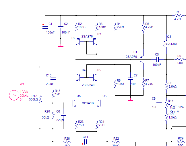

To clear up, the schematic I posted while "discussing" things with Glen is Ostrippers amp, with the third transistor added to the existing mirror. The way that OS illustrates in another schematic on his thread would not work in simulation.
For reference, the pertinent parts of mine is below.

I'm not entirely sure if you are talking to me or Colin.😕
Sorry if i came in a little strong. I was responding to something I may have imagined in your post.

Yes, this was the way I implemented it For a lower beta VAS the helper's emitter resistor should of course be made smaller. Obviously it helps to know the hfe of each device and the magnitude of VAS and LTP currents.
The helper transistor collector current is set by the vbe of the current mirror control device + the voltage developed across its emitter resistor.
I agree though that a few uA one way or the other is not an issue but if you know the hfe of each device then it's pretty easy to select the closest 5% resistor value to get the LTP currents very closely balanced. You might also want to balance the current mirror collector voltages by some manipulation of VAS emitter resistance and / or VAS quiescent current. It stands to reason that the current mirror devices will track better if their operating conditions are made equal (ie. both VCE and IC), particularly if you've gone to the trouble of matching them for hFE at the selected operating current.
Whether you consider going to such lenghts to be really beneficial is another issue but there do seem to be a number of people looking for the perfect mirror. For myself, perfect mirrors are something I've stopped looking into.

By MJL -To clear up, the schematic I posted while "discussing" things with Glen is Ostrippers amp, with the third transistor added to the existing mirror. The way that OS illustrates in another schematic on his thread would not work in simulation.
It did work, but "squirrely" .The CM emitters are better at
under 220R (eliminated my offset bias "window" as well).
I've am playing with LTspice (thanks again to lineup)🙂
and am able to approximate any changes "before the fact"
eliminating the stress of possible real world failure.
