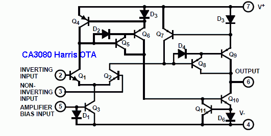

Below are the 'LTP' Current Mirrors used in CA3080 by Intersil.
The operational transconductance amplifier (OTA) CA3080 needs very good mirrors to perform well.
For D3 in schematic should be used transistor in diode mode.
D2 and D4 are so called 'speed up diodes'.
They are attached backwards from current flow.
The Mirrors output uses two transistors in Darlington.
Litterature: CA3080 PDF from Intersil

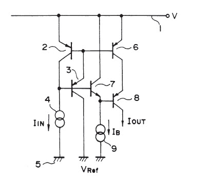

homemodder,
I started collecting these years ago when I was on the hunt for a mirror that was better than the basic Widlar (which I consider marginal at best).
I think we can safely say that we has seemed to have narrowed it down to three topologies though the Nakamura above might be worth investigating.
More stuff to drive you crazy....
http://www.google.com/patents?id=ev...537&source=gbs_selected_pages&cad=1_1#PPA1,M1
http://www.google.com/patents?id=fX02AAAAEBAJ&printsec=abstract&zoom=4&dq=5283537#PPA1,M1
................and one for the totally insane. :yikes:
http://www.google.com/patents?id=MRMwAAAAEBAJ&printsec=abstract&zoom=4&dq=5283537
Regards
Jam
lineup,
The Nakamura seems worth investigating (maybe homemodder would be kind enough to run a sim for us) the others are just over the top.

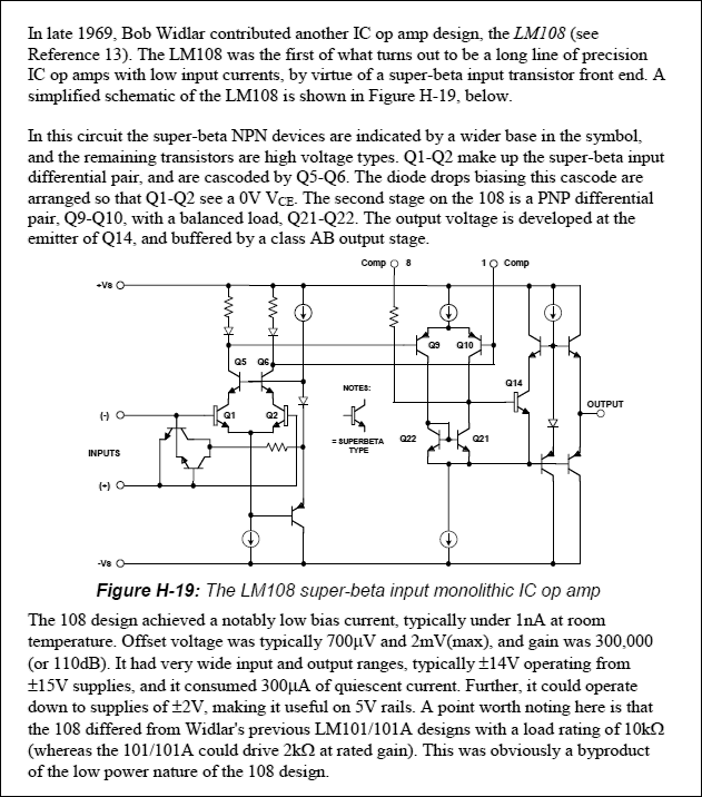

andy_c said:
In a competent design with emitter degeneration of the input stage, power amp input stage distortion at full power, 20 kHz, can be improved by a factor of 10 or more without messing with the mirror at all.
Just do a bootstrapped cascode a la Widlar's design of the LM108.
thanks, andy_c 🙂
Bob Widlar has given name to among other things, one current mirror.
Bob Widlar uses no mirror in input stage of LM108 (1969).
See attachment.
This is a very low supply current opamp, 300uA !!! ( 0.3mA ).
Using super beta input transistor pair, which needs to be cascoded.
I find LM108 to be an elegant amplifier 😎
