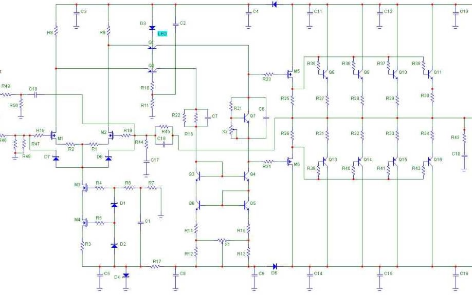

I like the four transistor Wilson which I have used in one of my amplifiers (see attachment)designs. This topology is also used in The AD844 and AD829 opamps. and works great on one end of a folded cascode.
I will have to try the patent version, we might be on to something here. When you say three transistor Wilson and Widlar do you mean a stantard Wilson with a cascode on the input side or a tree transistor Widlar with a cascode on the output side ( This works real well as it limits the heat generated on the output transistor hence reducing non-linearities this might be one of the reasons that the patent circuit works so well)?
