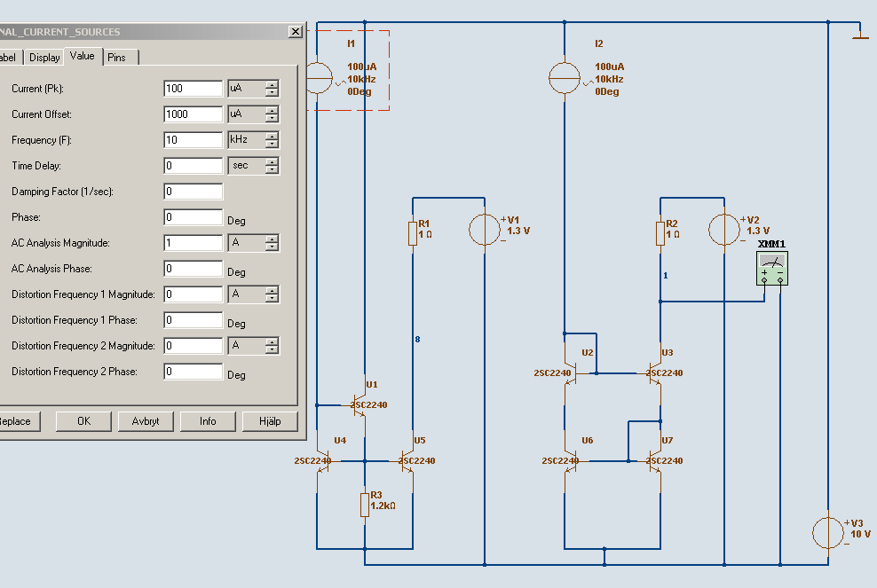

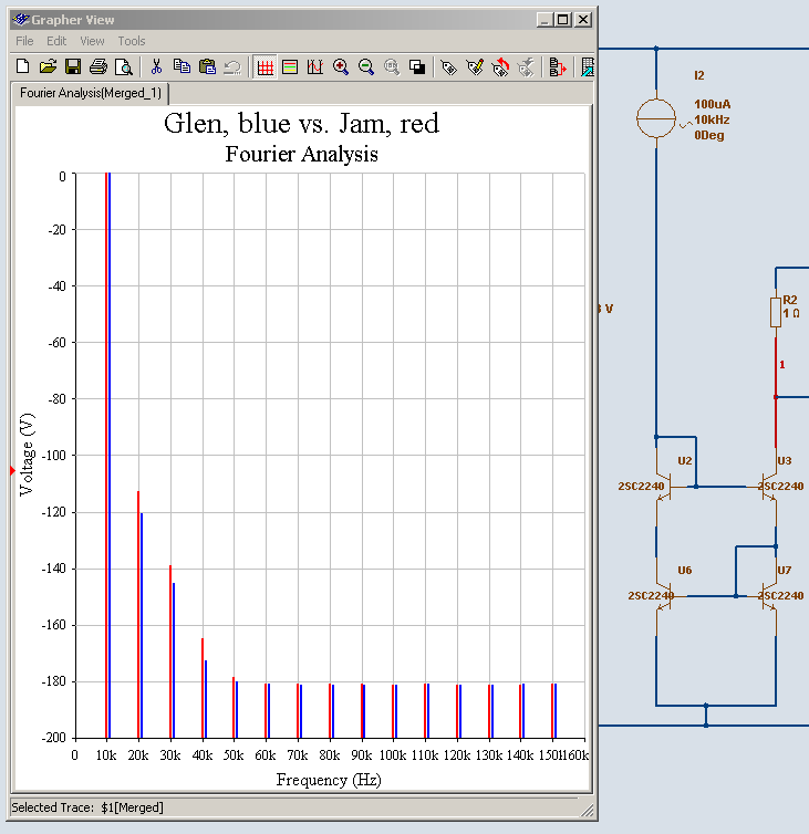

One comparing sim test of current mirrors.
I will refer to the left one as 'Glen mirror'
and the right one is 'Jam mirror'.
The condition for this compare is:
1000 uA, modulated with +-100uA 10 kHz
Output is at 1.3 Volt, as for a darlington VAS.
We can not say one type of mirror is best.
We have to consider the circuit.
Like if the output is taken at 0.65, 1.30 or much higher voltage.
The Glen mirror performs a bit better here.
One natural explanation is that U4/U5 both work at 1.30 Volt level
while U6/U7 only works at 0.65 Volt level.
I say, in compare with other options, the Jam 4 Transistors mirror
is a very good mirror alternative.
Surely one of the best 😎
How much current in U1, set by resistor R3 will effect the distortion.
in this case the optimal value is ~1200 Ohm, which gives a current like 500 uA in U1.
This is 50% of 1000 uA, in U4/U5.
I do not know if this 50% is some general ratio. It does not have to be.
It may be, that at ~500 uA the U1 will start to perform well.
I post the Fast Fourier Analys in next post.
