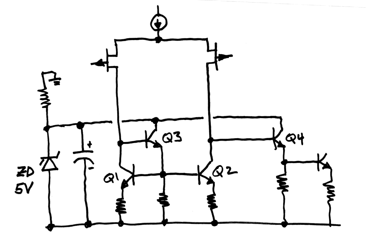

... the helpered arrangement allows the operating voltage difference between the collectors of the current mirror to be very small. That, in turn, allows the use of diode clamps across those collectors, which can improve overall behavior in clipping, including some reduction in sticking. That also can reduce the peak current in the VAS helper transistor under clipping conditions.
Yep. BUT the diode clamps across the collectors steal some of the tail current during slewing, so the actual slew rate is less than Solomon's equation predicts (SR = Itail / Cc). In my experience the clamp diodes divert about 20% of the tail current away from Cc, so the observed slew rate is approx 80% of the theoretical value.

What's the transfer function when you apply an AC voltage on Q3's collector and measure the resulting AC current flowing in Q2's collector? Emitter followers do have quite high PSRR; perhaps the effect is completely negligible.
I predict you'll find (Iout/Vin) is teeny tiny.

Bear in mind that the Zener diode is bypassed; that will reduce the noise a great amount anyway. The corner frequency of the resulting low-pass filter should be at about where the dynamic impedance of the Zener equals the reactance of the bypass capacitor.
The noise should not matter much in this particular application, but if the resulting reference voltage is used as part of a current source (such as an LTP current source), it might matter more.

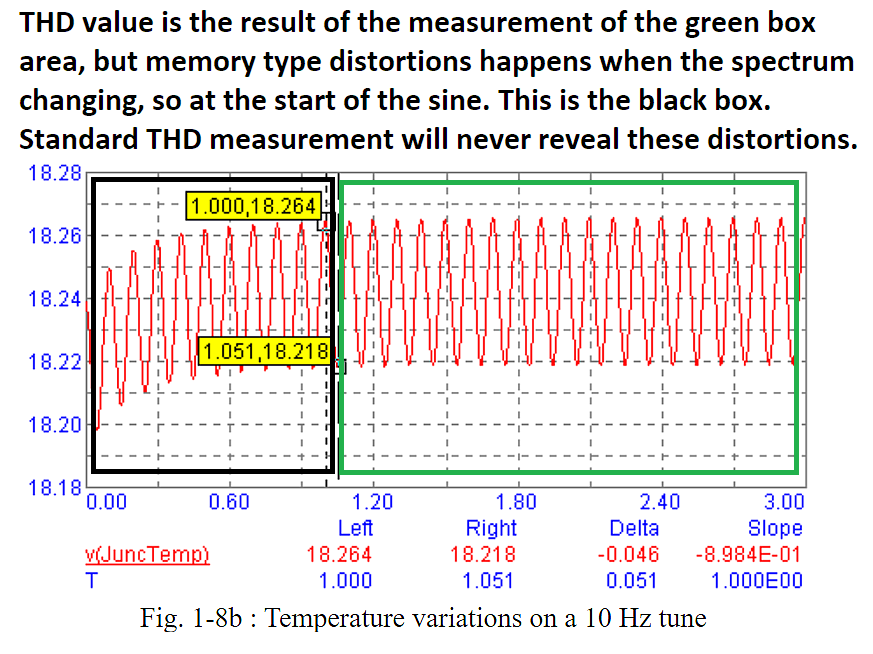

Music has constanly changing spectrum. Sine has a constant spectrum. Two sine (IMD measurement) is a constant spectrum signal. DIM, TIM are also constant spectrum signals.
With listening tests one can differentiate between good and bad sound amplifiers while by using only standard measurements one cannot.
Please see the attached image. In reality, when listening to music, we 'examine' the black boxed area shown in the attached image with our ears. On the other hand, for THD, IMD, DIM, TIM, SINAD measurements, we measure the green boxed range where there is no more memory distortion. In this way, there will never be a correlation between listening and measuring. Something else needs to be measured. The linked french article is an excellent example for alternative measurement that correlates with listening.
You are now conflating general memory distortion with LF thermal distortion, which is a specific subclass of memory distortion that is possible to characterize using THD.
Yes memory distortion is often swept under the carpet, partly because there are few standards for how to measure it meaningfully - many effects of memory distortion are outside the audio band, basically slow recovery graphs after the load is removed are usually effectively DC and irrelevant to audio amplifier performance. You can measure it if you want. A simple DC servo may remove this effectively.
Throwing of bias point during heating up and cooling down is a much more important memory effect and many people spend a lot of time trying to improve bias stability for this reason - if the amp gets tricked into under-bias by changes of loading then the thermal management needs improving. There's a whole chapter about this in D Self's book on amp design.
That's an assertion you want to be true. Have you tried to prove it? Or are you saying simply that some people don't test THD during load fluctuations - which, yes, is an omission.
