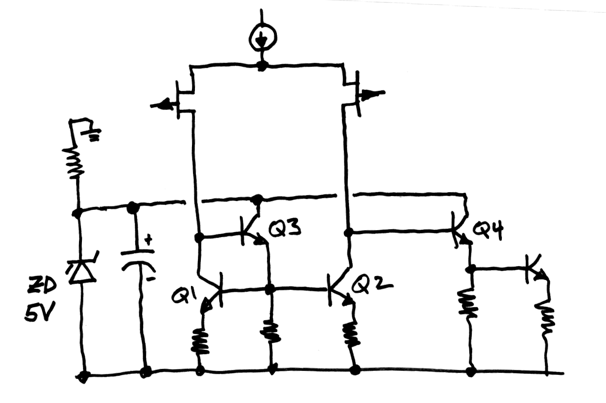

Spend the money to buy 3 extra parts (drawn at left) and get improved PSRR for your trouble. All four transistors Q1-Q4 are the same device type: low voltage, high Beta, high fT, low capacitance parts.
So then it's one of the possible options I mentioned earlier. An extra separate biasing network from the cascode, but shared by the helpers from both the mirror and vas.
Easy enough. Thanks.
Maniacs will use Nchannel MOSFETs in positions Q3 and Q4 since this increases LF gain still further. The 2N7002DW dual device matches pretty well in practice, even though there's no datasheet guarantees on matching. Buy ten duals (total cost: $2.16), test them all, select the one with best matching.

I agree.
Furthermore, in some cases, depending on the type of tail current source arrangement used, a relatively low-voltage reference that is with respect to the rail is needed anyway. One should not be foolish to save a couple of parts, and be careful when sharing voltage nodes among numerous functions. Make sure bypassing is good, that enough voltage node current is available, and that fault situations are handled gracefully. In some cases, for example, the VAS helper transistor can draw a lot of current in clipping or in a stuck rail situation, since the VAS transistor will be in saturation.
With respect to quasi-saturation it is important to keep it in mind, although with the IPS current mirror transistors running at only 1-2 mA in the helpered mirror it is not usually much of a problem. It is more of an issue for the VAS transistor. Having said that, if one uses low-voltage transistors with good quasi-sat performance in the current mirror, there is no need to use the same low-voltage transistor for the helper. It is easy to find good helper transistors with voltage ratings of 100V or more.
As I pointed out in my book, using a helpered current mirror with a 2T VAS is a good thing because now the two transistors in the current mirror are operating at about the same Vce, which also mitigates any quasi-saturation that does exist. The ordinary current mirror, with Vce only 1 Vbe, is far worse in regard to quasi-sat than the helpered one. That extra Vbe in the helpered version can make a very big difference with respect to quasi sat.
If you play your cards right with respect to emitter degeneration voltage drop in the mirror and the VAS, and systematic Vbe differences between the mirror transistors and the VAS transistors, the helpered arrangement allows the operating voltage difference between the collectors of the current mirror to be very small. That, in turn, allows the use of diode clamps across those collectors, which can improve overall behavior in clipping, including some reduction in sticking. That also can reduce the peak current in the VAS helper transistor under clipping conditions. This approach was illustrated in the DH220C amplifier I presented at Burning Amp last November.
