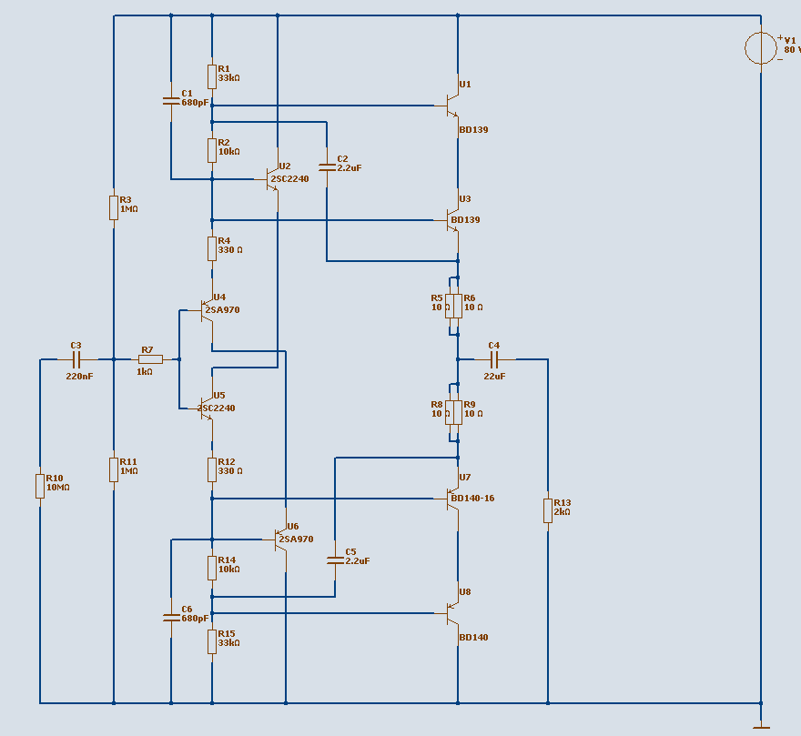

I use bootstrap sometimes. It is simple, no added transistors. And it is good!
Here is my latest circuit SCHEMATIC suggested, where I use BOOTSTRAP instead of active bias:
Improved Diamond Buffer Design
http://www.diyaudio.com/forums/showthread.php?postid=1660361#post1660361
As can be seen in my attachment: C2, C5 = bootstrap

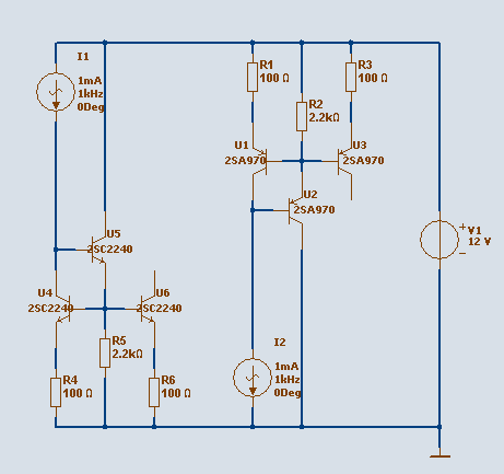

Hello stinius.
I can only give my conclusion, after testing 4-5 different mirrors in simulation.
That mirror in my attachment should be great.
The good thing is, it only needs 3 Transistors.
For DC precision current there are more complex mirrors.
This one is for audio signals = AC Current
I have drawn one for positive and one version for negative.
The exact value of resistors for absolute optimal performance will be dependent on the actual current level and the circuit.
I do not know if there is some rule of the thumb for deciding on the resistor values.
For smaller currents like 0.5-2 mA, 2k2 will be alright for R2 and R5, I think.
One can try with values between 1k5-4k7.
For those emitter resistors 100-330 Ohm will will work very well.
100 Ohm is never wrong.

I think I stuck my foot in "poop"... I have CM problems .
When I use one in a VAS it becomes non-linear unless I raise
the idle current to 15-18ma on a mje350/340 "symasym" type
topology. I simmed both my new one and the symasym to
see where I might of messed up.
One good thing , all this frustration has allowed me to
optimize my first amp, even acheiving near perfect balance
in its CM (.01mA).
I have all the materials to start my mirrored VAS amp,
but I'm scared to commit as long as these problems still
exist.
