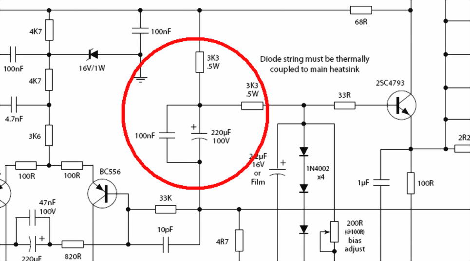

I guess I've beaten this to death in the real world, even going to
the trouble of soldering a switch across the diode/helper.
My conclusion is the same as gaetan8888 , all 3 interact
with each other (VAS,CM,LTP) after all this adjusting, trimming
,compensating ...I'm steering toward fixing the cause of this
balance problem.. the VAS.
Using a balanced differential EF'd VAS seems to be the route,
maybe even still using a CM to help with beta mismatch
in the LTP. Mr. Chau at Ampslab and his customers
seem to really like this topology.
The little 2 cent diode that started this thread is my choice
both for its utter simplicity and its subtle effect, the 3T CM is
too bright (after listening for a couple days).I'm sure I could of
spent more time to implement it correctly, but I'd rather
build something that directly addresses the issue instead of
compensating for it.

You who use and prefer current mirrors, how would you describe the sonic improvents vs. using resistors? Or were your choice using CM other than improving the sound like lower offset, better measured performance or higher CLG?
Improving speed (SR) in power amp, double current for C dom loading.
I have used a switch....using a mirror and a bootstrapp
absolutelly same currents.... switching from one to the other i felt bootstrapp better.
Then i have asked friends to evaluate...i have operated switch informing them "this is A".... and "This is B"....... bootstrapp was the winner once again.
Test repeated having the maid, my wife and my daugther...result was the same.
Test repeated with 5 girls and boys..all teenagers... result was the same.
SO... in my mind no more doubts...bootstrapp sounds better for humans from Brazil (if you imagine there are different humans elsewere)
More treble to the mirror..strange and deeper, more detailed, more focused into sound stage..but fake and strange....more nice sonics and deeper bass to the bootstrapp..also the amplifier distorts different when enter the clipping.... in my imagination may measure better the mirrored.... but i am not a scope, nor waveform monitor and no distortion analiser..so i do not care if measure perfect or not.
I remember perfectly... no one voted for the mirrored one!
No!... i have not inverted my switch...maybe..why not?... the ones loves mirrors will blame my switch...so... i am offering this to them in advance.

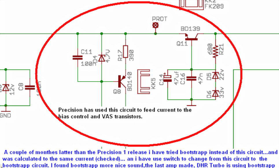

Re: I have used a switch....using a mirror and a bootstrapp
Carlos,
Where did you put your mirror/bootstrap (as load for VAS ?) and what type of mirror did you use?
It is a well known fact that a CM perform not so well when is used as a CCS, in comparation with a BJT+LED CCS.

Yes... i was talking about VAS mirrored in the place to use a bootstrapp there
regards,
Of course we can produce this mirror using a CCS... the circuit is not active...just produces current to the VAS and share voltages.
This BD139 you see..it has a resistance that is going to the negative rail (10K)
Precision I have used this circuit instead of a bootstrapp.
Carlos

Re: Yes... i was talking about VAS mirrored in the place to use a bootstrapp there
So, you did't use a current mirror as a current source to load the VAS?
The CCS used in your experiment has very low BW ...
Why then you conclude that CM has sound bad?

I have made more amplifiers Roender..and many of them used CCS
They sound bad.
Worse than bootstrapp.
May measure better...i do not care how they measure... this is conversation between enginneers...i am a DIY, an audiophile.
You do not need to agree or believe... test by yourself and be happy with your own results....please, never believe me or anyone...test those things by yourself.... if have tested and conclude the opposite i had into my tests made... and very well made..for sure was a biased result...test once again with other guys evaluating and do not instruct the testing.
My preference is to see people testing their ideas...you know.... those things people say, alike "I think", or "I believe" and very different from "I Know"....and this last one, only using ears, and other personnal ears... we are biased.. our judgement is not fair.... humans not fair.
I do not like to discuss or challenges... i know..you made just a simple question... was answered and i will not answer this subject anymore, neither for you or other folk... i was very clear...no reasons to answers..so, they seem the start of provocations for a discussion..not my style.
I do not ask people to do things i have not done... i use to test everything, i do not trust my own shadow projected into the ground because of ligth.... your amplifier was tested, was listened... i believe you use to test other options too.... this is logic, this is fair and this is not biased.... also pure science.
