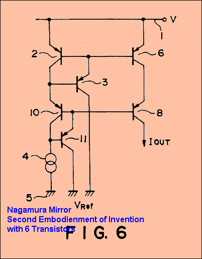

Nagamura looks very promising, jam.
Why?
Because both 'mirror-transistors' Q2-Q6 has got 2xVbe across CE.
this makes it like 1.2-1.3 Vce.
And no matter what the output point voltage, this stays the same.
Here is the test I am going to do.
I will use same 1 mA, modulated +-100uA 10000 Hertz test, as with 'Glen' and 'Jam' mirrors.
See my test setup Post #152
http://www.diyaudio.com/forums/showthread.php?postid=1659653#post1659653
But as Nagamura needs more than 1.3Volt output I will set the output voltage ar 2.0 Volt
I will retest and compare with my 10 kHz signal, using my usual 15 harmonics Fourier.
Be back with my Glen/Jam/Nagamura results soon.

The Nagamura current mirror is also attractive because it provides a built-in way of biasing the output cascode without incurring the problem of the nonlinear collector-base capacitance feeding its current back to the input side of the current mirror. Secondly, the currents on both sides pass through a cascode transistor, so both currents suffer the same alpha loss if the transistors are matched in beta.
Notice, however, that both of the "helper" transistors should have some current pulled from their emitters for best performance (rather than relying solely on the base current of the transistors they are driving). This is especially true of the lower helper transistor, as it is exposed to output cascode transistor base currents developed by high slew rates across the cascode's collector base capacitance.
Bob
Bob
Isn’t that so with the buffered Widlar as well? (3 transistor Widlar)
For best performance the emitter of the “helper” transistor would need some sort of current sink.
Regards
Stinius
