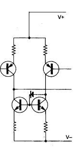

Current Mirrors. They rely on two transistors with identical Vbes and emitter degeneration, delivering an output current on one side driven from a sensing current on the other side.
However, there's a problem. The sensing side configures the transistor as a diode, but the output side configures its device as a transistor.
These two devices therefore have different transfer functions. That is, the absence of a depletion layer on the diode connected side means that the output current will not precisely track because the Vbe's differ with current.
How to fix this?
Instead of running a simple link from collector to conjoined bases, connect the collector on the sensing side with a forward biased diode to the two bases. Bases remain joined, as before.
This way both transistors are operating with depletion layers, viz, as transistors, and the transfer functions are much closer to being identical. Thus, linearity is improved. The Widlar current mirror achieves this, but by adding another transistor. This is simpler.

It should look like that;

That diode only has potential to make the current mirror linearity worse – in fact I just proved my hunch in LTspice – at 20kHz the LTP non-linearity of a “Blameless” increased significantly (~50%).
It is sub optimal to add a diode in the signal path of a linear circuit like this such that it is forward biased with a current as low as the base currents of the current-mirror transistors.
If you want to better the current mirror by any significant amount then your options are the 4 transistor Widlar or the 3-transistor version attached below. Note the 470-ohm resistor? This ensures high frequency linearity by developing an adequate quiescent emitter current for Q16.
And no, this 470-ohm resistor is not a potential fix for the diode fudge.

By G. kleinschmidt : That diode only has potential to make the current mirror linearity worse – in fact I just proved my hunch in LTspice – at 20kHz the LTP non-linearity of a “Blameless” increased significantly (~50%).
Confirmed... But the "truth" I was mainly interested in was
the psychoacoustical one. (how will it sound??)
I guess the only way to see would be to actually add
the diode (or the widlar circuit) to the real thing, crank it
up , and let the ears have at it.
So, it comes down to linearity vs. acoustics.

WRT addition of diode, at this point I disagree Glen.
I spiced up a quick circuit and did fft on OP current linearity.
The LTP needs to be run at decent degeneration and at very
low AC current swing to clearly show the mirrors effect.
However, once the surrounding circuitry is linearised sufficiently
so it 'disappears' from the results, the diode can half the distortion
depending on operating points.
The 3 transistor version mentioned is the obvious next step to
isolate mirrors base currents and add some further improvements.

I suggest your method of simulation is suspect. This issue is with the linearity of the circuit at high frequency when the LTP is NOT operating at a "low AC current swing".
You simply cannot expect a high degree of HF linearity (working against the BJT junction capacitances) from a diode forward biased with a few tens of uA.
As for this allegedly being a “Halcro concept”; If true then all I will say is that Bruce Candy is not unknown for passing the occasional furphy in his patent applications.
And anyway the current mirror circuit which typically uses a diode in this configuration to raise the collector voltage of the “diode” BJT does so in conjunction with another diode to act as an anti-saturation clamp (see the Stocichino (spelling?) fast amp. However this is a different kettle of fish.
Glen
