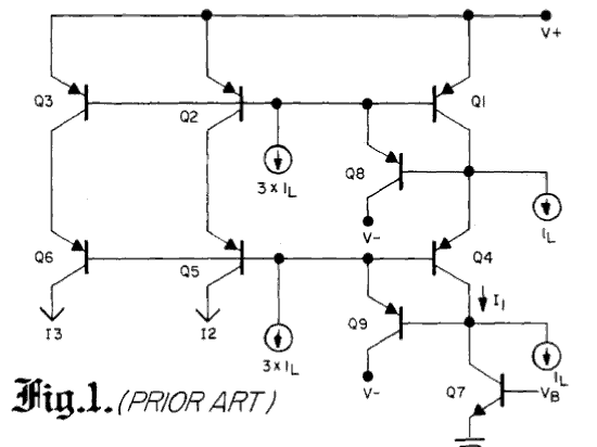

If you want to better the current mirror by any significant amount then your options are the 4 transistor Widlar or the 3-transistor version attached below. Note the 470-ohm resistor? This ensures high frequency linearity by developing an adequate quiescent emitter current for Q16.
And no, this 470-ohm resistor is not a potential fix for the diode fudge.
Glen
Hi Glen,
You are completely right. The three-transistor current mirror (the extra transistor often being called a "helper") with some pull-down current has been in very common use for many years for these very reasons.
Bob

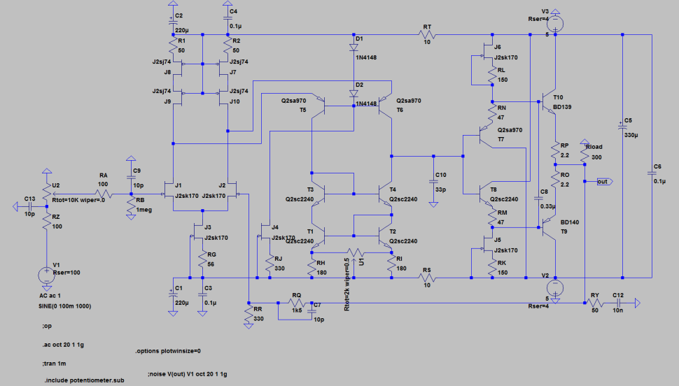

Can JFETs be used as mirrors? This circuit simulates crazy good.
Unfortunately, matching JFETs (unless you have a secret stash of 2SK389) to the same precision as bipolars is almost impossible. Linear ICs/opamps in CMOS technologies are using such (see the link I posted above), but with MOSFET devices. But, for other reasons, such opamps are usually not good enough for high end audio purposes.

BTW, you should recognise where that schematic snippet I posted came from 😀
Glen
I have just simmed some mirrors in a blameless design to look at some thd results, all results at 20Khz. With the diode I found distortion to be practically the same than a normal mirror, a very very tiny improvement. Glens circuit produced the best results. Glen s circuit also produced better results than the 4 transistor wilson so I take it it will better the 3 transistor one too. Glen s 3 transistor widlar however gave better results without the resistor to the rail, yet again the difference was very small.
Jam, Im starting to believe my preference for the cascoded circuit could be design specific, I was not aiming at THD figures and in that application it sounded better than either a std or wilson 4 transistor mirror, I should try it on another design such as a blameless and compare to other options. BTW the cascoded circuit gave the worst results in the above sims.
