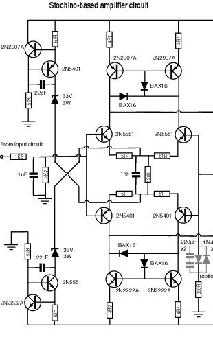

you once posted this Stochino very fast power amplifier.
Now I ask you,
what are those BAX16 diodes doing in those mirrors?
Are they there to make worse or better ....
I can not tell.
But my guess, following the discussion, they will make worse ....
Lineup 😉 Regards

And here is the mirror used in NE5534. It is one 'Glen Miller' type.
This mirror is of course close to perfect choice,
as in NE5534, when the output is at 2 x Vbe voltage.
But can of course be used with good result,
even if output is at 1 x Vbe, as in AKSA 55.
To prevent mirror transistor saturation at overload (fast recovery).what are those BAX16 diodes doing in those mirrors?
