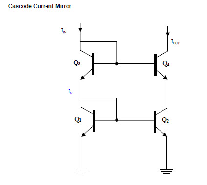

jam said:PMA,
Is that some form of cascoded Widlar mirror?
Jam
It is Camenzind. Yes, cascoded.
http://www.designinganalogchips.com/_count/countdown.pl?designinganalogchips.pdf
Enjoy.

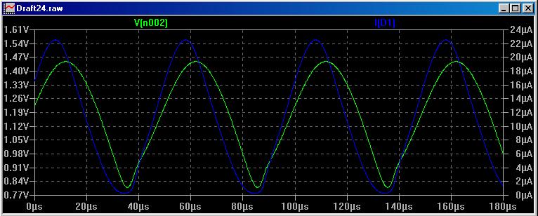

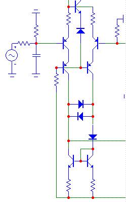

G.Kleinschmidt said:
I suggest your method of simulation is suspect. This issue is with the linearity of the circuit at high frequency when the LTP is NOT operating at a "low AC current swing".
You simply cannot expect a high degree of HF linearity (working against the BJT junction capacitances) from a diode forward biased with a few tens of uA..
Glen
I can't argue with the rationale but for small signal devices such as MPSA18 etc which are often used in mirrors, the cob amounts to about 2pf at 0.4V. At a lowly 0.01mA the dynamic resistance of a 1N914 is still no more than a few hundred ohms so it's difficult to easily see an issue here. Even at 20KHz the cob XC is about 10000 times smaller than the diode resistance.
That said I think your suggested 3 transistor + bias resistor is an excellent solution all round.
Cheers
But you haven’t detailed the issue here. The problem is the susceptibility of the diode to reverse bias due to its low quiescent current. See the attached graph. This is from a simulation of a wide bandwidth opamp (at 20kHz) with the diode modification to the current mirror.
The LTP tail current is 5mA, the blue trace is the diode current and the green trace is the resultant collector voltage of the “diode” transistor of the current mirror.
Note that the average diode current is approximately 12uA. This is because high beta transistors are used. You can see that the negative peaks of diode current drop to 0uA (the diode is reversed biased during this period).
With some experimenting I’ve found that the problem can be alleviated up to and beyond 20kHz by deliberately selecting transistors with low beta (for a higher diode bias current) combined with low Cob, but current mirrors generally perform better with low Cob devices that have high rather than low beta, making the net worth of the added diode about nill.
Glen
