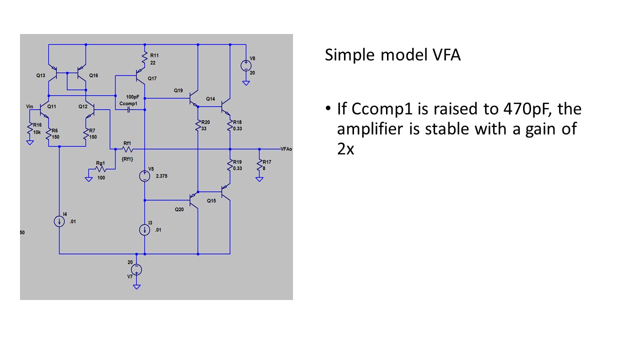

If both input ports on a VFA are hi-z, how does a low feedback ratio give it CFA COD behsviour? It doesn’t. It’s just a badly comp’d VFA.

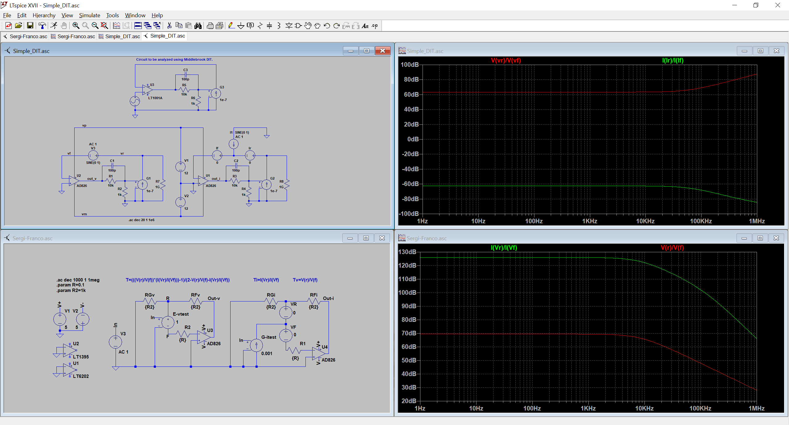

How about simply graphing the ratios of the inverting input voltages to their currents? They're identical. Enough proof?
Inverting input impedance. Great !

Let me remind you that you sent a MDIT implementation sim that didn't work at all, and you didn't know it didn't work.
Let me remind you that I corrected it by adding 1 Gohm resistors across the current sources and you have yet to reply to it.
I said step the gain - so by that I mean at say 2 or 3 dB intervals and plot them on the same graph.

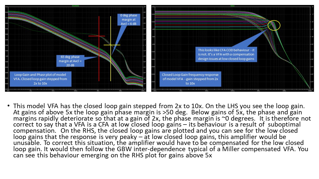

The GBW independence in CFA is small signal behaviour. But using a swuare wave to show gain peaking and response anomalies is also done in the small signal regime.
COD is large signal - agreed - but I was simply pointing out to (Herve IIRC) that low closed loop gain 'COD like' behaviour in a VFA is nothing to do with CFA COD and everything to do with a sub-optimally compensated amplifier that will oscillate.
"If you agree that CFAs are circuit topologies with series input, shunt output feedback, with some specific small and large signal properties" - yes, I agree.
However you should emphasize you can do the same with a VFA because you are talking here about the canonical feedback forms which apply to both CFA and VFA. This is a point that kicked off this whole thread because people (forr et al) confused 'current output' with 'current feedback' - and I pointed out waaay back in the forst CFA vs VFA thread that they were not the same and the canonical feedback forms make this very clear.
The CFA trick is however that its possesses COD (large signal behaviour) which a VFA in its classic guise (LTP, MC compensated, no tricks) does not.

Nope. Try to simulate in Spice the square wave response from an AC (which is linear small signal) simulation. You can only do a frequency response, but a frequency response peaking may or may not be related to a significant square wave (large signal) overshoot.
To determine the square wave response you need a Transient analysis in Spice, and that's a non linear, large signal, analysis.

It is easy to see that I(in-) = I(Rg) - I(output through Rf) . Are you among those who say that there is no current feedback because the electrons flowing through the input stage do not flow through the output stage? If so, your claim leads to the conclusion that negative current feedback is impossible, as I have made clear in prior posts. Are you willing to state this? Please see the attached which better describes this point.
In many posts to you, I have carefully written "signal current" to exclude DC bias current. In this case, I was trying to be absolutely clear about the relative directions of current flows. Are you trying to play "gotcha" here? Do you really believe for a moment that I was implying that input stage DC bias current always flows through the feedback network? Give me a break and drop it.

I take it we are talking about the same thing here . . . small signal 1 to 2 volts, large signal 70 to 80% of the full rail swing. Nothing to do with AC or transient analysis. (You can always try a Bowles stability test if you want to combine the two - quite useful.)
Fact is the square wave response of an amplifier (small signal) can tell you an enormous amount about the system's stability and/or about its frequency response - think about an RIAA amplifier for example in the latter case where you can use square wave testing to quickly and accurately test for response conformance. In a straight amplifier, for audio applications, I'd expect low/very low overshoot and flat response within the audio band.
Small signal (1~2V) frequency response of a CFA will show GBW independence wrt to gain stepping. If it shows peaking, the designer better understand why and make sure its tolerable in the application. Nothing to do with COD - Herve made that claim IIRC - and there I agree large signal transient analysis is what is required.

As I said, for the purpose of a small signal analysis, the input signal level is irrelevant, specifying it ("1~2V") confuses me.
Perhaps what you want to infer is that a large signal analysis (using non linear model), with a input signal level -> 0, should converge to the small signal analysis.
BTW, "1~2V" is a pretty large signal for "small signal". The convention is to use signals that are <<kT/q at every node of the circuit. Could be ok in some cases, but I would not always count on that.
